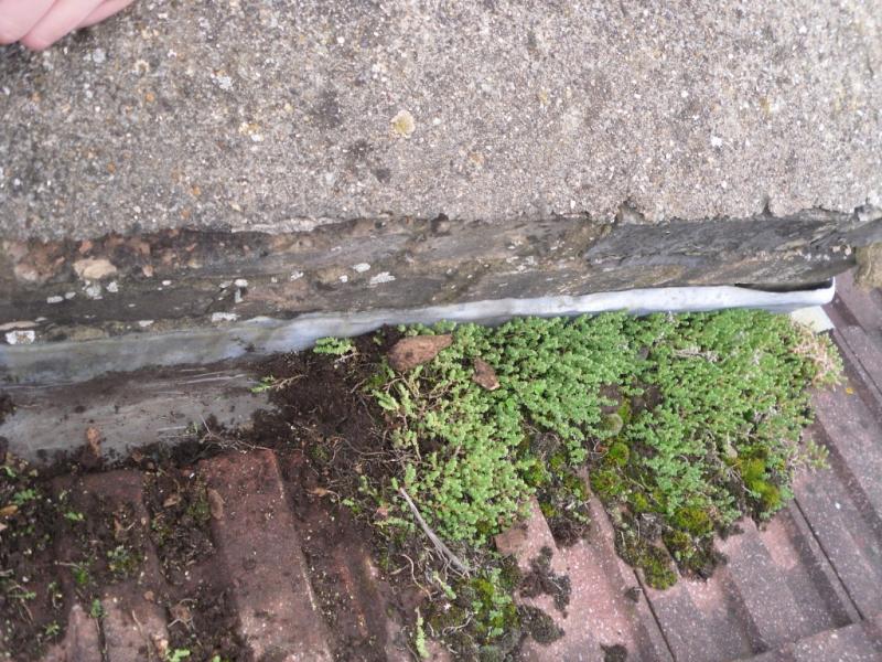

Hi,
I have noticed a small amount of damp coming through to a room I have just had skimmed (Great!). I have traced this back to the old capped chimney breast.
After taking a look it is obviously in need of a bit of attention.
1. At the back of the chimney a lot of earth and moss has collected. You can see in the picture I just scraped half of this away. Do I just need to clear it all or is there anything that need to be done to prevent it building up?
2. With all the blown bricks and pointing can this be solved by just repointing and almost rending off the affected bricks? Can I just use a bag of ready mixed cement for this?

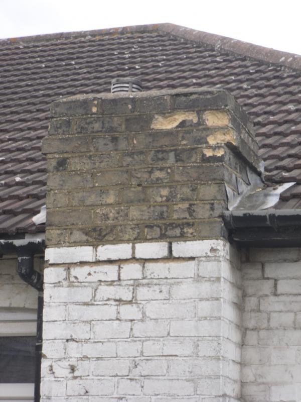

I would remove the chimney head to below the soffit and install a twinwall flue through the roof for your gas appliance.

Alastair is spot on IMHO. Drop the stack to below the roof line and make good. People on here can show you how.
Dont attempt a quick/cheap solution that will come back and back.
The flashing is incorrectly detailed it's going to rip, sod's law, quite soon. The back gutter is inadequate and has in effect become a secret gutter.

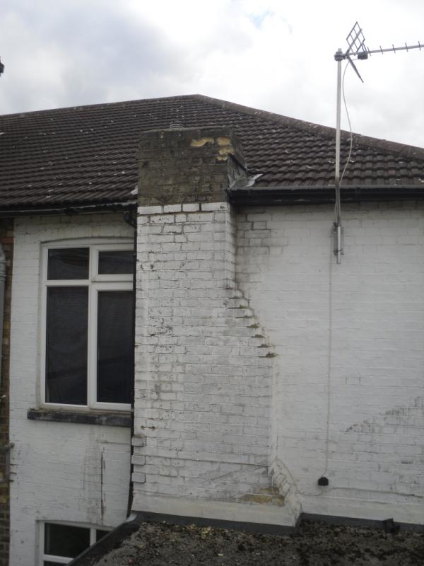

The flat roof isn't looking too clever so be careful working from it.

all the better! drop the stack below the roofline, install a couple of brick vents, seal off the flues with a couple of cut slabs.
then fill in the roof.
its for the best in the long term. an unused stack acts like a giant sponge.
the 2nd flue has no ventilation either! unless the top course of the bridge has been removed.
make sure the redundant fireplaces are vented as well.

MNB - You have worried me about the flat roof, what looks wrong with it? (it looks quite new to me).

Remove the chimneyhead below the roofline/soffit.
extend the rafters and fit new facings and soffit plate.
fit new length of gutter.
felt batten and tile to complete roof.
install 2 brick vents in each of the flues which are now below roofline.
remove a couple of courses below the soffit.
cap off flues with off cuts of slabs maintaining a run off.
make sure the redundant fireplaces are vented.
cover flat roof with some ply to protect from falling debris.
scaffold should be erected.
only attempt this if you feel competent.
personally i would remove the complete chimney breast, but that's another story.
