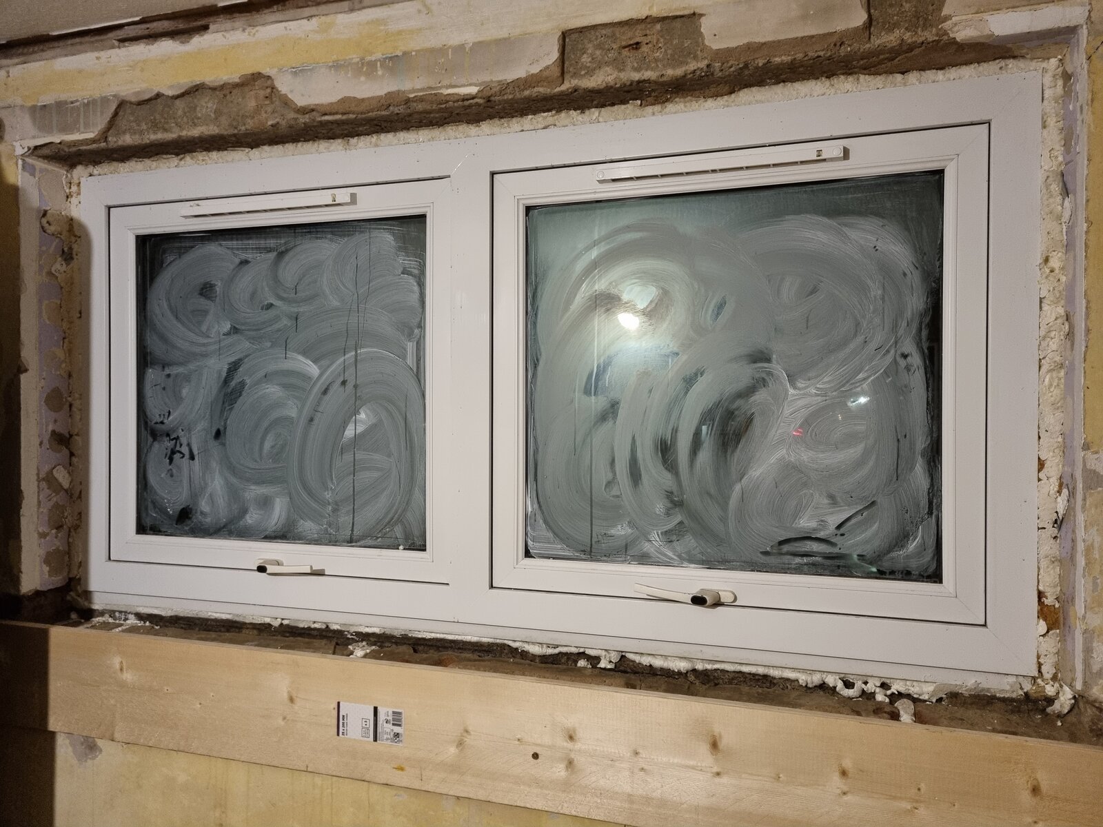

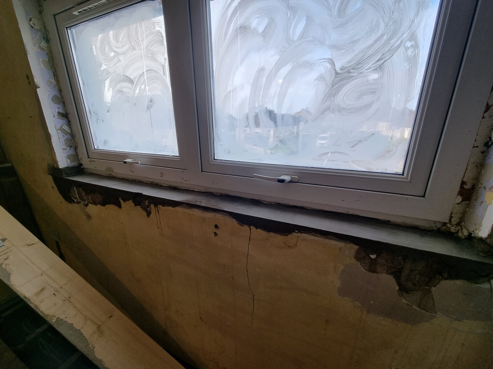

I removed the window trim and sill during decorating, we had a major draft coming through. All around the window was just gaps, no proper insulation.
So a lot of wall and sill just crumbled away.
What is best method to fix? I expanded foam around the window with low expansion foam.
Was thinking mortar to level of the sill then fit a new window sill.
Then square of the top and sides with plasterboard.
Some sort of solid groundwork which you can ideally screw through into the framing or masonry to hold the timber might be a better way to support the window board (window sills are on the outside of the building)

Has the use of expanding foam become ubiquitous in the trade?
I ask because whenever i see something like this it's invariably the first answer given to any question.
Doesn't plaster allow the wall to breathe more easily and give a better quality finish?
No, foam is a better insulator inbetween the window and the wall. Plaster is just the 'finish' used afterwards.
I insisted the ragged edge of brickwork beside the window was plastered properly rather than 'foamed' since the shower screen was to be screwed into that edge and was concerned it wouldn't take the weight: was i being picky?
The 'foam' is for insulation around windows and doors. It stops cold spots etc....
Then, the brickwork is plastered, hiding the foam. Standard practice.

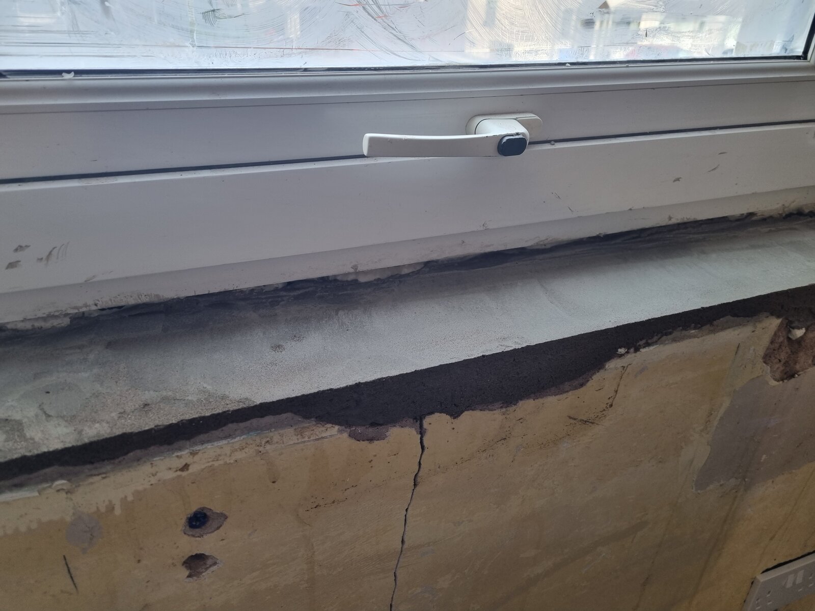

I mixed up some mortar yesterday and tried my best to make a base for a window board.
Found out the middle of the wall has a low spot, so need to get that level later.
I think it came out ok, once i bond and skim the walk hopefully it will be all come together.
