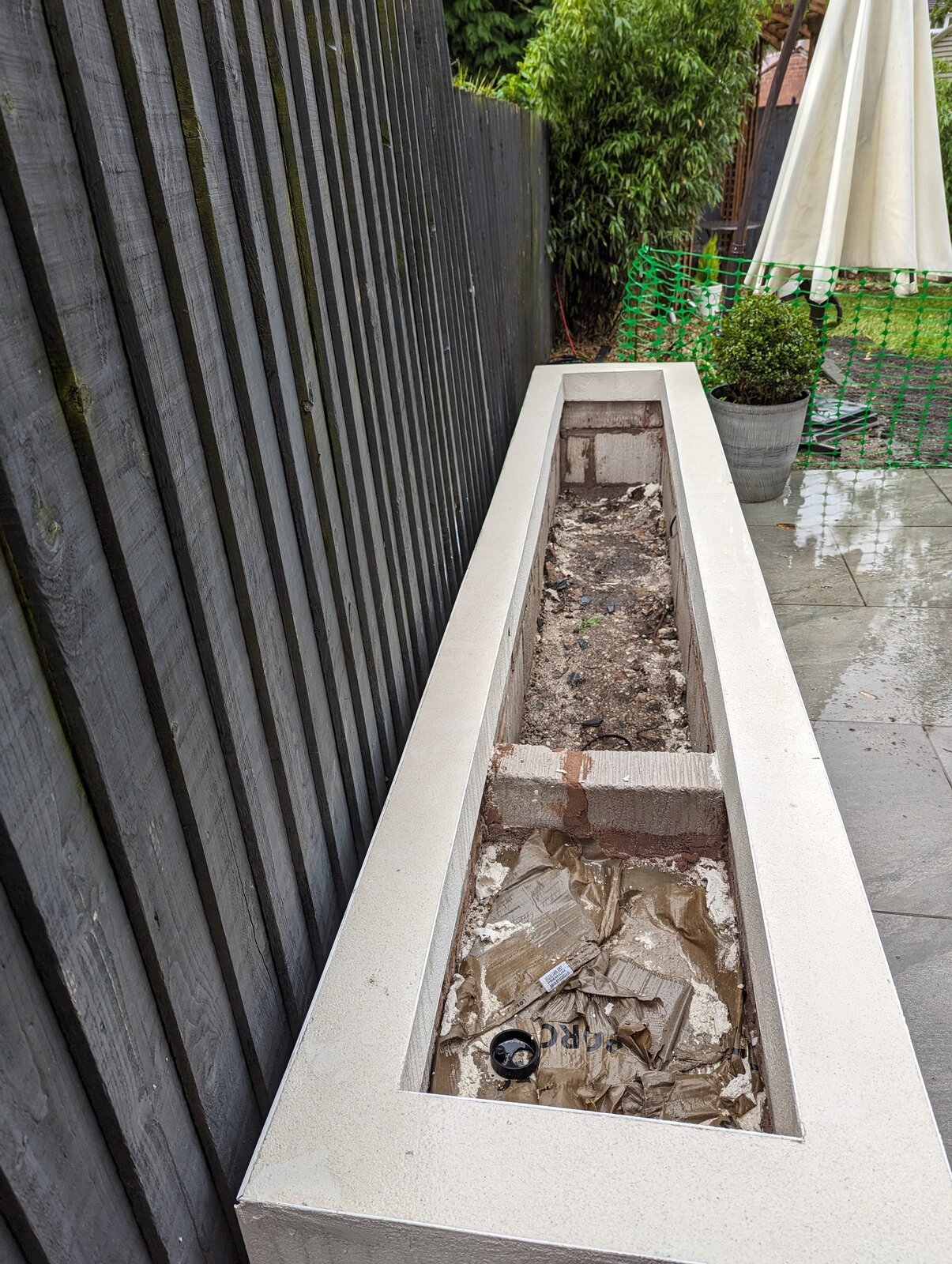

The best way to explain this is with a picture.
We have an existing fence between the neighbors. We can't take it out and get access from their side, as they have lots of stuff in the way, and it'd mean dismantling a lot of their garden. No go.
We had some builders in a while ago, and they built a wall in front of the fence, and eventually, off the top of the wall we would build a slatted fence. To cut a long story short, they messed up the plum line of the wall, as well as finishing it correctly which means we can't build the fence off the top of the wall as intended.
With this in mind, we're going to put some 25mm thick posts behind the wall and between the fence as can be seen below, and then build the fence off this, securing it properly with some 100x100 fence posts at either end.
The issue I'm having, is getting a good secure fixing of the timber to the wall. Does anyone know of best to do this, when access behind the wall is rather limited? Ideally, i'd like some sort of large, threaded plate. This way, i can drill my holes, screw the threaded plate into the back on the timber, drop it into place and then tighten it up with a threaded bar, hex bolt or similar.
The only issue is, I can't find anything like this on the market? Best thing I can find are some M12 nuts and 40mm square washers.
Any ideas?

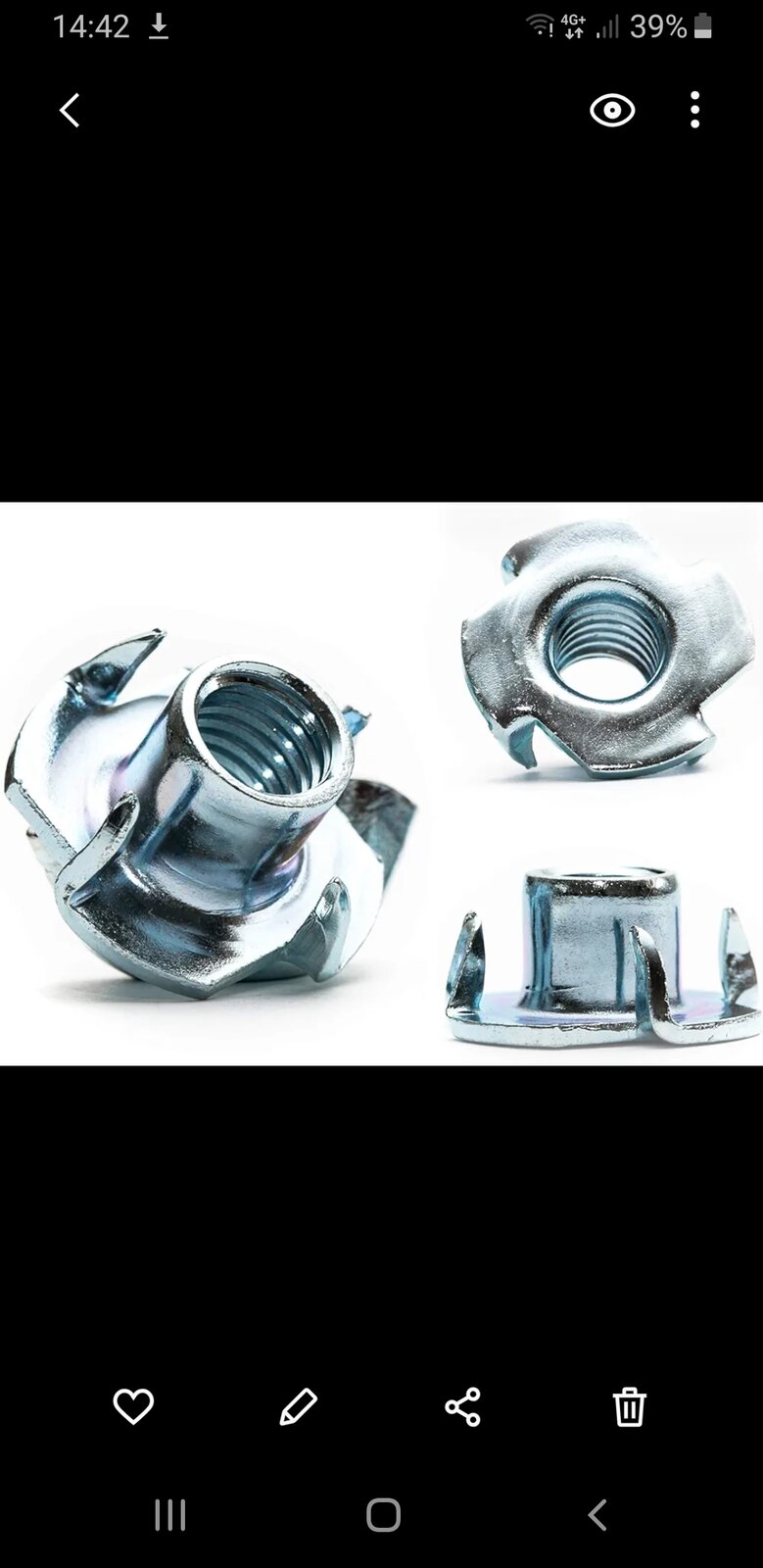

T- nuts on timber and bolt through the wall
I had considered this, but the wall is only 60cm tall and the fence post is 2m, and I can't get a hole in the ground, so the wall fixing needs to be really secure. Those T-nuts don't really spread the load enough. It's only treated pine, so they'll pull right through it
If you don't over tighten them T-nuts will not pull through a bit of 25mm timber.

I still don't know what's wrong with T nuts, isn't M12 a bit overkill?
The wall itself is 4m wide and only 60cm high, so the only concreted posts are going to be that far apart. The slatted panels are 3m wide.
The fence is 2m high, so over the span of 4m, I need something that is going to take the flex of a 1.6m fence that'll have wind blowing against it.
It's got to hold up, and a T-Nut is going to put a lot of pressure onto 1 point on a piece of timber. Something like a plate nut is going to spread that pressure across a bigger area. Still not decided what to do here, might get a piece of stainless steel bar, glue to to the timber so I can drop it in and thread it through. Will give it a bit more structure and wont let it bend as much

Let me get this straight: you want to build a fence in front of an existing fence.
And the initial idea was to build it on top of the wall, hence losing space in your garden.
Correct?

I've got actual posts getting concreted in at either end of the wall. It's a slated fence, so wind can pass through it
Or dislodge the blockwork.
I'm putting a few in to spread the weight. Shouldn't be too much of an issue

We asked them to put actual posts into the ground behind the wall when they built it, but then they took it upon themselves to decide the wall would be too far into the patio if we did that... So now, rather than having the planted 9cm further out, I'm trying to figure out a way to do it for this section retrospectively. Then when I get around to building the other planters myself, I'll put fence posts in first.
The idea is that the fence slats only start where the planter ends height-wise.
