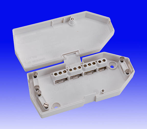

3.36 kW is all were 35 watt is a huge load, 14.6 amp, in the main we have 6 amp supplies as ceiling roses rated 6 amp, lighting junction boxes upload_2022-1-29_2-6-47.png are normally 16 amp which is the maximum for supplies to many types of bulb. (B15. B22. E14. E27 or E40)

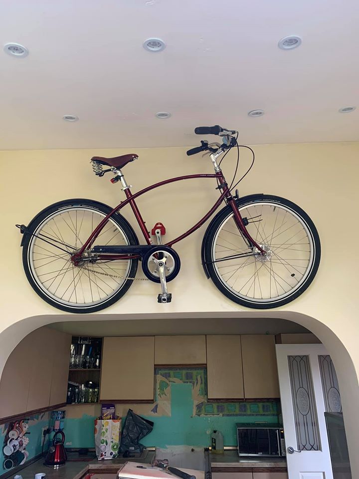

I know my son has fitted down lights, and with a high ceiling 98361719_10158572386853420_1054327038518755328_o.jpg they do work, but most houses you could not walk under a push bike just under the ceiling, and it was lit by a 22 watt LED replacement for a fluorescent tube, now 16 x 3 watt so the silly spots use double what the old tube used, and seem no brighter, plus he seems to have had a whole load fail on him, he blames buying very cheap.

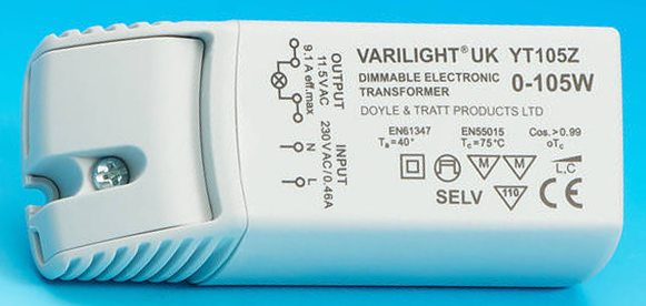

So if 35 watt then would need around 7 LED lamps grouped to same transformer to what originally fed one lamp. The problem is at kHz most electronic transformers are limited to 300 mm 12 volt leads, and state clearly for quartz halogen as once used with diodes these could become mini transmitters.
Personally I would suck it and see, and use my wave meter to look for any transmissions, and test to see if cordless phones, bluetooth or wifi seemed to be affected after fitting.
I have looked at some adverts for 0 - 105 watt electronic transformers and I see nothing warning about cable length
and the Dimensions
Length - 108mm.
Height - 33mm.
Width - 44mm.
Mean will fit through the lamp hole, looking at £10 to £14 depending on size, so actually cheaper to swap to GU10 for a single lamp.
