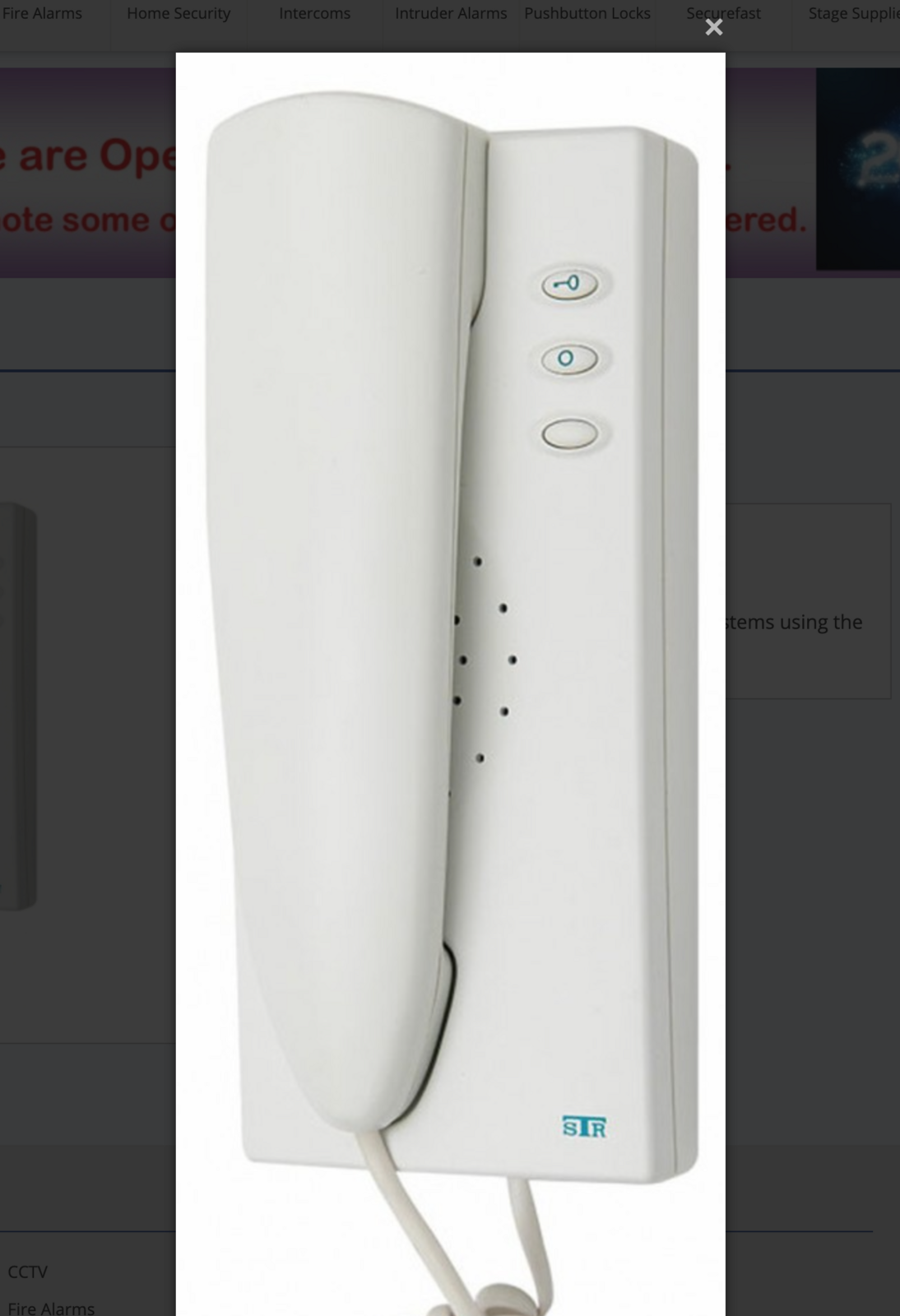

Hi
I need some help on a faulty door intercom if possible
I have an STR HT30003/2
When anyone buzzes the door there is no alarm
I've removed the back and not sure if the green wire is meant to be attached or if it's for something else that isn't required. I guess it may be for the buzzer but can't see where it should attach to or find anything online?
I am looking to replace with a universal one if possible (Fermax 3431) that does list STR on the list of compatibility but not sure if with my model
I'm guessing the fault may be at the other end though (main door).
Thanks in advance for any help

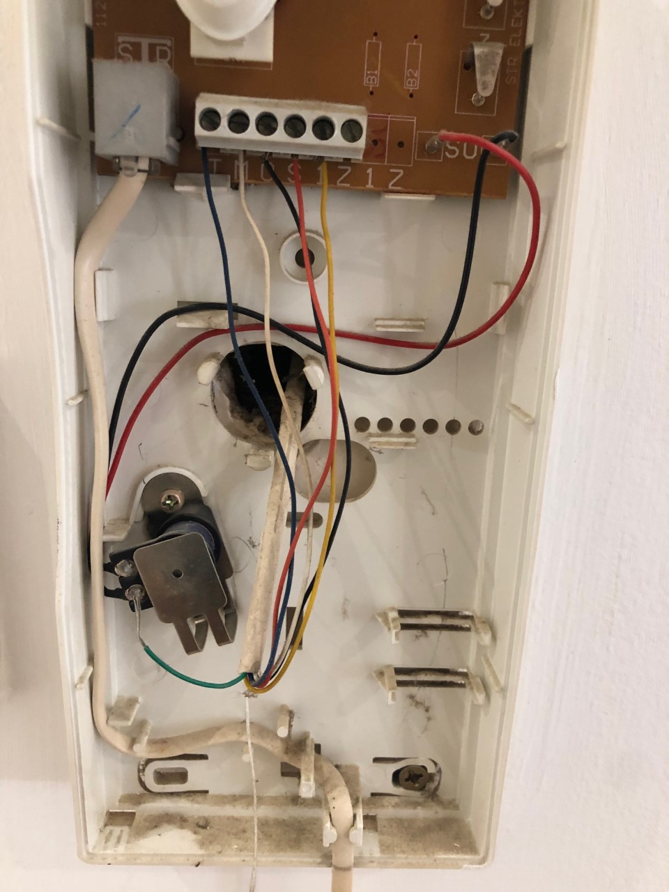

Can you post another picture of the handset with the full handset in …..it looks ok at the moment as most handsets are 4+1 systems
4 common wires plus one for the buzzer ….get someone to hold the button in downstairs while you feel the metal buzzer ( I’ve seen they stick and not buzz…

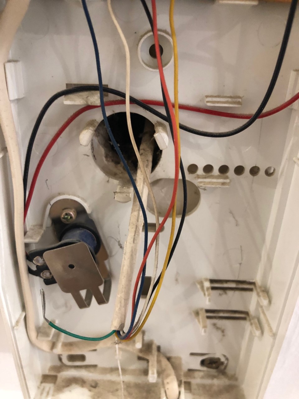

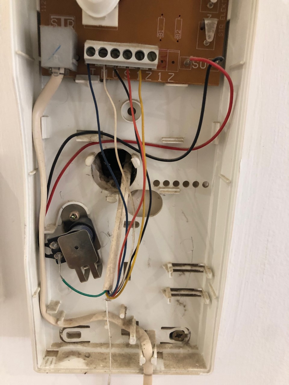

Below is another image showing the wiring. Seems I have more wires and just wondered if the green one was meant to be attached. It looks attached in the picture bit is just loose.
I'll see if It is the buzzer not working too and at least I can get a replacement it seems. I think it's almost 20 years old
Thanks for your help

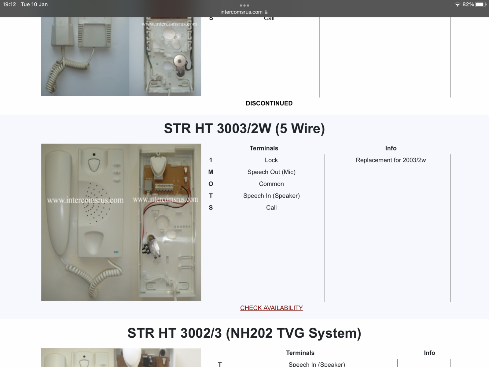

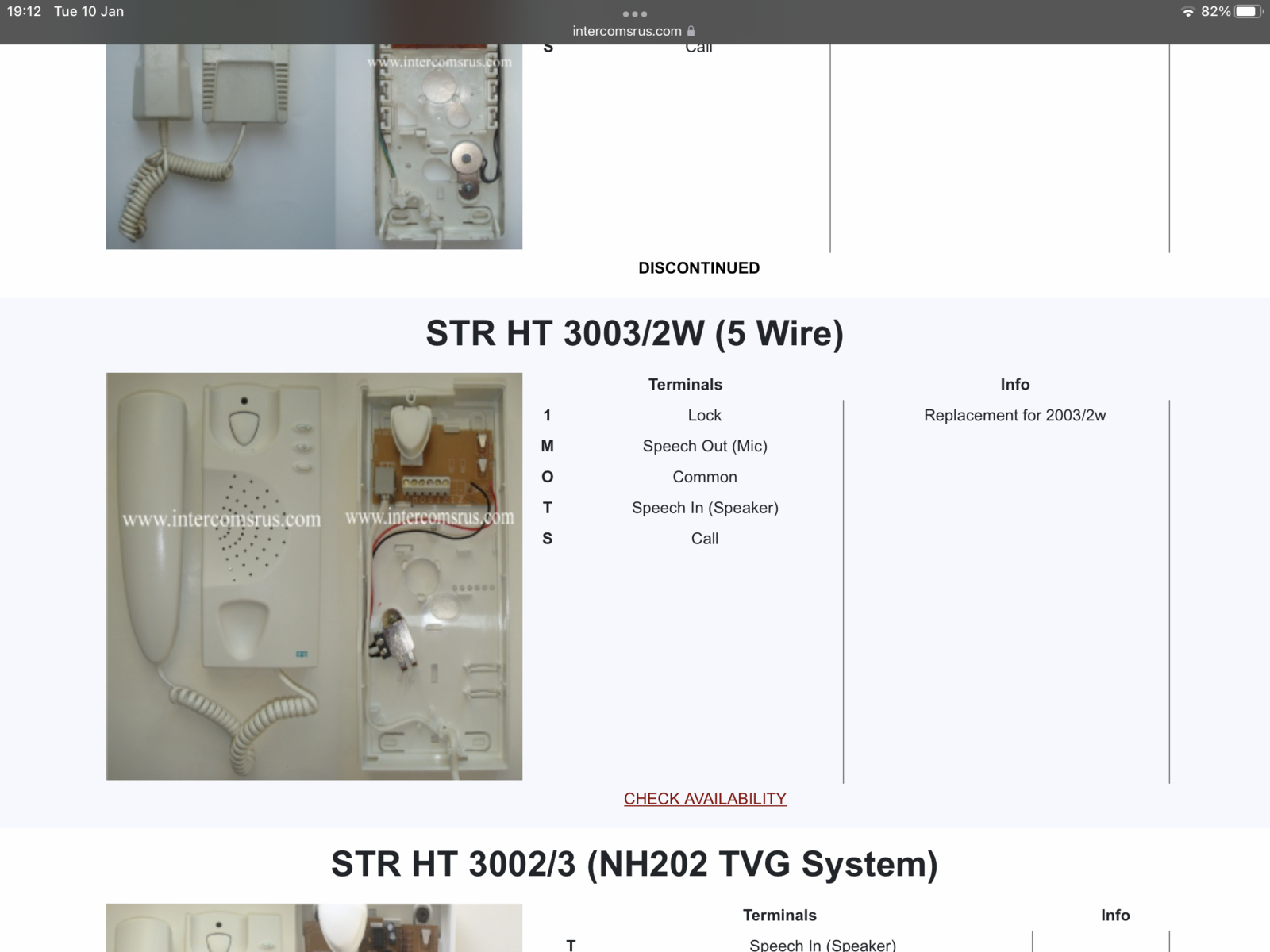

S ….Terminal the red wire is the call wire ….so no it’s probably the spare one ..post a picture of the entry panel
Thanks.
I'm there in a few days but it's just a big grid of buttons at the front door. There are about 18 flats using the entry system.
I've already bought a Fermax 3431 to replace so may just see if I can work out the wiring to replace.
