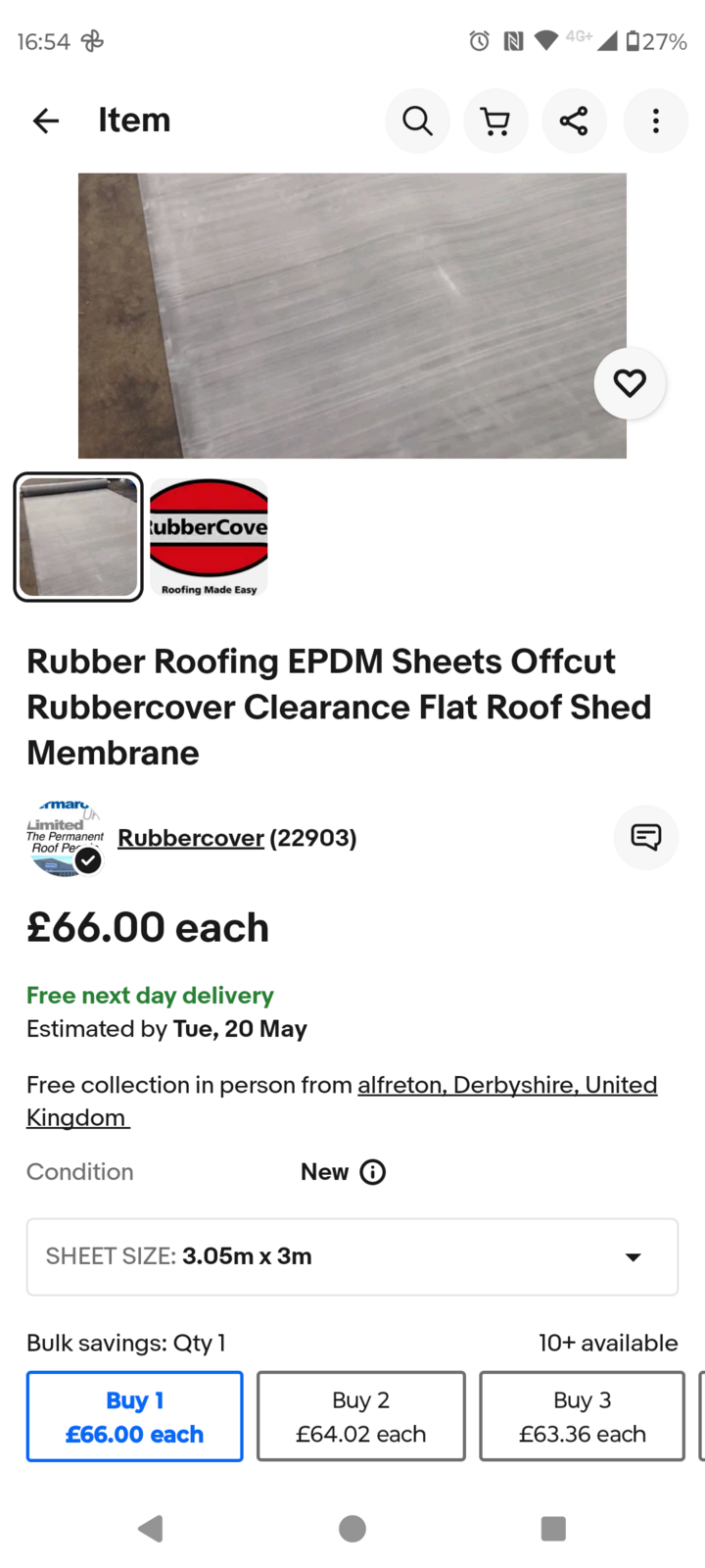

Buy a sheet of EPDM from eBay and throw it over.
Weight it down with some bricks or batten it to the walls.
