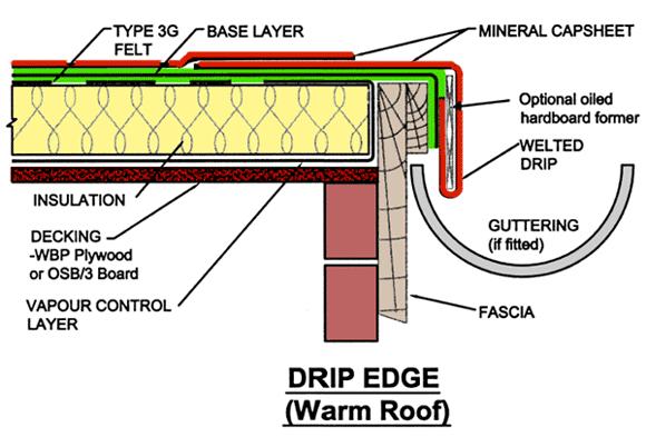

We had our loft converted and part of that was covered by a flat roof. I dont think this has been caused by the warmer weather but today i see this on the edge of the flat roof. Does anyone know what the problem is and will it effect the roof in any way? The roof has been in place since February.

That is a monster size for the edge depth (150mm ?), and is a very poor detail with no drip at all.
It's either been stretch and over-heated on application or has been subsequently heated by the sun - possibly due to its depth being too deep and this had caused the mineral surface to detach and run down.
This will get worse and spilt in the short term
I would get the contractor back to sort out a proper drip and reduce the depth of edge return
