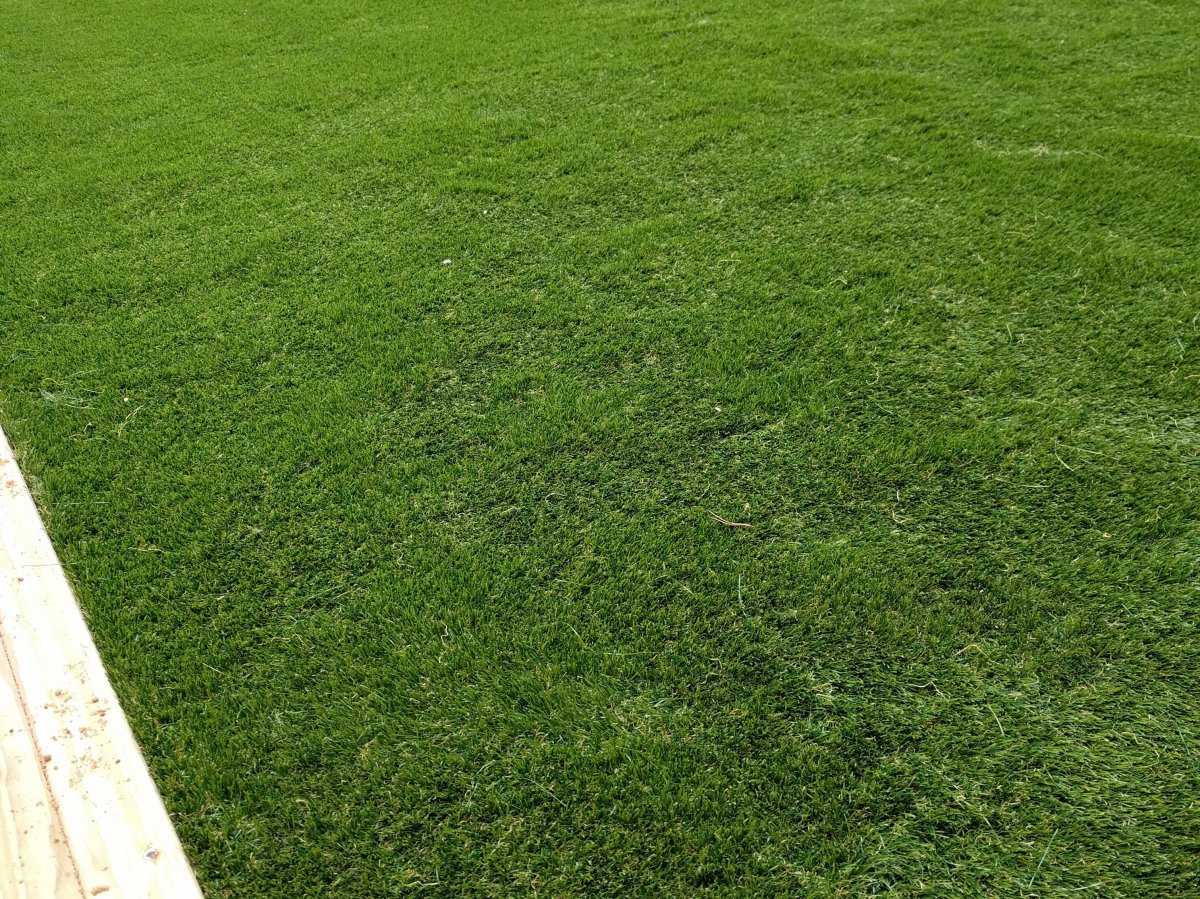

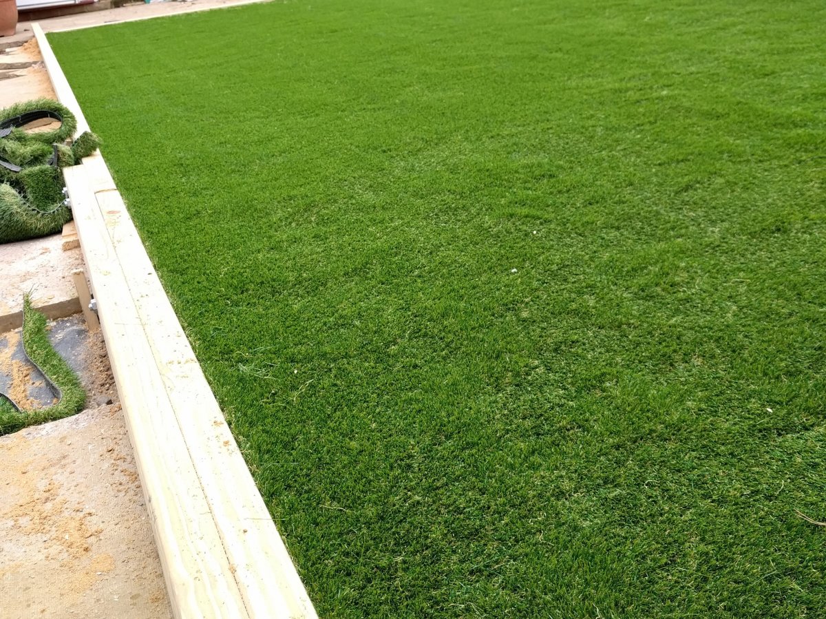

Finished laying the artificial grass, attached are a few photos. i've laid around 60-70mm of sub-base on geo-textile material. Compacted it down then 20-30mm of sharp sand also compacted down and then finally the grass on top

Looks good (y)
Which grass is it?
It's a very high density 40mm pile height grass from a company called cheapgrass.co.uk the grass model I went with is called Sydney. They advertise it at £20p/m2 but if buying large amount they give discount. They gave it to me at £17/m2 and threw in the jointing tape and adhesive too with free next day delivery.
Once you grow the weeds out and have had Green Thumb round a time or two, it'll look great.:mrgreen:
How do you stop nature wanting to do her bit with the grass? If that were say a gravel or block paved drive, you would have weeds etc growing INTO it within a few seasons? Especially the areas on the peripheries or those areas that experience the least traffic.
