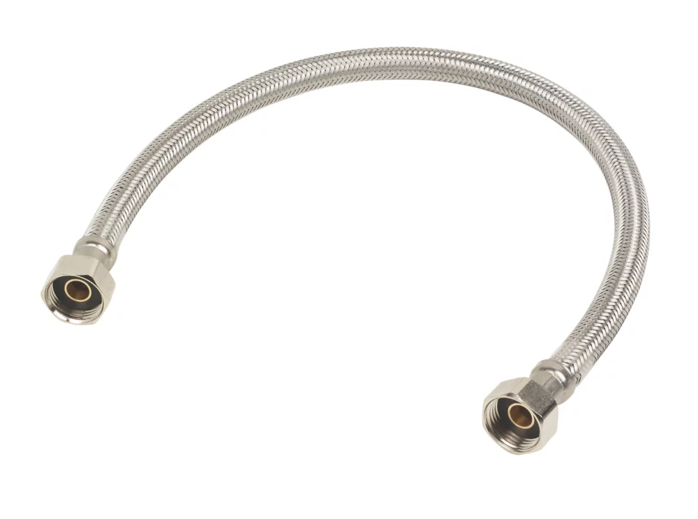

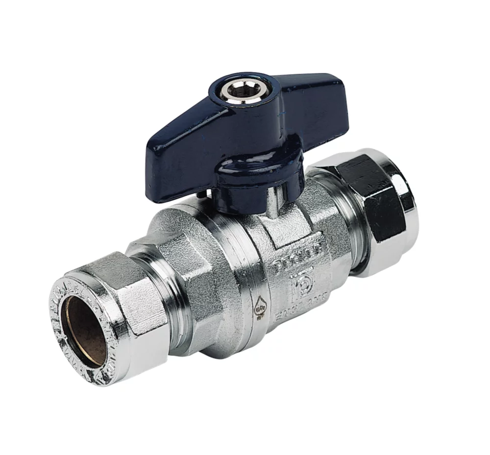

I'd also like to add an isolating valve. The one I have is a Pegler PB300T with 15mm compression fittings. I'm wondering if it's ok to remove the compression nut and olive from one side and use directly the thread.
That way I can use a single flexi hose with 1/2" BSP fitting each end to route direct from the isolating valve and across to the cistern fill. Easy peasy.

https://www.screwfix.com/p/hose-1-2-x-1-2-x-500mm/82014
https://www.screwfix.com/p/pegler-p...re-15mm-tee-ball-valve-with-blue-handle/21860

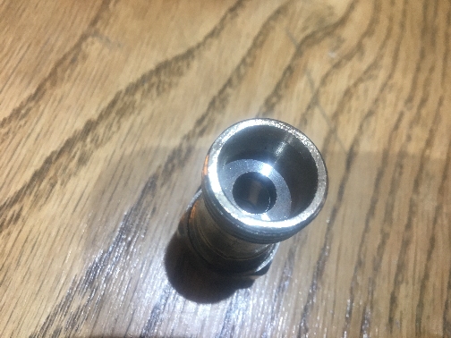

https://shorturl.at/bPQW1 Get these and tighten one in the iso valve outlet, and then screw the flexy onto that and it will seal correctly. The other end of the hose should be ok to connect to the fill valve. Be mindful of the length of length of the hose, so as not to kink it.
Take a flat file and file the sharp edge off of the ISO valve compression end, it's brass so it files easily - hold the file flat and then rub the ISO valve along the file to keep the end square - that then provides a flat surface on the valve end for the seal in the flexi to sit on without cutting into it - do it all the time with ISO valves. The other end will be fine on the fill valve.
