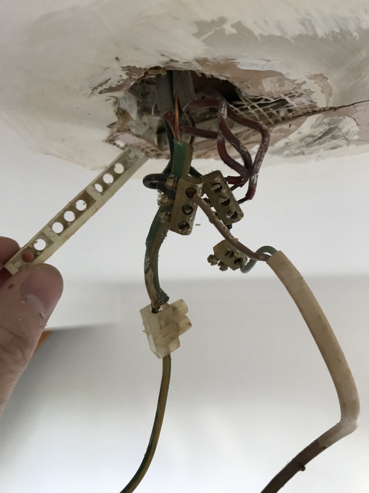

Flickering light...
25 Sep 2012
48
Derbyshire
Guess this explains why the light kept flickering. This lot was in the ceiling:
Hell yeah!!I hope the power was off when you took that photo.
But it wasn't when that lot was stuffed up into the ceiling void....:eek:
I'd guess the connectors were still in that bit of a ceiling rose until disturbed.
