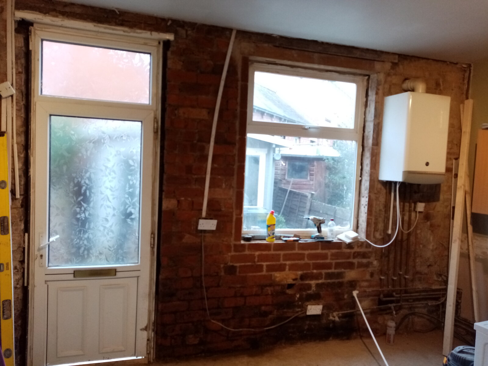

Wouldn't tanking slurry stop moisture coming through though?
My wall has one doorway, one window and a boiler next to that with pipework all over it.
Battening out isn't feasible.
I'm just going to install DPC, tank the wall (2 coats) and dot and dab insulated board.
I can't see how this is not a feasible option.

Right OK. But if I tank the whole wall and then the adhesive doesn't stick, what do I do?
This is a view of the whole wall on question:
Cool thanks.
In an ideal world I would use that instead of dabs but I have 30mm to make up on some parts of the wall, hence dabs more preferable form this point or view. Cheers.

All of the difernt options have been driving me crazy. Due to Doors, Windows and pipework all over my wal, I'm doing the folowing
1. Inject DPC.
2. Tanking slurry - 2 coats
3. Dot and dab insulated plasterboard
I'll let you know how it goes!
