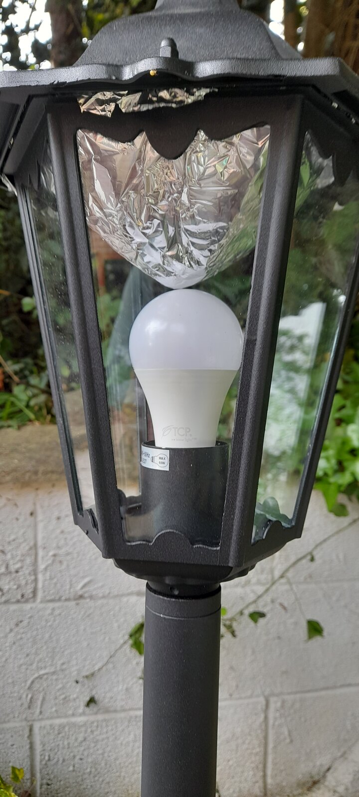

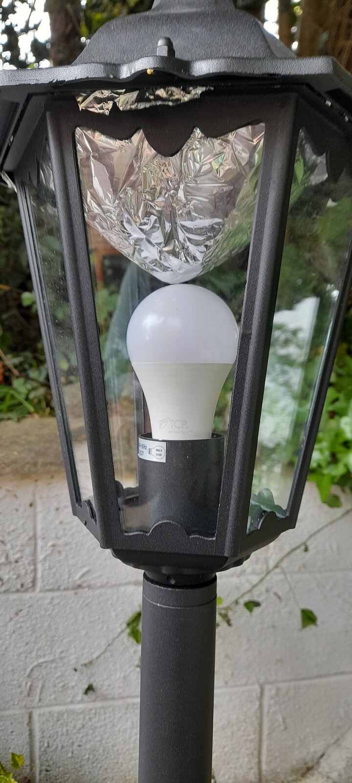

I found down to design, this 20230518_174342.jpg lamp is designed for a bulb which will shine in all directions but down past the base, but the LED is basic shining up, the defuser may help, but I tried reflective foil, I did not end up quite like shown, but the underside of the top was mat black not really the colour wanted to reflect light.
Lumen is no help, as it does not reflect the direction of the light, only the amount. The bulb really needs to be base at top.
I found over 15 watt, better to have a second lamp. There are exceptions, found a bulb with wings, which was very good, but what the lumen is seems to have no relation to how bright it seems.

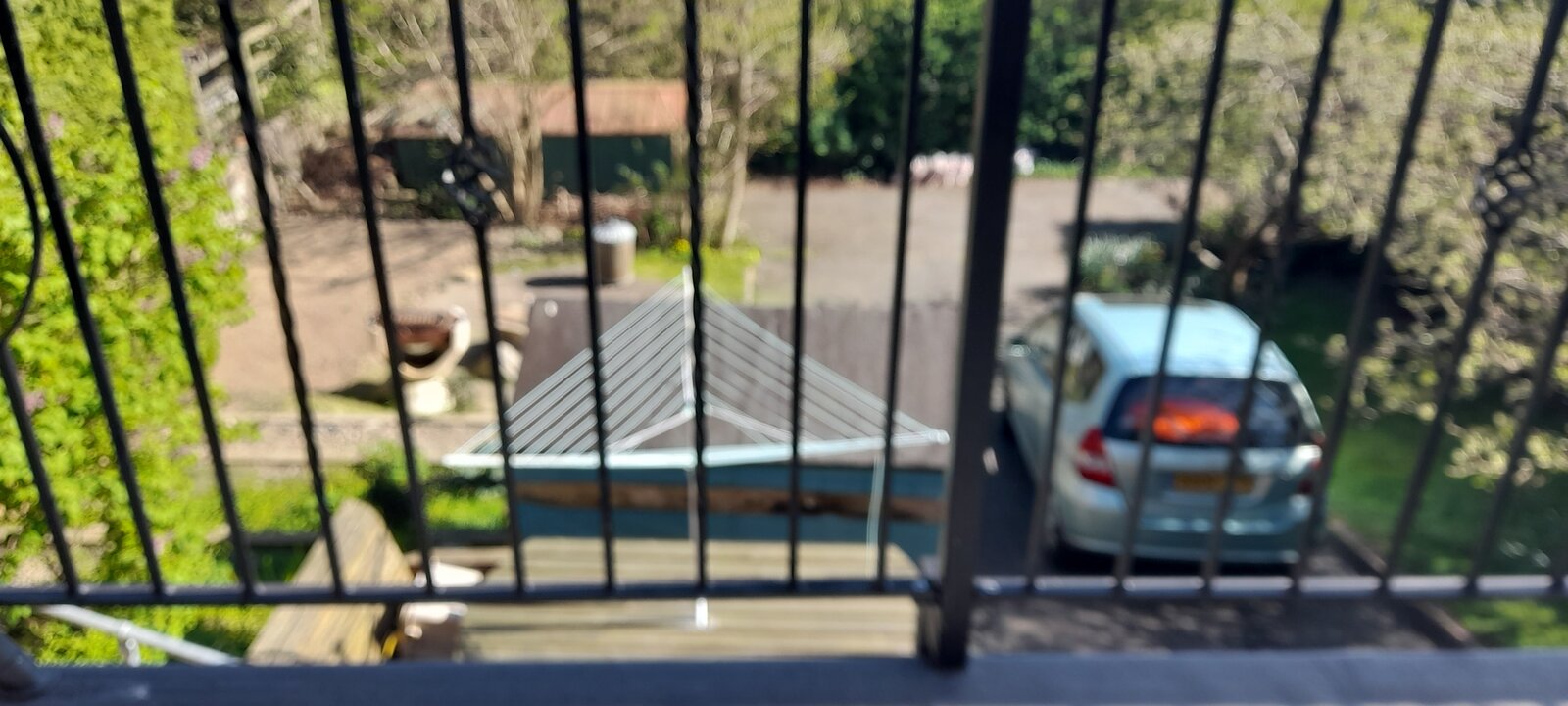

I think most of my outside lights less than 15 watts, OK there are 8 of them, 6 Wi-Fi controlled. I arrive home OK, somewhat below the main house 1744382880715.jpeg and I need to walk around the house to get to the main entrance, but light does not shine around corners, so a few outside lights are required. But I love it here, hearing the train whistle blow.
