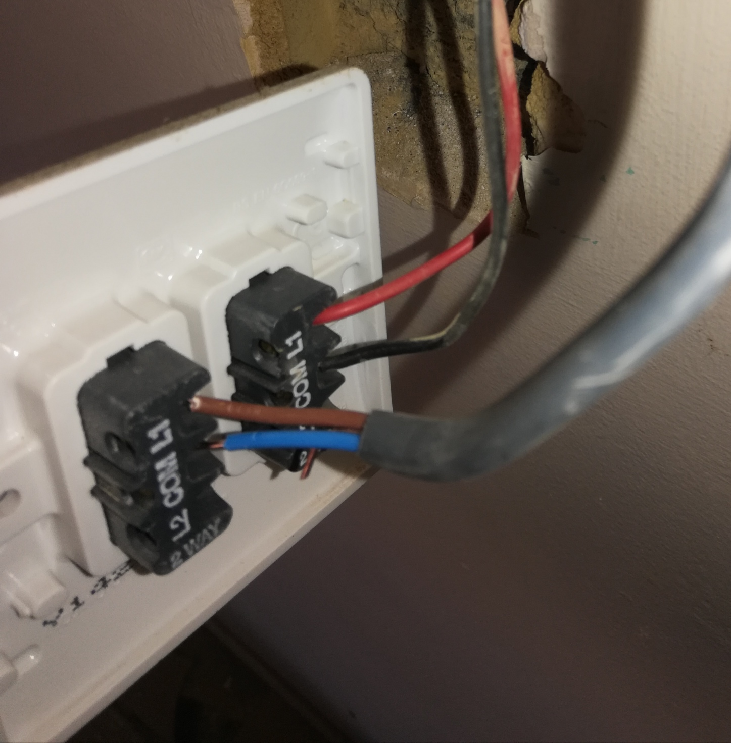

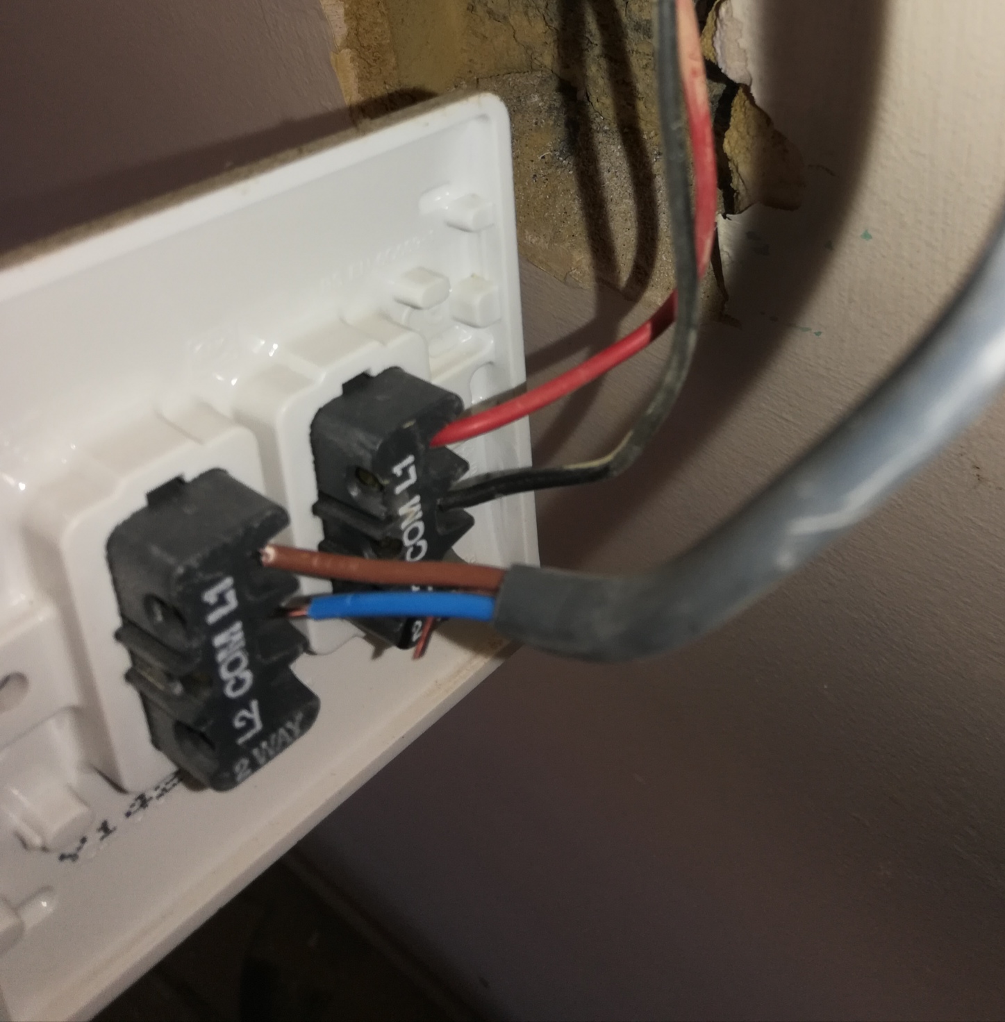

That depends on how it is wired at the moment.
Turn off the power at the fusebox(consumer unit) and open up the switch and show us some pictures.
Image of current setup
It's a two gang switch which is powering two separate lights in my kitchen
I did some of the wiring, so please don't slate it :D:D

Has the red/black cable got an earth wire in its sheath? The blue/brown cable has an earth but it does seem to be connected. It should go to the back box. I assume you did the blue/brown as that is the latest. Is the earth at the other end of the blue/brown cable connected?
As to your question, it would appear there is no neutral at these switches so you would have to do the 2nd of your options and change the switch to a 3 gang.

The red and black cable has earth however throughout the property this appears to have been deliberately snipped by the installer
All of the light fittings and switches are plastic
However some parts of the florescent light is metal and the back boxes are metal too. Do you recommend extending the earth by soldiering and terminating in the backbox?
Also i have no back box at the moment as i removed this to do a bigger chase for back box/conduit.
The earth in the blue/brown which i did will be connected to the backbox. The other end is connected to a connector strip (to. Extend wire) but the earth to. The florecent light is not connected

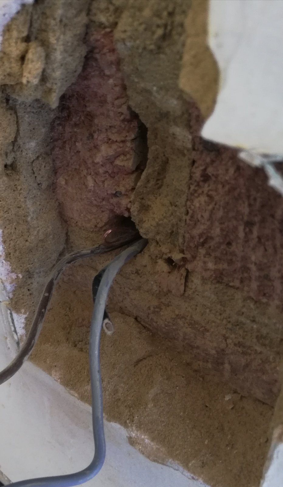

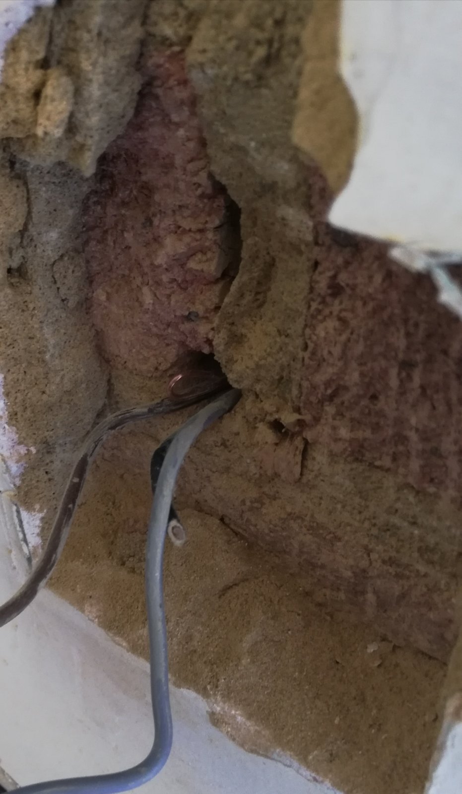

I should also point out that the property does have some wiring to an old outside light (which i want to replace)
I have uploaded an image of the wires that were feeding the original flood light. There was a swich here.
I am not familiar with the cabling but would it be possible to use this wiring and connect it to the 3 gang switch (which is on yhe other side of the room?)
There appears to be a puple, brown, black and earth cable
