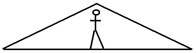

Loft height is 2.1m at its peak and roof is hip style.
So not a lot of space and I have to constantly crawl/crouch around in there.

Again I'll say it depends on your use of the loft.
Regardless of the type of lighting, getting anywhere near the eaves will create a massive shaddow., if your roof is one where it's hip all round and comes to a single point or very short ridge then a common solution was a single batten holder or rose and bulbholder and 60/100W bulb, a single flood may very well be good solution as placing lights (Any style) on the rafters will potentially mean you are looking into it (and blinded) as you move around.

A single, small, point source of light will produce very hard, and deep shadows, made worse if the source of the light is in your eyeline. Strip LED lights are much better in this respect.

I completely agree if there is a position where a striplight can be fitted out of the eyeline.
However if this is the situation where would a long tube fit?

...and if there are purlins, mounting a striplight below the purlin nicely illuminates the lower space, right into the eaves.
Then a high level light doesn't need to be as large, or as bright.

Yes correct and the purlins may very well cast a significant shadow from a central light.
