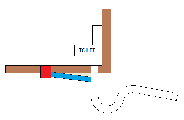

I desperately want to fit a floor drain into a downstairs toilet while renovating it. need to persuade the (new) wife that it won't take long or cost much. Hoping I can get some opinions on the best way to do it. It's a ground floor toilet on concrete slab
Currently, I think the easiest way will be to connect a new floor drain + trap combo (shown red) into the existing soil pipe.
Was planning to dig down to expose enough of the soil pipe to fit a clay to PVC adapter, then a boss to accept a 40mm pipe (blue) and bring the soil to the toilet in PVC.
Back fill hole with gravel, screed and then tile.
Where, if anywhere, might this fall foul of regs / common sense?
Cheers,
Fubar.

What about using a McAlpine WC-BP1 for the connection and I presume you will fit a waste trap under the floor.
Wouldn't that need to be fitted flush with the floor, and if so, I doubt I would get a good fall with the 40mm. Distance to drain would be about 600mm and I was going to use a combined drain and trap. Something like this:
http://www.bhs-homeimprovements.com/product/shower-gully-stainless-tiled-floor/
Though if there is a cheaper option, then awsome. Don't think I'll be able to get more than another £50-£60 budget extension for the whole job.
I might be able to tie into a grey water waste in the corner of the room, but there is a rodding point in the floor I would need to remove and replace.
Did think about the block and backup issue. It's not too bad as the toilet is the only thing on it, so should be a very immediate problem. Could always put a NRV in. I think I have one around, but it's a compression style one, can these be buried in slab?
Hepvo type might be a better option as even a conventional trap will backflow and an NRV will need a fair amount of "head" before it opens to pass flow if it's spring operated. But once it's buried, it's buried !
So, fit a hepvo instead of having a trap. Plus sorts backflow issue? Could get away with a very low profile solution then
Looking into embedding plumbing in screed. I know its a no no for supply pipes, especially with compression joints. How would the hepvo do burried? BR say anything about it?
"Where, if anywhere, might this fall foul of regs / common sense?"
Mutually exclusive terms there.
