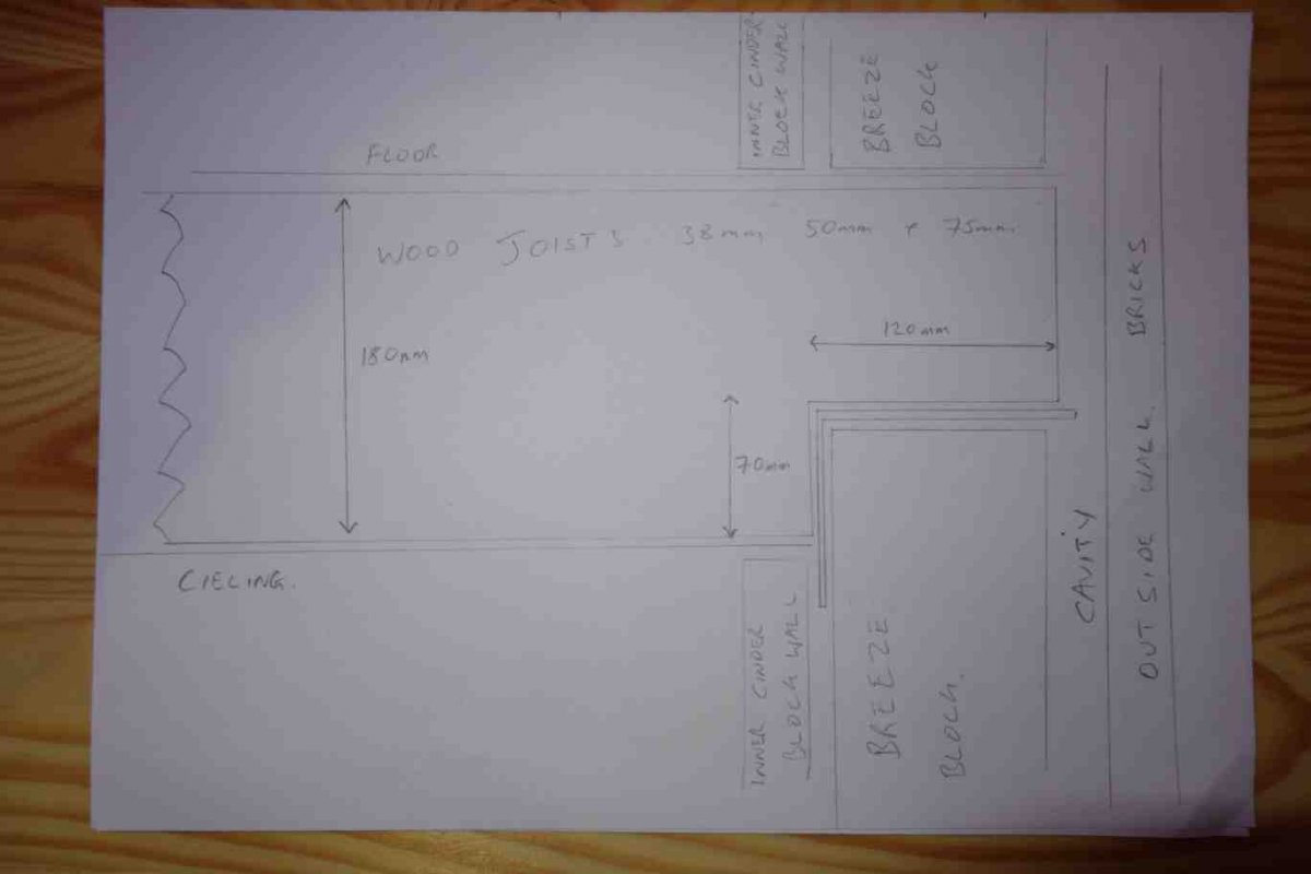

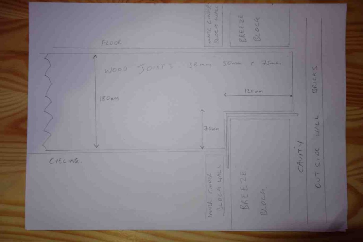

Hi Folks,
I would like to make a hole through my joist for a small pipe.
I've reviews the building regulations on the location of notches and holes, but I'm confused about how tall my joists are, so don't know where the middle of the joist is.
The sit on metal plates on top of the breeze block of the cavity wall but the bottom 7cm(out of 18cm) of the joist has been notched to fit the breeze block. All the joists are like this.
has this reduced the effective height of the joist to the top 12cm?
Is it normal to do this to joists? Is it a problem?
So where do I drill my hole, in the middle of the joist at 9cm or in the middle of top section at 6cm from the top?
I've attached a diagram and a photo of the notched ends.
The hole I need to drill, is under the bath, so I don't what to weaken the joist further if this end notching is a problem.

You're not supposed to drill holes near the end. You should notch, only between 1/4 and 2/5 of the span, and only 1/8th of the depth of the joust.
If you really want to drill through the neutral axis, you must do that in the middle 1/5 of the span.
Having said that, a significant proportion of plumbers and other tradesmen see joists as a mere obstruction rather than a structural element, and you hear more people on here worrying about excessive notching than people dropping though the floor.

So where is the neutral strain point of the joist for drilling a new hole? It seemed simple, until I noticed the end of the joist was notched at the bottom when the house was constructed. Could this end notch on the bottom have weakened the joist and changed where the neutral strain point depth is in the joist?
i.e. is the joist still effectively 18cm deep, or is the neutral strain point now in the top section of the joist?
Good grief, there's only about 2 inches of that joist left, and right on a knot too.
So, given that your house hasn't fallen down yet, and you have an apparently unused notch in your joist, why not just reuse it?
