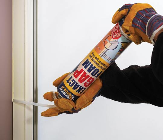

I had concrete and insulation put under my ground floor due to water rising from below early this year. The entire ground floor two rooms under floor was completely dug up and removed.
The contractor put in some kind of red crushed material, followed by thick plastic sheeting, concrete and then two types of insulation, thick blocks of something and a foam type underlay for the laminate. Following this, a new and expensive wood-type laminate floor was put over the top.
Unfortunately, the contractor failed to have the concrete reach far enough across at one end of the room. I repeatedly pointed this out but he insisted all would be well when the new skirting was put in. This was absolutely untrue. Now there are huge gaps at the junction of floor and wall, which you can put your hand in. There is also a big gap under the skirting. The draught is horrendous.
I've tried repeatedly to contact the contractor over more than six months but he ignores me. He also did not provide the 25 - year certificate he promised.
Now it looks as though I need to fix this myself. I'd appreciate any ideas or suggestions. The previous job was £11,000 so I don't have more money to throw at this. At the same time, my new fuel bills are to be more than double those of the previous year. This means that I have to do the repair myself. Five foot female, no longer young. What a joke.
I'm thinking to remove the skirting and put something in the gaps, but what? I'd rather not mess with foam, which someone suggested, and hoping for some other solution. I can mix concrete or something of that kind. Is that the best thing to do? Obviously, I can't remove the new laminate so this has to happen without damaging it. When I replace the skirting, what should I use to plug the gaps underneath?

You can stuff gaps with mineral wool insulation, as used in lofts, to block draughts. Use the brown grade treated with "Ecose" which does not shed irritant dust and fibres.
Meanwhile, try to contact CAB or similar organisation as I should think you have a legal claim against the crook.
I think that "messing with foam" may well be your best option and any other quick solution may well be inadequate.
I find that mineral wool doesn't completely stop draughts (after all there are air spaces in it) and it often won't pack into small gaps effectively, which is why we don't use it for either draught proofing or blocking narrow gaps when fire stopping (which is why on gaps less than 10mm many authorities bar its' use)
When using foam the thing is to protect anything you don't want the foam to come in contact with by using a good quality, low tack tape such as "Frog Tape" green masking tape. Low tack masking tapes minimise any damage to recent paintwork and delicate surfaces. The sort of foam to look for is the low expansion stuff we use to install internal, non-fire rated door casings and linings. It is often a gun grade foam, necessitating the purchase of a foam gun, but there are hand held foams out there such as Everbuild Exact Gap Foam (available from Toolstation, etc), which only expands 5 to 10% from the extruded bead size unlike traditional expanding foams you may have used in the past.
The trick is to clean the area of application of grease, wax or dust (vacuum), use the can upside down (as shown above), always apply sparingly and don't try to fill big gaps in one go - build up the fillng in multiple passes maybe 20 to 30 minutes or so apart to allow each layer to set.
It really is the best quick fix - just avoid the cheap, high expansion foams

If you had ever needed to do an air test on a building, John, you'd realise that stuffing mineral wool into gaps reduces draughts and air flow - it doesn't seal completely, however. For that you need something like foam or a so-called caulk saver like Fossa Caulk Saver, which is compressible closed cell foam piping available on various sizes. For smaller gaps up to about 30mm Compraband (expanding closed cell tape) which is designed to acoustically and fire seal edges of laminate flooring also performs better than mineral wool, but is relatively expensive

I don't want to 'mess with foam' as I can't do it myself. There's no way I manage to squeeze those things as well as guiding them as my hands are pretty small.
However, I do have a neighbour who does good 'handyman' work and will often work with me on DIY jobs to handle the bits I can't do.

I'm going to pull the skirting off and get my neighbour handyman to help me decide on the best solution but, at the moment, I'm thinking I need to go with the high quality gap foam but, as these are big gaps, perhaps put the Ecose first.
