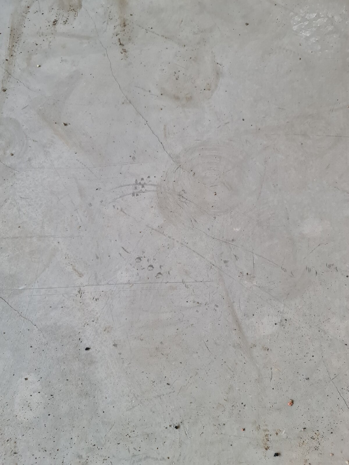

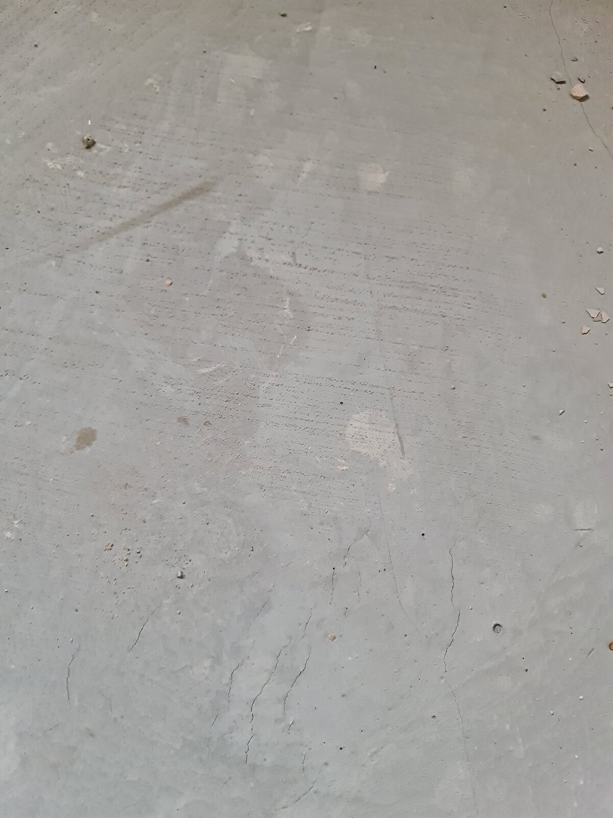

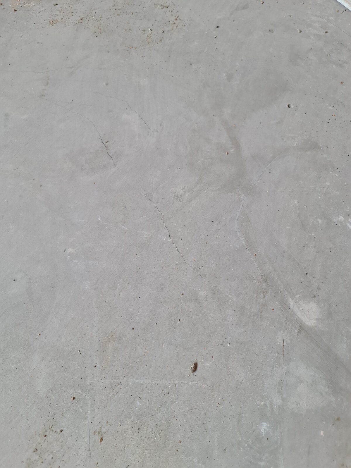

Further to the above, attaching images...

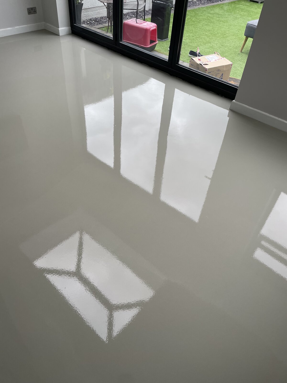

Mixed with too much water that. Should be more grey. Tap it to see if it sounds hollow. What floor covering is going down?
Plan is to tile over it, but I'm reluctant to start any of that until I know what is going on with this.
That image you attached, what leveller is that?
Ardex CL. All we use is ardex & uzin. When using a water mix you never go over the water limit as it’s makes the top surface weak and soft.
Thanks bud, and was it odorless?
I'll try a smash at this floor now to see how brittle it is, if it is.
Yes no smell. Like I said sometimes when out of date it smells or bags / bottles have been frozen Maybe.
