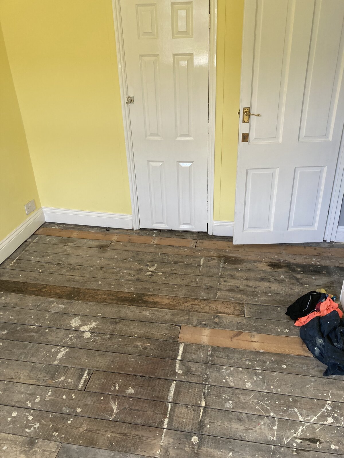

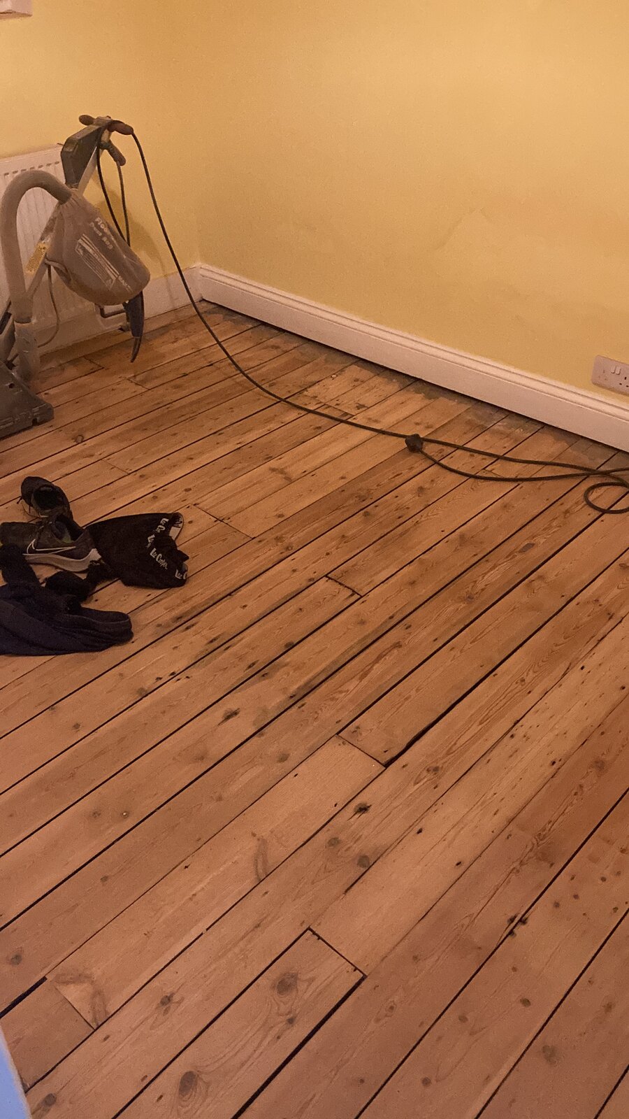

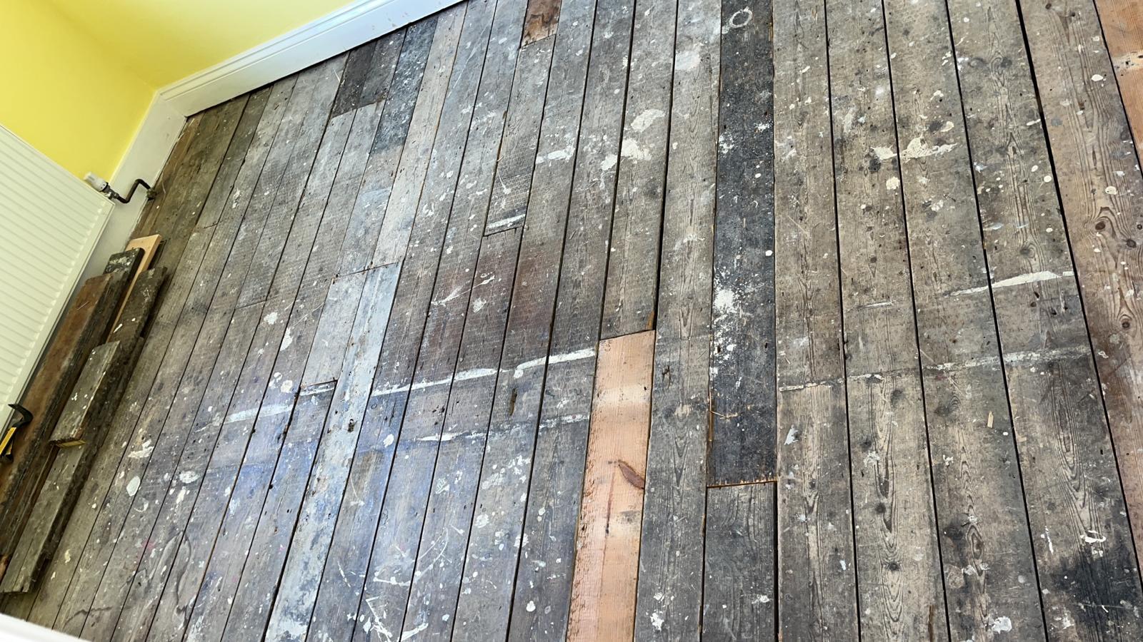

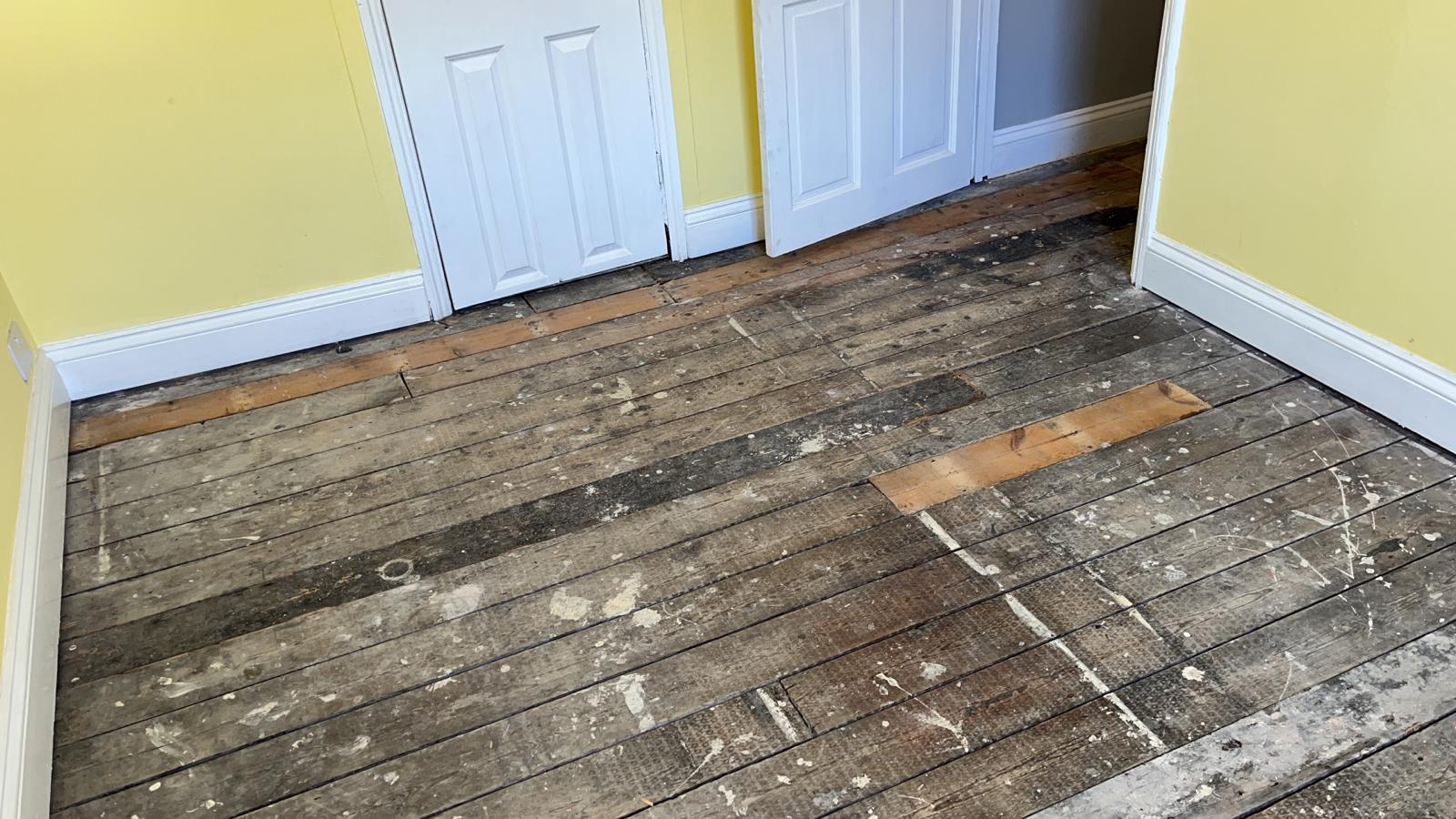

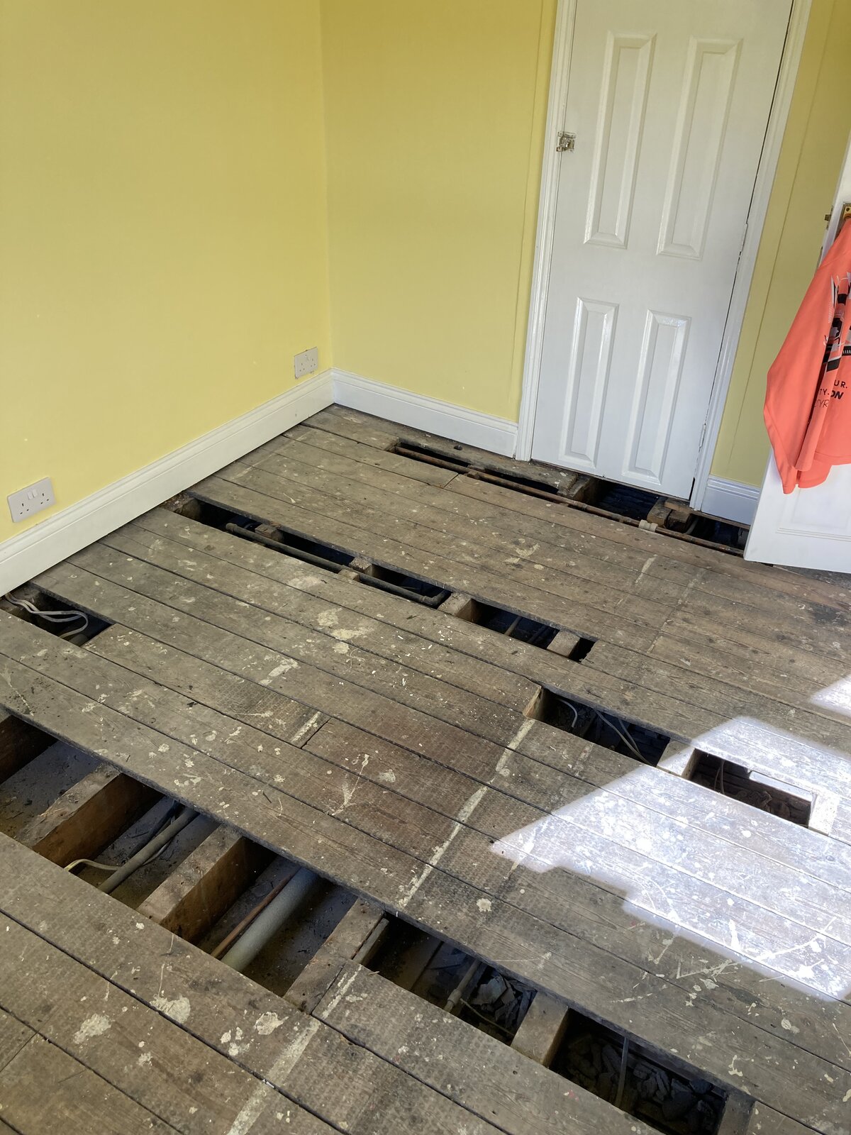

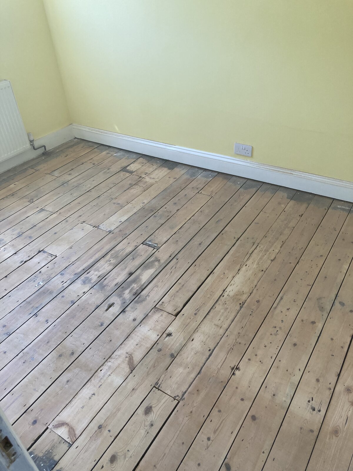

Had lots of help and advice on here with my little project so adding some pics.
Lots of learning, lots of time wasted, not finished yet but it’s been worth the effort so far, a great learning curve and will definitely be doing the main bedroom in the future.
Always liked the idea of restored floorboards and because we couldn’t do downstairs I wanted to do at least one room myself and it’s going to be our little girls room once born
Still need to do:
1 - another few runs with the 120
2 - 40, 80, 120 with the edging sander
3 - fill gaps with Draughtex and / or wood dust & PVA
4 - 2 coats of Osmo Polyx
