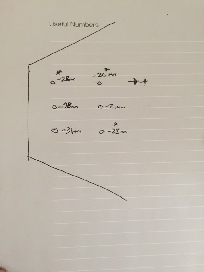

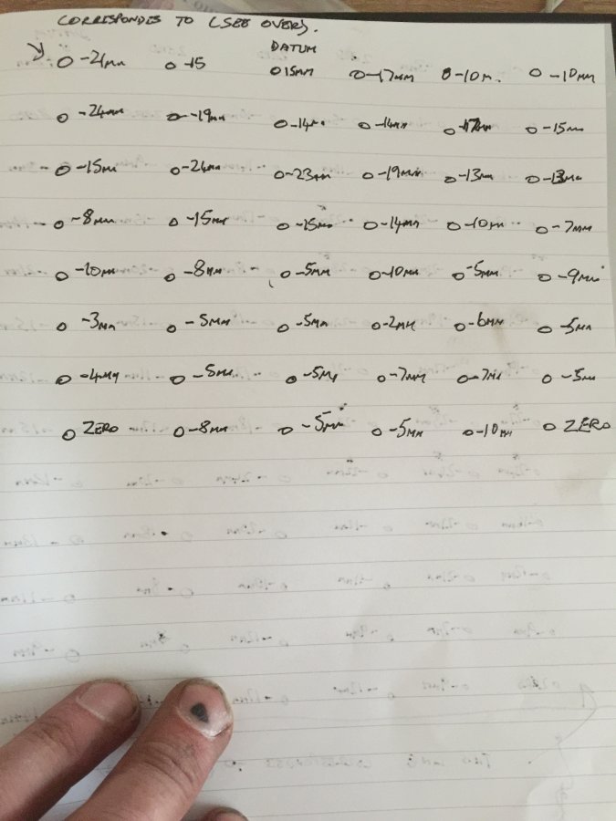

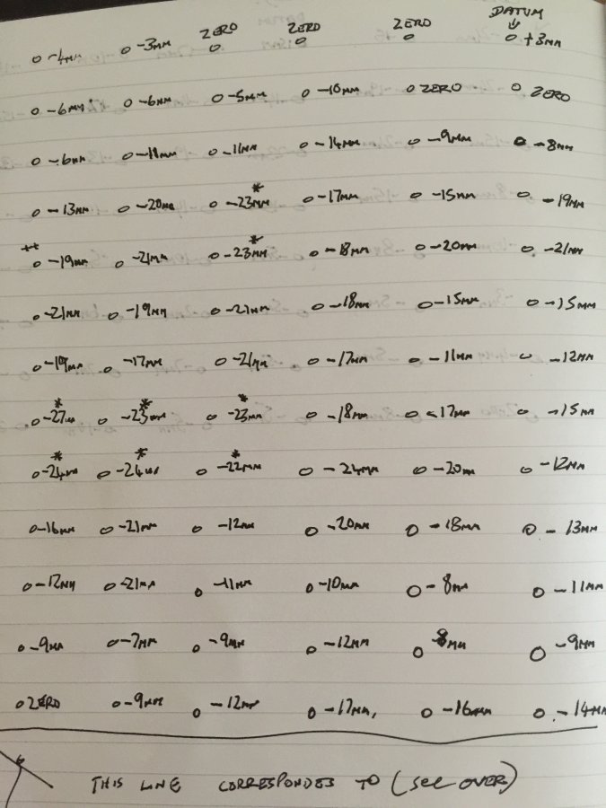

I would appreciate some comments / feedback in relation to a slab that has been poured by a subcontractor. I've prepared the area with blinding/dpm mesh & concrete mesh men. It's a pour of 130m2 and it was to big for me to do on my own.
Contractor was employed to supply men/concrete and lasers/tapping equipment.
I feel the guy has totally screwed up and left me in a bit of a hole. It is a hole I can get out of but it's just adding expense and complications to an already tough project.
Three gems of info from him on the day...
1. Mid way through he asked where my datum point was
2. He changed his estimate from +-5mm to +-5mm either side of the laser - so 10mm
3. Upon leaving he told me he's seen much worse jobs
Unfortunately I am not a 'concrete expert', so on the day, I kept out of the way and let him do his job. And only the next day could I get on and get a 'feel' for what he did.
Now, the last slab I did (and I do them rarely) it was 40m2 and I was +- 2mm and we laid a laminate floor (with 3mm foam roll) straight ontop.
I've surveyed the floor with 120 odd points and at worst he's -34mm off what is the highest point on the slab.
My problem is we need to put stud work on this. The floor is also taking 75mm insulation, UFH & then a 50mm poured screed and it's just going to be a pain to work with. It's all solvable, it just time, money and head work.
at +-5mm the above work is totally viable.
I've attached the readings I've taken from the floor.

The area is being split into smaller areas. After this is done, I will then mark out low/high points and use a runny mix of self level to take out the worst. This will allow no hollows to be under where the PIR goes, so when the 50mm screed goes down it should sort out the problems.
Their is always a way to solve problems. I just didn't want them in the first place. I should have gone with my gut on this crew.
The last slab I did was 7.5m x 4.8m. I was +- 2mm, but I did take my time. You can now see why I was so annoyed with these guys.
