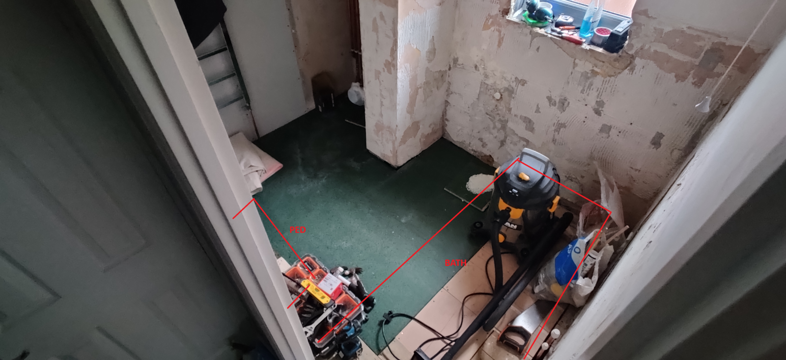

Why not post pics showing the bathroom floor - & the soil pipe you've referred to?
Presumably, you will also have a shower tray, and a Ped or vanity basin?
A rad or UFH?
@ree indeed that would be helpful.

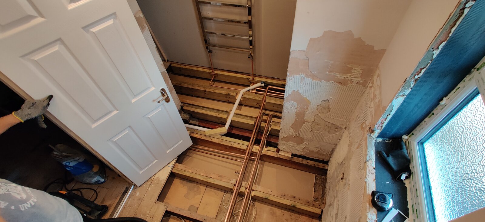

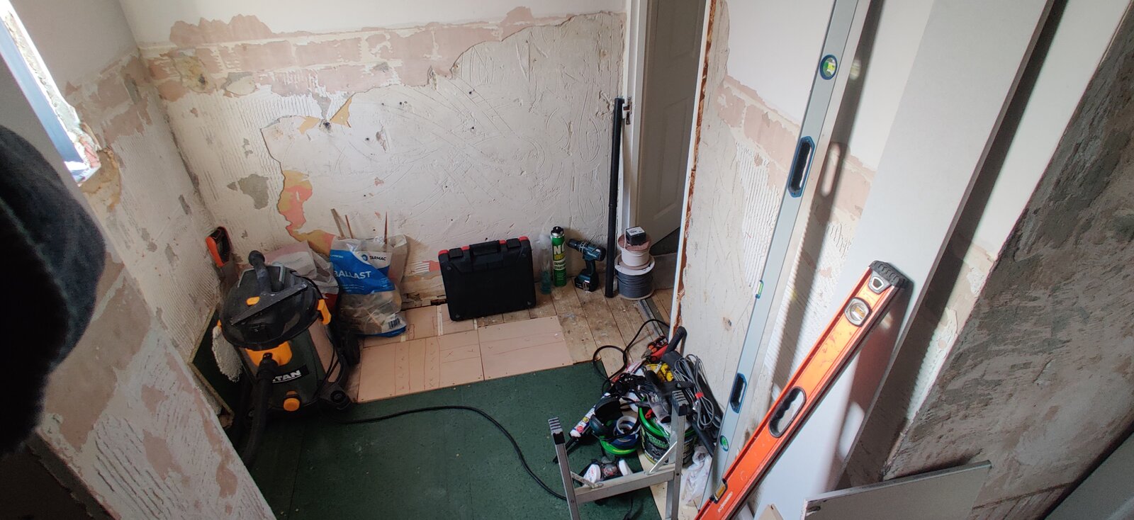

So.

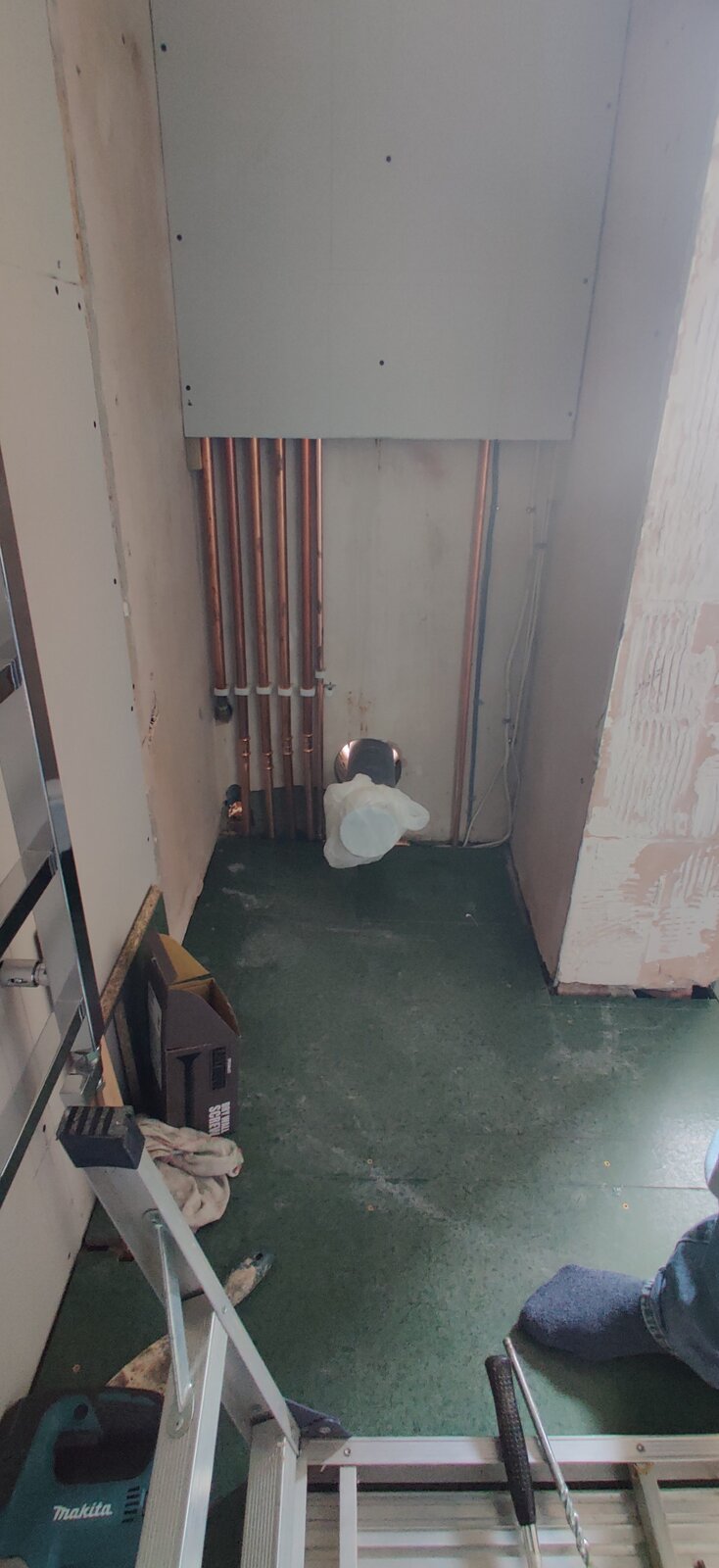

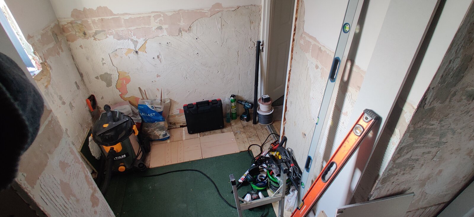

This is the general layout.
Bath (shower bath) will go where the vac is. Door is being closed up and a new one made directly in front of the soil pipe.
Hot and cold feeds have been brought up in the middle of the bath area since I'll be putting in concealed controls for shower and bath.

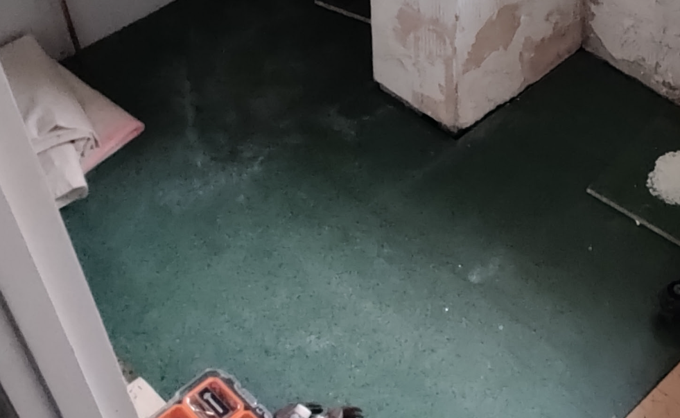

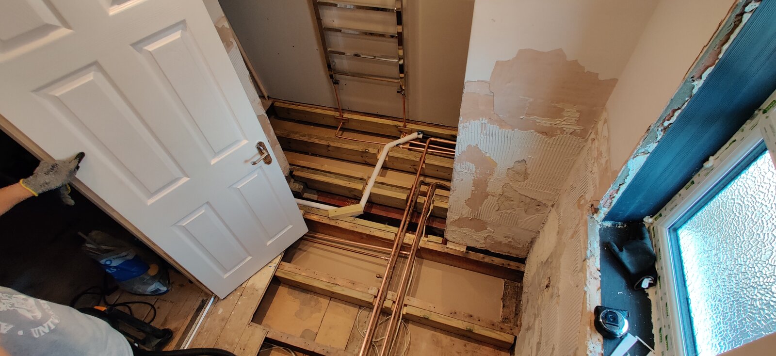

Another view of that area.
This was before the flooring was put down and after the plumbers had been to sort the:
Bath and sink waste, toilet soil pipe and re route some heating and hot water that were above floor level where the toilet is going.
The basin and bath waste were not put in to my liking, i.e. there was an uphill section near the towel rail, but i remedied that situation before putting the floor down.

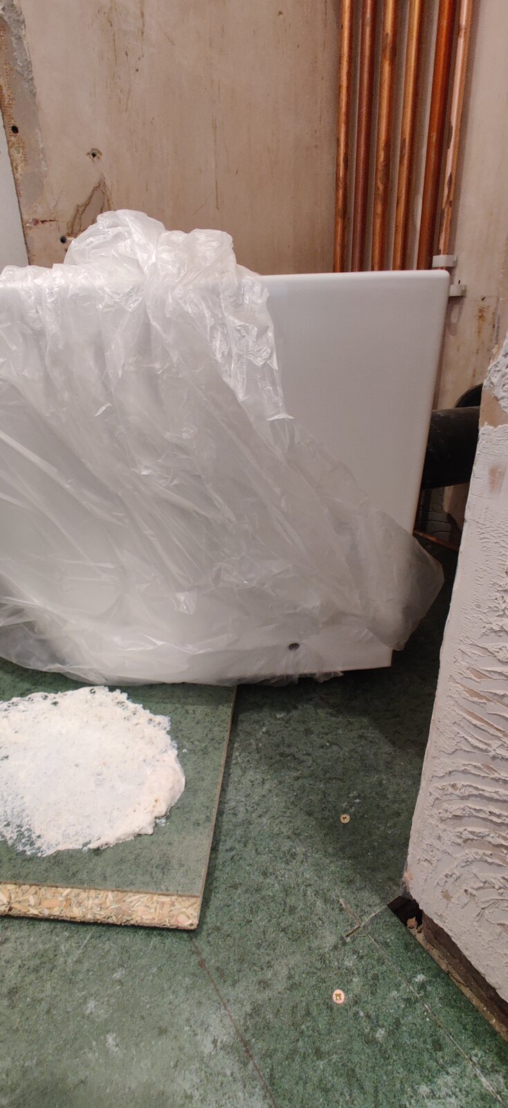

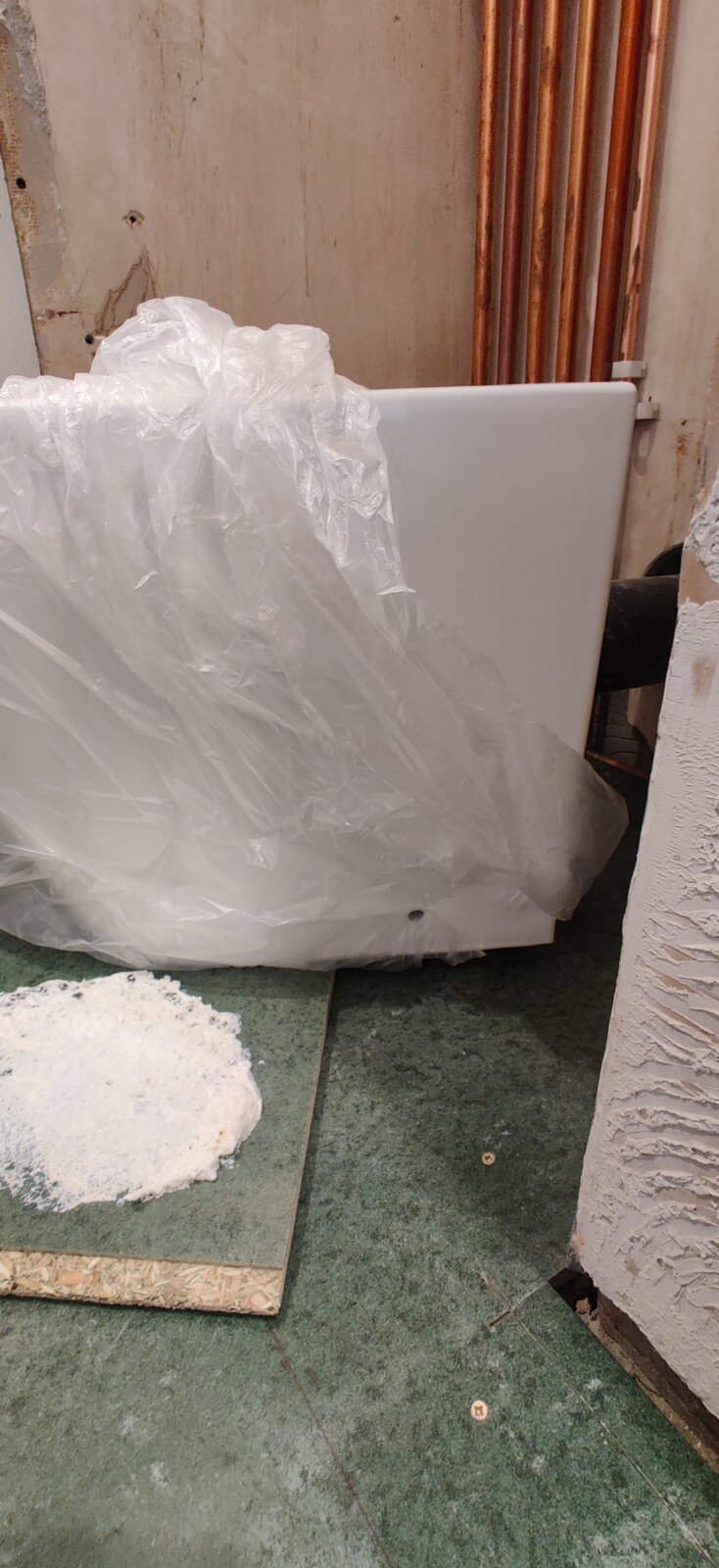

Here is the toilet, its on some scraps of 18mm chipboard to simulate additional floor height in this pic.
And round the back you can see that the soil does line up, and that it does have some play in it since I havent yet made good.
Going for a concealed cistern fyi.
Toilet on scraps of 18mm chip:

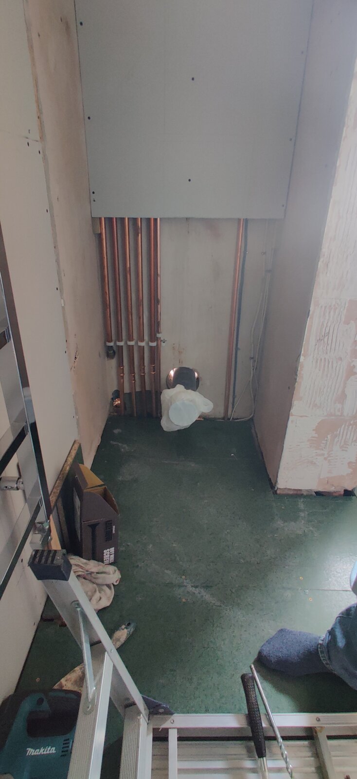

View of the toilet area:
IMG_20250522_070806.jpg The new door is directly behind where this pic was taken.

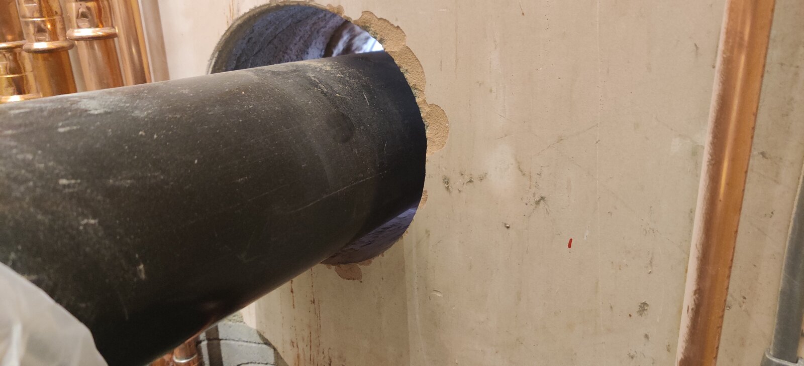

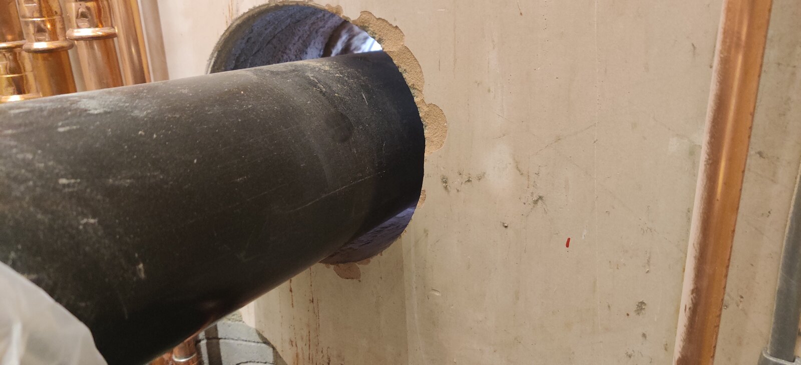

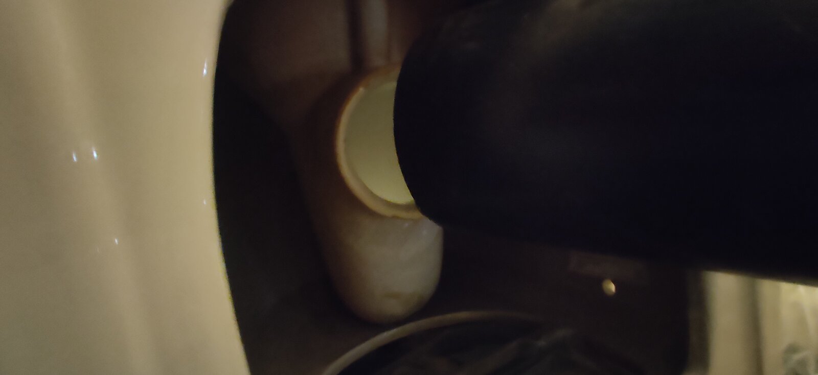

Soil pipe through the wall:

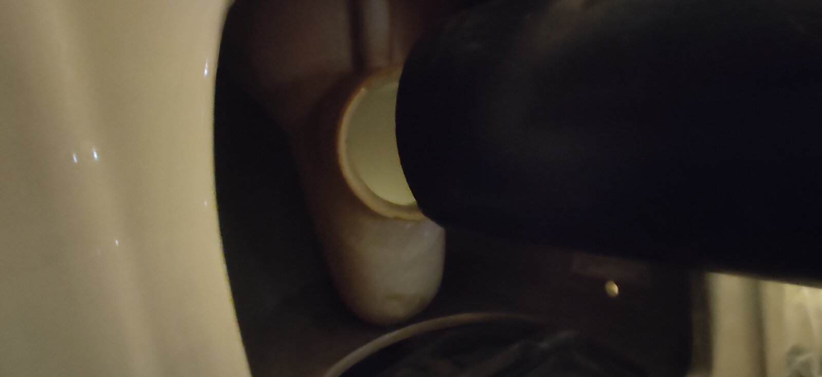

Hard to see / photo properly but this is the view back from the pipe under the pan.
You can always go higher with toilet pan and use an offset pan adapter which gets you another 10mm or so.

Thats a very clean & tidy site, well done.
You seem to have covered most things &, as you are aware, FFL is important for all fixtures & thresholds.
When you box-in the cistern make certain that you have easy access to the supply shut-off, and can easily open up the boxing.
Keep all wet pipes under pressure - when installed constantly flush the WC before closing in.
The window - the bath - the shower and the enclosure: do you have them in hand?
Same with the electrics & extractor?
