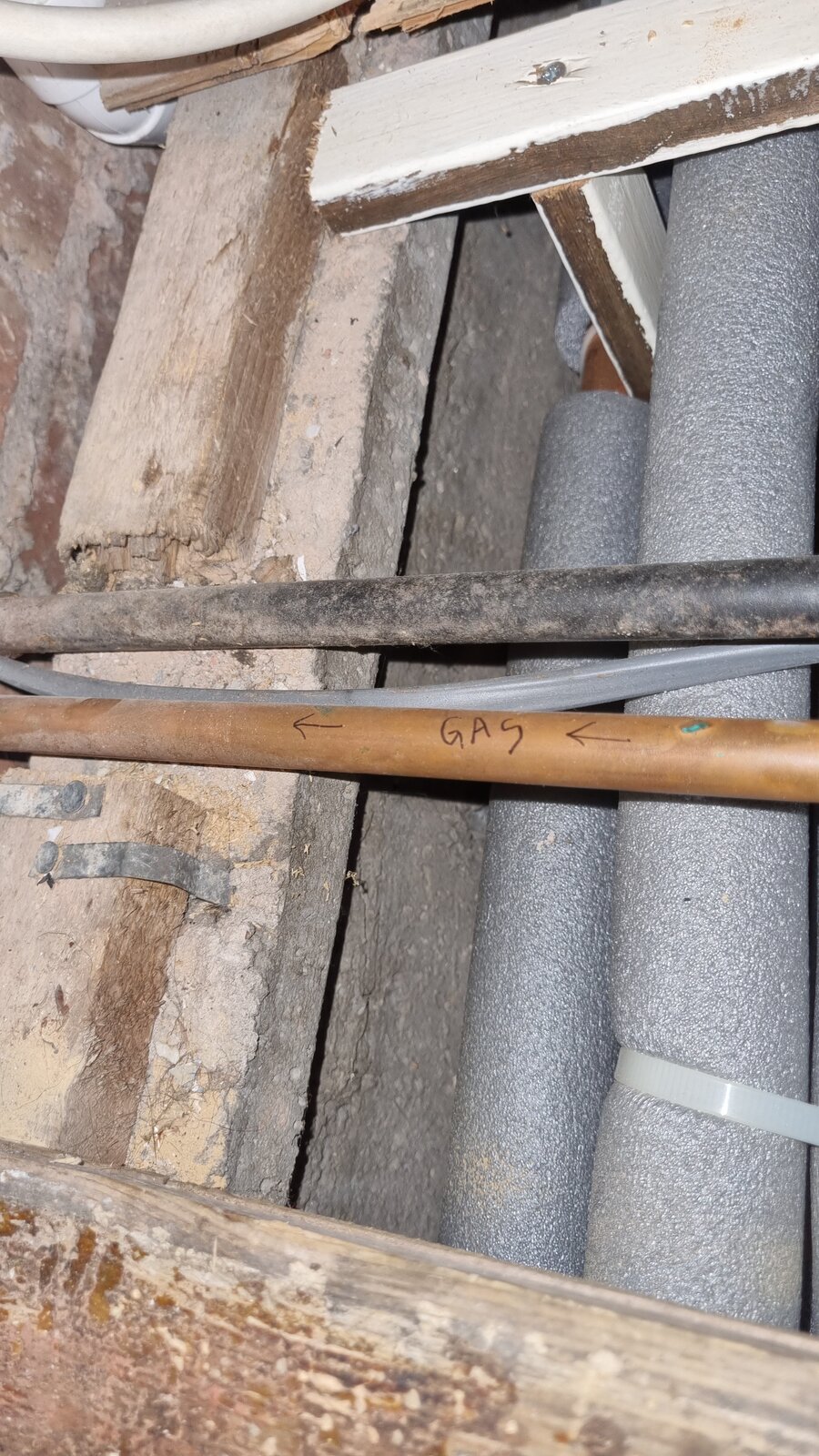

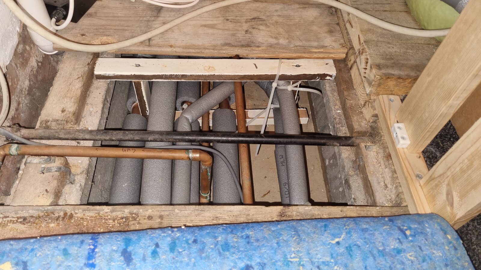

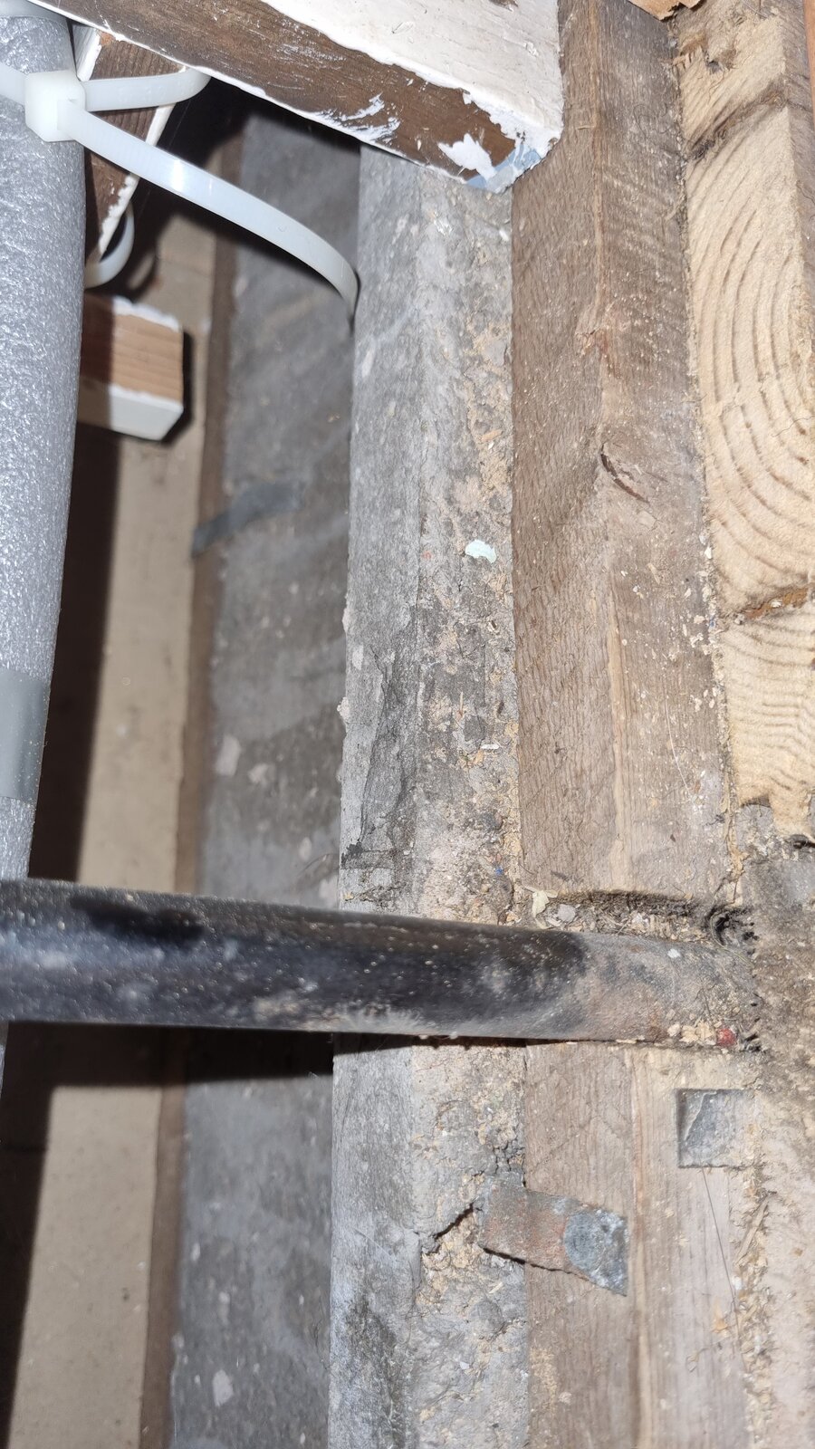

It's a wall that's sat on the floor - if I take the entire floor out, the wall falls down, if I do the floor in very short sections, it's harder to make a decent job of fixing up the butchered battens.
But the key thing I think you missed is that we don't have timber joists - they are concrete. Some pics from the bit of floor that's easy to lift up (in the cylinder cupboard) :
So no drilling through them, sistering to build up strength - just a barrier with a small gap top and bottom if you cut the timber batten out. And in places, the batten has been well and truly butchered.
EDIT: You can see how they included metal straps when they cast the joists, and then fixed battens top and bottom using the straps. Internally, IIRC there's a couple of rebar's down the web - but I can't get a view of any of the joist ends until I shift the furniture and get the carpet up in the bedroom.
EDIT2: They appear to be fairly springy, judging by how much some of the furniture rocks about in the bedroom as you walk around. But that might be the floor boards flexing and not being held down on the end joist as the batten will be effectively floating (a little).
