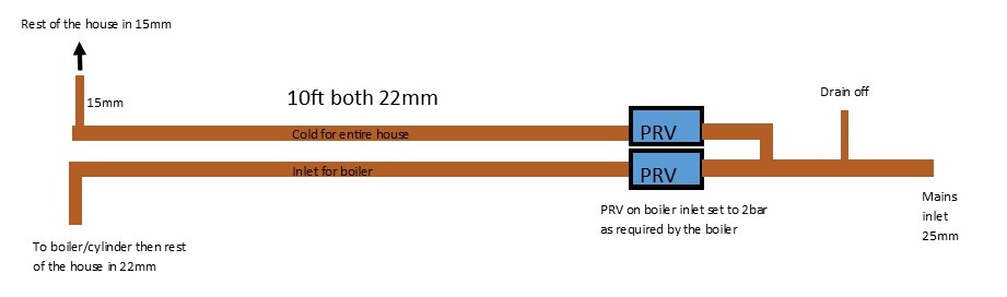

Hi all, this relates to a a job I've had done relating to a previous post problem. I have a new mains inlet that was supplying an unvented cylinder boiler setup - Ideal istor. Problem is it was limited by a 15mm supply pipe and a 15mm PRV so the flow rates were pretty poor - 8/9 LPM. Anyway, I've had this problem sorted - I now have a 22mm copper inlet and a specific 22mm PRV. Flow rates have increased to 15LPM approx as I have 22mm copper running up to the bathroom and ensuite.
However, my cold runs up in 15mm. The cold for the house is not directly off the mains but is after the PRV. So, my hot taps are pumping out at 15LPM and the cold at 10LPM. Because we cant install a separate cold water supply straight off the mains the plumber has advised installing 2 PRV's - one PRV for the hot and one PRV for the cold. The idea being that I could increase the pressure of the cold PRV which would increase the flow. We could increase the pressure of the cold to match the flow rate of the hot.
If we do achieve the same flow rate at the taps by increasing the pressure on the cold would this mean my showers then have a balanced feed? or would the pressures still be inbalanced even though the flow is the same and throw my showers out of syn? My plumber isnt 100% on this but said its worth a shot as he could just set the PRV at the same pressure as the hot one. Just wondered what your thoughts are on the flow/pressure issue? Thanks a lot

would the pressures be the same even though I've got different pipe sizes on the go? The plumber tells me if I want the same flow I need a setup like the image im attaching here. Currently I just have the one PRV but with another he says I can alter the pressure on the 15mm to increase the flow at the outlets. Without me telling the plumber how to do his job what should I be asking him? cheers
Increasing/reducing the pipe size does not change the pressure significantly, it changes the amount of water a given length will flow but that's not what's important when it comes to a balanced supply, it's the pressure that is at the inlet of the appliance that is important. If you add another PRV to the cold and increase that pressure to get the same flow as the hot then you are back to unbalanced supplies, cold now being higher pressure than the hot??
Trying explain the principle in relation to your setup, you say you have 22mm feeding your hot but it must reduce to 15mm prior to reaching the iso's/outlets? That means you do have 15mm pipe that is flowing at least 15L/min......therefore the cold 15mm pipe, if from the same supply/PRV, should be able to flow that at least too, that's a given. Not sure if that explains?

So the way to understand it is that a 15mm pipe will only flow a certain amount of water for a given pressure whether it's 100mm or 1000mm long, even if it was larger diameter before. Increasing the pressure in the cold to equal the flow of the hot will only create an imbalance.
If I understand your setup correctly (pic below?), your cold should be delivering the same. The flow restriction or pressure reduction then has to be in the pipework after the PRV or at the outlet where the L/Min measurements are being taken.

great - and yep that is my current setup but the cold flow rate is slower throughout the house on every tap even though by that stage both hot/cold are on 15mm piping. I just assumed the logical reason for this imbalance was purely due to different pipe sizes delivering the water to the rooms (15mm most of the way vs 22mm) but as you the say the pressures at the outlets will give me a clearer idea. I'll get the gear and have a go at doing it myself save myself some pennies. If the cold pressure is down I'm assuming adding a seperate PRV I could tweak would assist? I'm away for a period now but I'll get this done and post back. I'll post back once I've got some figures and hopefully you can make sense of it - not sure I'll be able to. cheers
Yup, with all the info it's not pointing at the pipe size, 15mm pipe should flow enough, there has to be a restriction on the cold somewhere.
If the cold pressure is down, it's finding out what's reducing it and correcting that.
