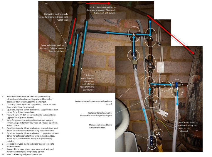

That's encouraging for my project. I've just gone unvented and I am pleased with the results. With several outlets open I get around 18lpm flowing through the water softener according to its display, and two showers can operate well.
I want to squeeze as much as I can before (or possibly avoiding) getting my connection pipe to the main upgraded (£2,600 quote as the allege it requires 6m of work under the road and pavement), which would be the final bottleneck with which to deal. So on my list I have
  1. Change the hoses on water softener
  2. Replace the 15mm valves, connections and pipes in the manifold above the mains valve, connecting to the water softener and unvented cylinder, most of which is sixty years old (see photo)
  3. Upgrade the run to the street stopcock
I wish there was a simple model you could use to forecast the impact of the changes.
I had the internal pipework and hoses improved. Flow rate went from 18 to 20lpm.
