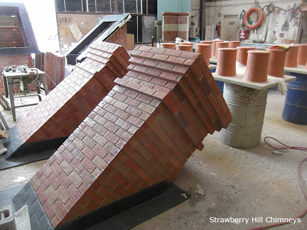

Or you could put a fibreglass chimney on the roof and put the vertical terminal of any boiler you like through it
Thanks Muggles for your helpful response. Unfortunately I probably should have been clearer that the ground floor roof is a single slope, as it's a one storey extension at the back of the house. So the ridge tile won't work (great idea though!), not the chimney. Any other ideas?!
