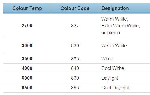

cheers guys, now you mention the numbers I can see that the white is 835 but what does that mean.... even warmer white? if so why call it white?
I guess there has to be some reason (that has so far escaped me!) for having these codes, rather than just using colour temperature, but the codes appear to be the colour temperature (K) divided by 100, then plus 800:
