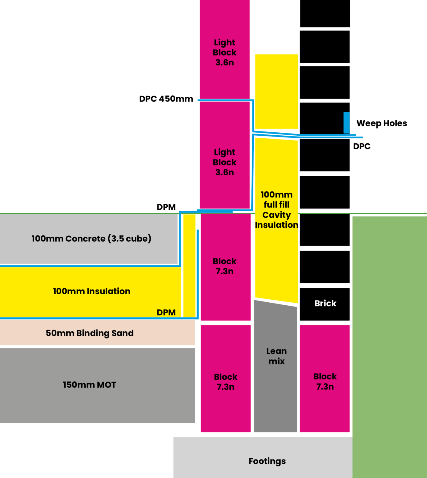

Hi,
Trying to workout what gound works I need to do and materials I need to order etc
Does this look correct for the slab and dpc layout. The footings are in already
Finished floor level will be the same internally and externally with flush thresholds so there is a double dpc
Am i correct to think that the heavier block should be used below ffl
Thanks in advance for any help
The design I always do is having the DPM's and DPC turned up onto the same brick. Full fill cavity should be banned, you should always have a 50mm clear cavity in my book.
Bridging the DPC across the cavity means you're going over an opening, otherwise, don't do that. The reason why the lean mix is 3 course of brick below DPC is for the mortar snots, your 450 DPC has reduced that to 1 course of brick.

So run the lower dpm up over the same block as the top one where it meets the dpc?
I assumed the DPC crosses the cavity as the external one needs to be higher up as level threshold, but I understand what you mean about the snots falling in if there is a bridged cavity
Are the block specs correct with 7n being below ffl and lighter ones above

The internal and external levels are the same. That's why the dpc is how it is as I could just do a standard dpc if the ground was lower so wanted to double check it all looked correct
Yeah I get the detail it's just why not just drop the ground? It only needs to flush at the threshold so you don't have to carry that level round the rest of building.
Obviously just ignore me if there are other good reasons. But complicated details can go awry.
Agree with the other comments about lapping the dpm (top dpm is just a vcl so you can get a cheaper polythene if wanted). I'd put 7N anywhere there's a possibility of water ingress and think about channel drains or a French drain around the building perimeter.
Thanks george. we just want to eliminate any steps ideally. I could fit a slot drain fairly easily as new drainage runs are going around the extension. The ground will also slope away from the house when paved.
