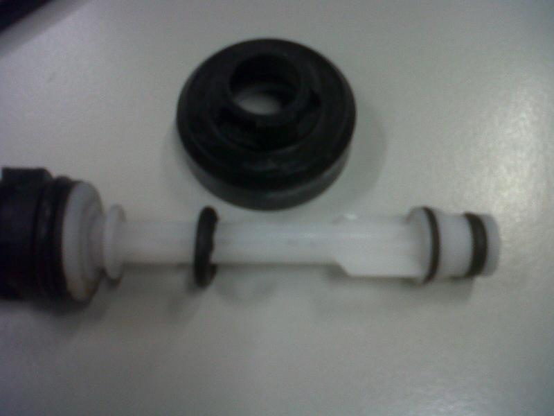

Here is the inside of the control set, there are 4 o rings on there, the one I have moved down the shaft has gone U/S so reckon this is an easy fix. Really surprised Aqualisa dont supply these o'rings as part of a service kit. Only thing left to try and source are the brushes.
