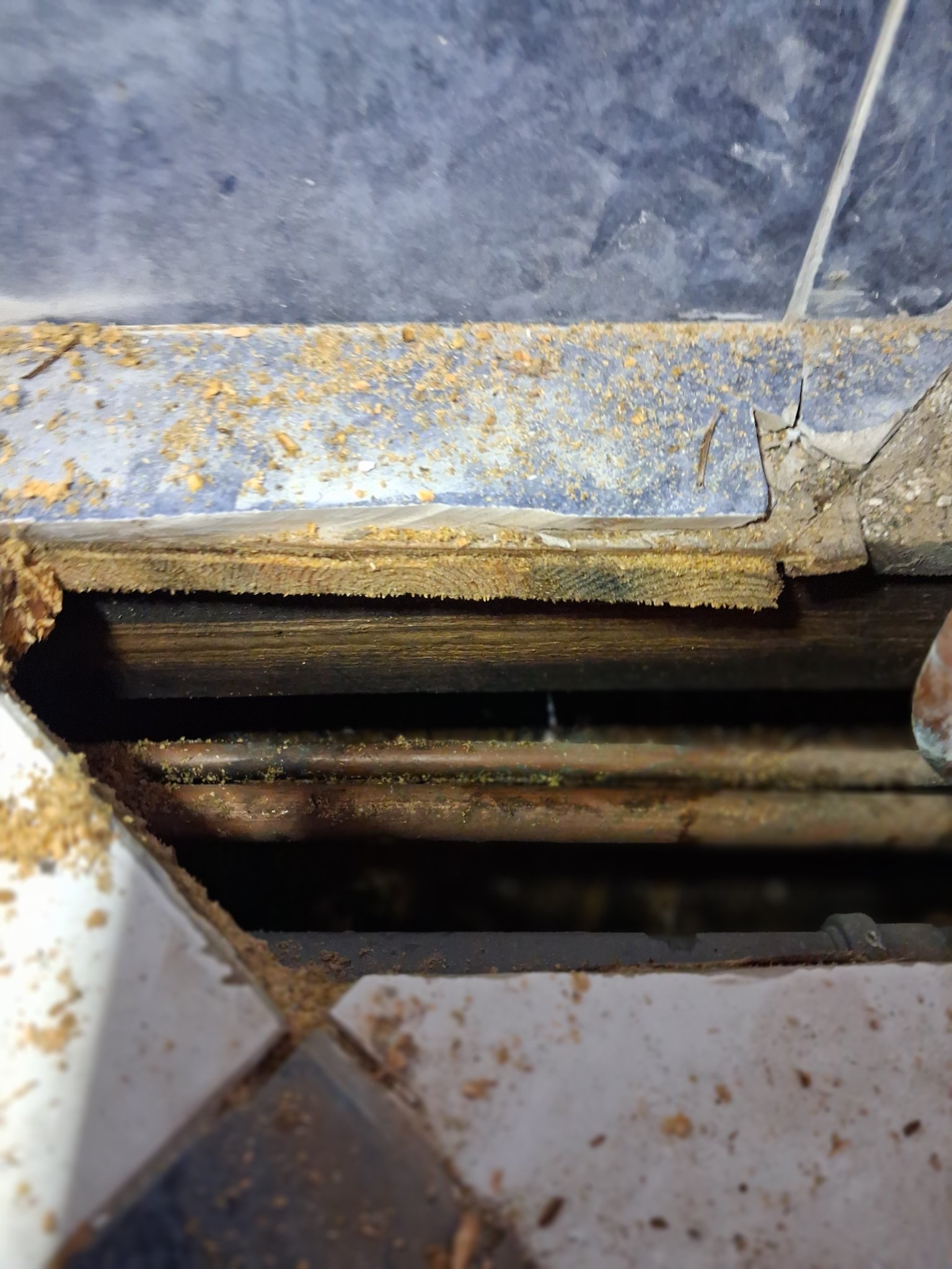

Pulled steam shower out for access. Part P won't help here, needless to say it's not going back!

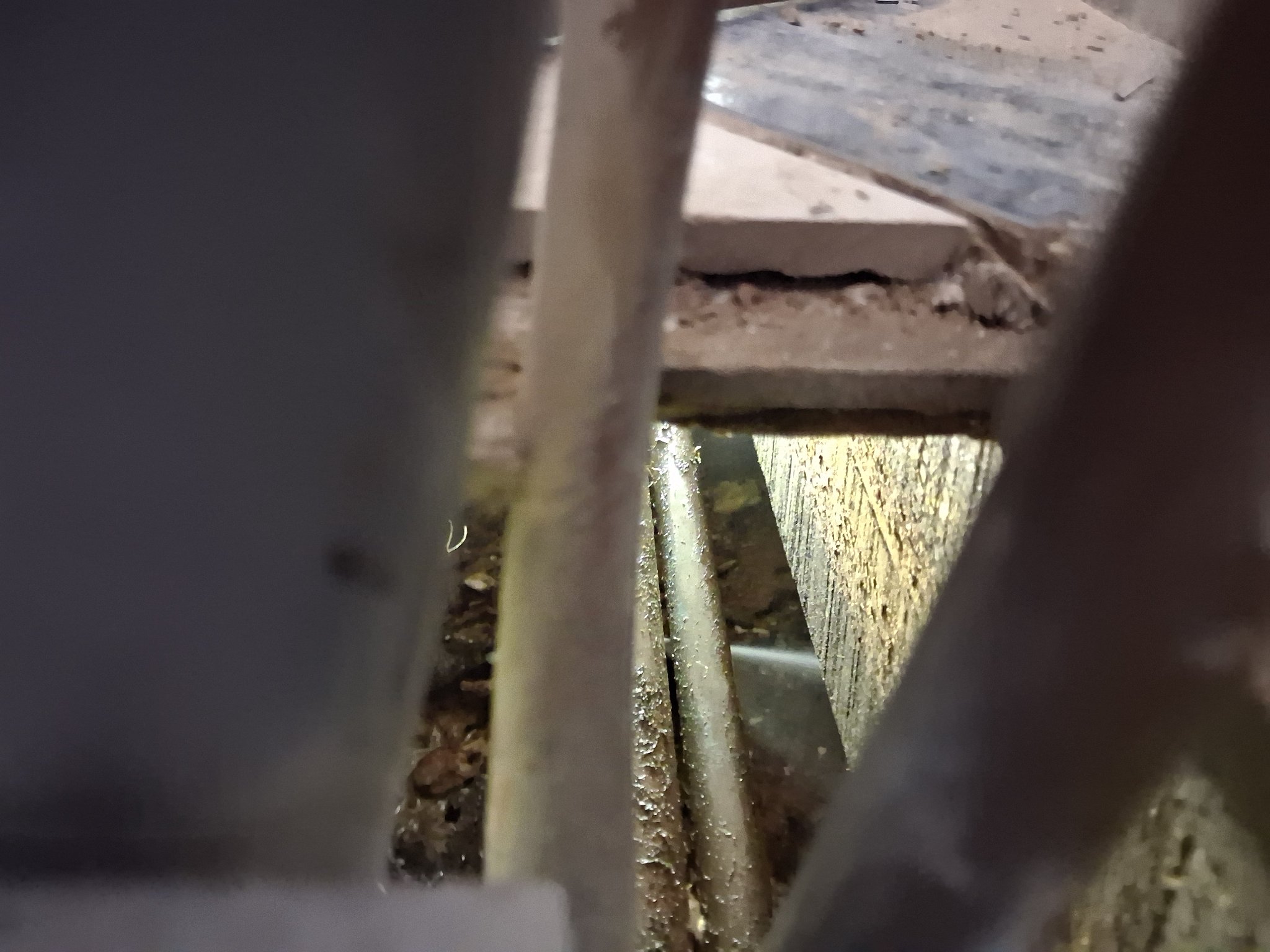

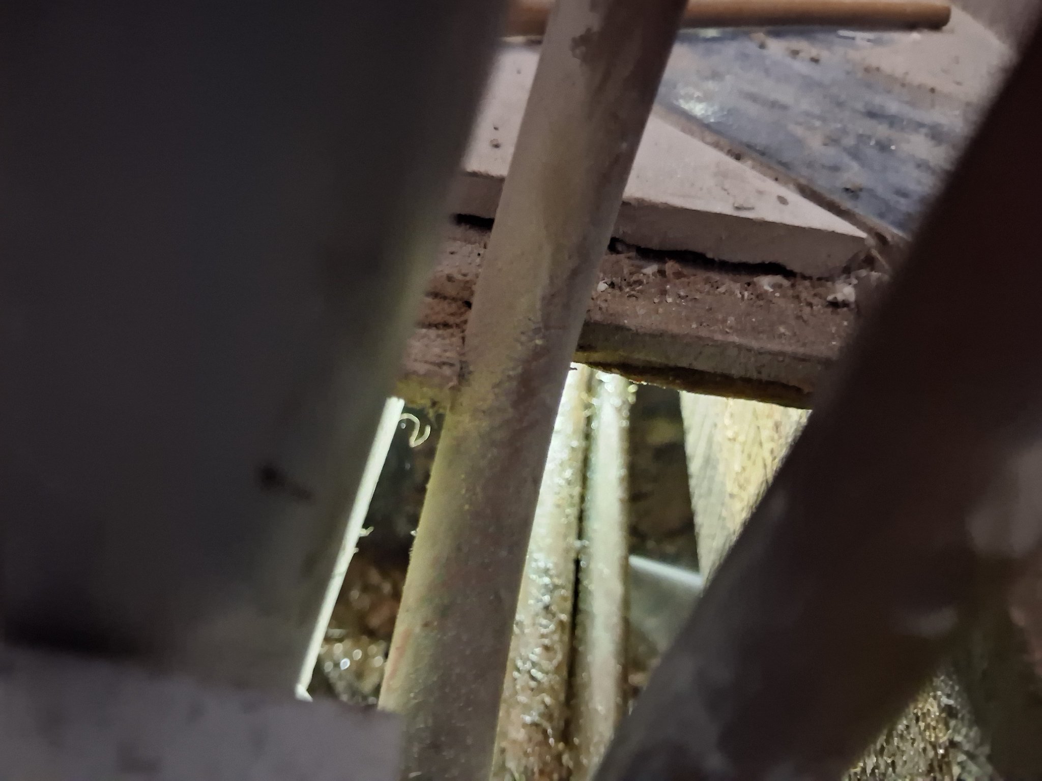

Hope I'm not a pita with the Q's. I have to get pipe from kitchen under hall to bathroom. It looks like it goes thro' hole in small wall to support floor joists. Could you cut copper at one end, pushfit plastic pipe on, from other end cut sections out and pull the plastic thro' the same hole?
Or push n pull with one either end, maybe a dog collar to stop the top of the push fit snagging on the hole?
