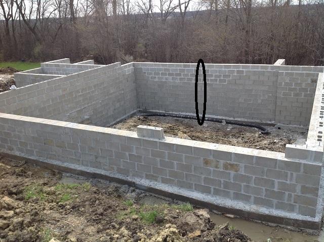

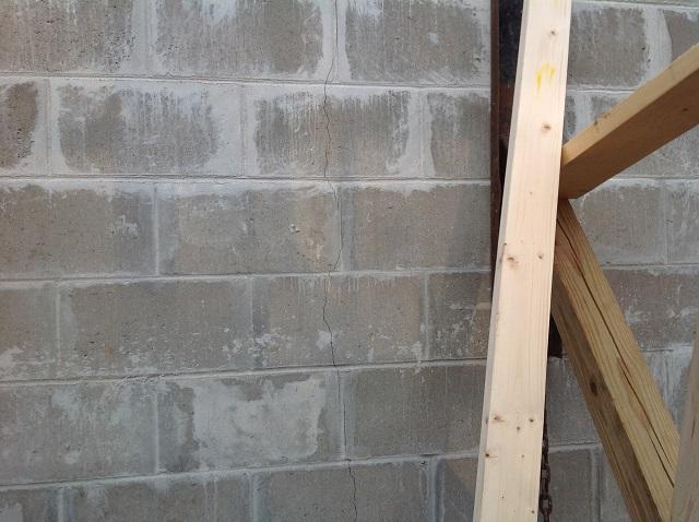

Hi everybody, my Wife and I are building a home, a two story with a walkout.We drove to the site tonight to see how the house is taking shape. The have poured footings, set block foundation, backfilled and started to frame the basement. While looking around we noticed a crack in the foundation from the very top course of block all the way to the footing. It's cracked through the center of blocks and also through mortar joints. How is something like this addressed? Does the wall need to be re-blocked or are there repairs for these situations? I would like to get opinions before I hear what they have to say. The builder hasn't said anything about it, but I think it has just happened yesterday or today. I have pictures and have contacted our Rep to see what they say.

A pic of the actual crack would help. What i can see doesn't indicate any serious fault - i was under the impression, my mistake, that the crack had split the blockwork from outside to inside.
There's a little slope which indicates that not too much backfilling would have been required.
Everything else in the build in progress seems perfectly ordinary, and done to Code.
Thanks for the pic, I notice that the wall is braced to the right of the crack. No other bracing is showing in the pics.
Still hard to tell: that crack could be a shrinkage crack, as suggested above.
Footings should only be poured on undisturbed soil, or you are into pile driving territory.
If there was make up soil at one end of the footing, then the footing might sink a little at that end. Does the crack continue through the footing?

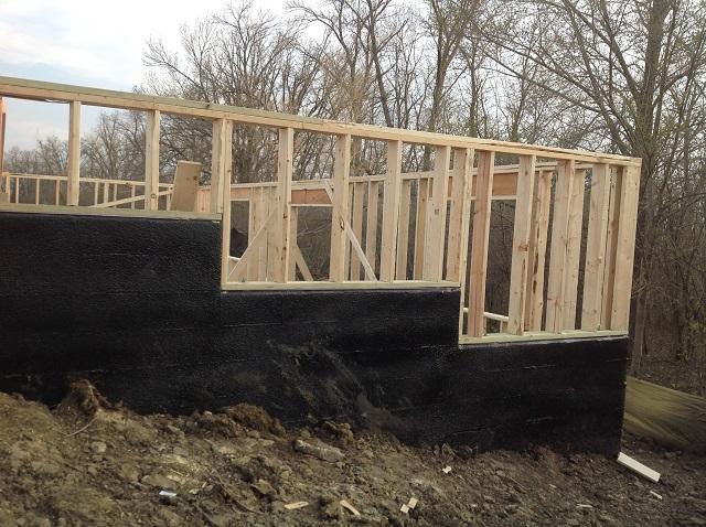

Part of your foundation blockwork has been damproofed - why not all?
The crack doesn't continue into the footing, at least that I can see.
The pics I've sent aren't in any particular order. I was just sending them to give you an idea of the lot. The whole foundation has been sprayed.
