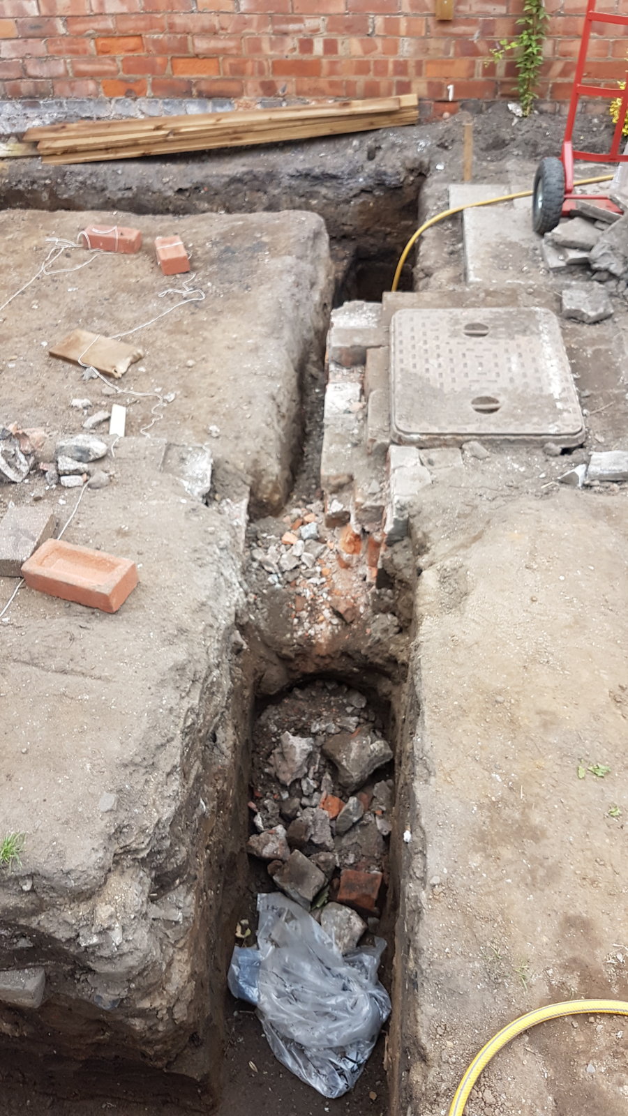

Hello all,
I am looking for some advice, building a garden shed.
There is a drain in the way of where I would like to build the foundations, it only serves my property and is 1 pipe in and 1 out. Northumbrian water have said it's private and they have no issues with me moving it.
The drain is about 0.6m deep, there is a Buchan trap inside the drain and it slopes down to the back sewer to about 1.2m. I have dug the foundations down to be 0.8m which should be below the invert of the drain pipe. So shouldn't be any load imposed on the pipe.
My question is, am I ok to smash out the bricks of the chamber and use shuttering or move the chamber
wall to the edge of the foundation and rebuild before the concrete is poured?
I'm probably over thinking it, but the last thing I want is to wreck the drainage line and have my new shed and existing wall have to be torn down to repair it.
Any advice appreciated.
It looks a mighty deep foundation for a garden shed?
Anyway, why not leave the chamber undisturbed and put a concrete lintel astride the wall of the chamber, supported off the
foundation wall each side of the chamber.

Thanks for your reply. Will it be OK to leave a gap in the foundation between the chamber? This sounds like a better option as I don't really want to damage the chamber or pipes.
The foundations is about 0.8m to be below the drain pipe. It's not a timber shed, will be blocks / brick single skin.
Yes, you'd just leave a gap in the concrete foundation and wall where the chamber is, so that there is no physical contact with the new work.
The concrete lintel just forms a bridge over the chamber wall, parallel to it, as long as there is sufficient space left to take up the lid.

Yeah Woody that's what I meant. It will go over the brick work only, not the actual lid of the chamber.
I'm guessing as both you and Tony have mentioned it, the lintel option and split foundation is best. I will go with that. Cheers
Thanks Hugh. My original idea was to take out manhole and trap, put a straight through in after foundations are poured and move the chamber a couple meters closer to the house for a new toilet connection. That's why I dug the foundations right upto manhole. I wasn't 100% sure this was alright, so thought I'd check on here.
