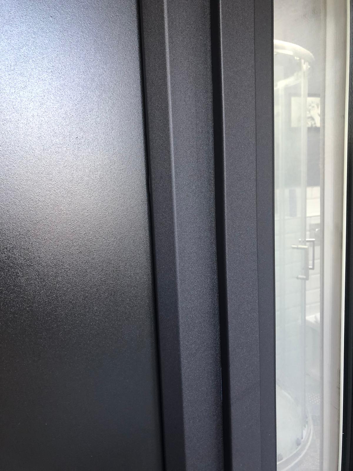

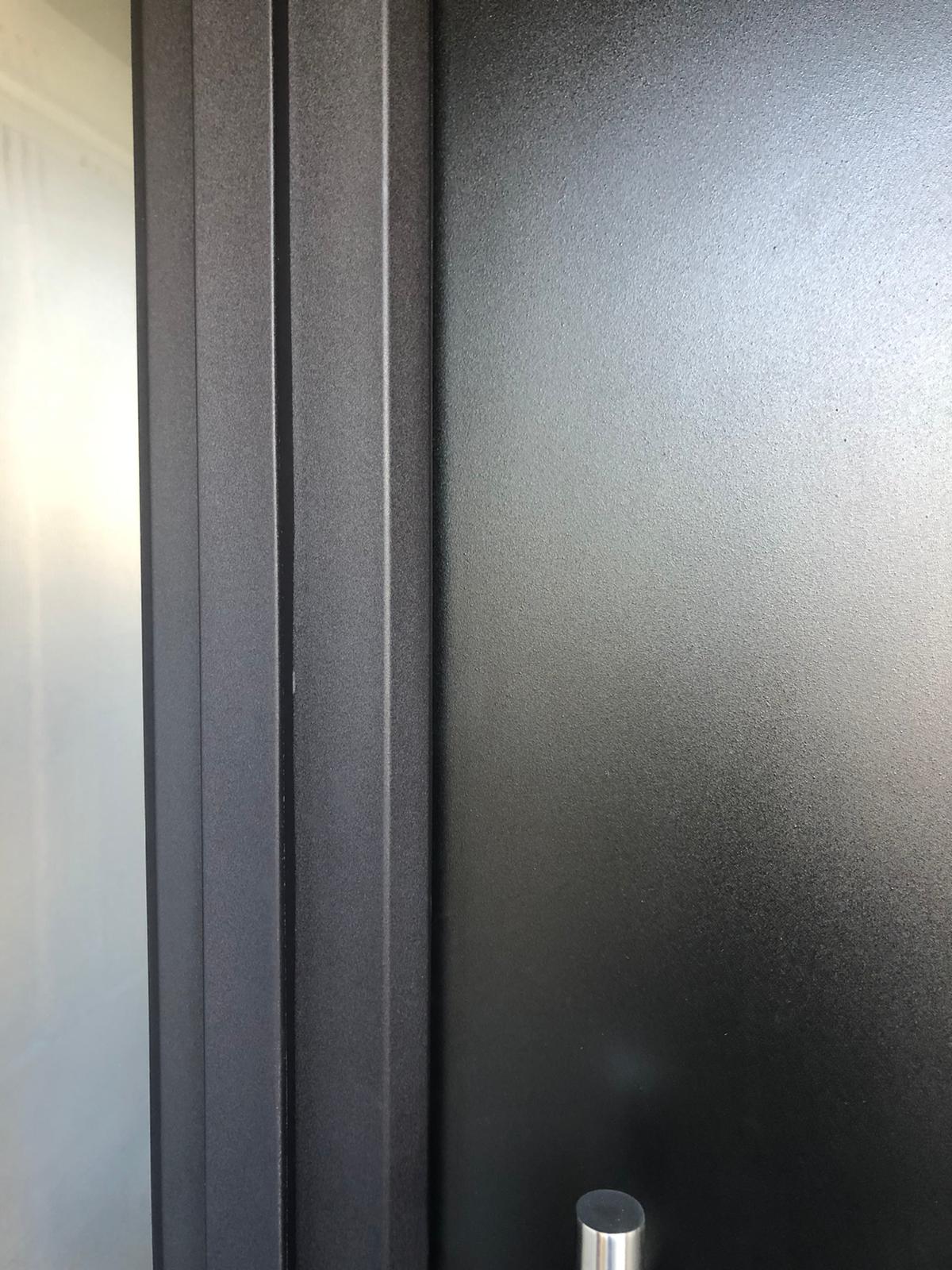

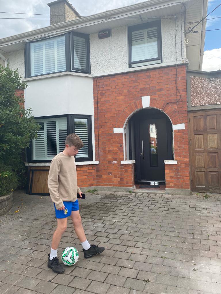

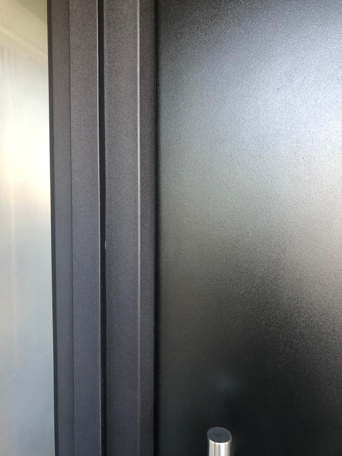

Is there any comeback from supplier if they didn’t tell us the colour wouldn’t match??
They are stonewalling us saying that they are both black, but the frame is clearly a petrol black
colour
Could do with a picture from further away. As has already been said on this post, most upvc frames are actually ' beck brown ' rather than black. Personally I consider it foolish for any supplier to not mention it to the customer , hence I'm always very up front about it . Technically i suppose you could argue its been mis sold as the frame is a different shade BUT I suspect you won't get far
I was thinking of that approach of being mis sold the door and frame. Would it be industry standard to inform the customer that the same colour might not match on different materials??
Personally I would always say, saves any misunderstanding. I can't speak for others though so can't say whether it would be
