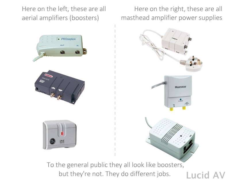

- whether the booster is a real booster or if it's a power supply for an aerial amplifier somewhere on the aerial mast or in the loft (highly likely, but could do with being confirmed; a make and model number would be useful)
- if there is a masthead amp somewhere, is it one with a fixed amount of amplification, or does it have a level adjustment control. This could be on the amp itself or on the power supply that looks like the booster

Well, what I thought was a booster (it used to be) is actually a power supply thingy for a mast head amp. It got replaced not long ago as it sort of blew up - well it was soaking wet inside and knackered.
