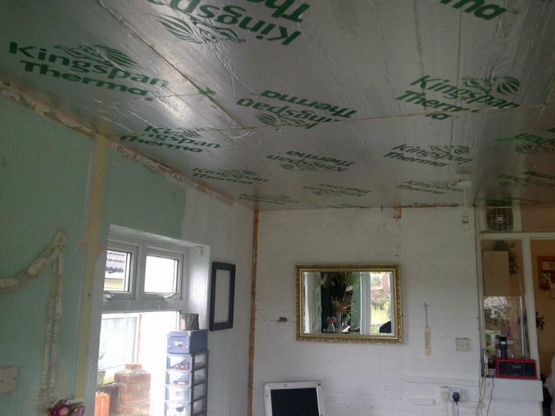

Here is a picture of my extension. Sorry its a mess.
To the right is the bathroom. The wall used to be external and it still an active cavity. At the bottom of the wall there is a sealed gully which I am going to leave in place as its been there for 30 years. This gully accepts water from bathroom shower and sink.
Straight ahead is the wall between the kitchen and extension. Again, this wall used to be external and its an active cavity. There is a sealed gully there too which again I will leave due to massive expense in moving it. This gully accepts waster from kitchen sink and washing machine.
Behnd is a 4 metre wide double glazed sliding door which is new. All other walls are exterior cavities which are not tied into the original part of the house cavity. Rubbish eh ?
I have kingspan between the joists and under the joists on the flat roof. I guess I should get round to plaster boarding it. This roof is cold deck.
The problem I have it that all walls are exterior walls and the place is freezing. I can feel immense cold radiation from all walls even when the heating is on.
In the garden I have 25mm kingspan boards. My question is, do I line the walls with them to make the extension more warm and then plasterboard over them ?
Those old cavity walls are like ice blocks and the new cavity walls aren't much better despite being insulated may years ago.
I have plumbing running along the bases of all walls so therefore plan on not putting the kingspan right down to the floor and eventually boxing the bottoms of the walls in.
Something else rather interesting. Please also see photo of stink pipe. Comments please. Its been there since the 70's and I was planning on just boxing it in. Also, there is a sealed manhole in the middle of the floor which again I am planning on leaving.
As you can see, there is a lot wrong here but I am planning on staying in this house forever.
I just want to make it very warm and very cosy as a livable space without much money being spent on it. After all, those pipes have been there since the 70's and as long as I dont touch them, I wont need to bring them to current regs. The pipe literally pokes out of the wall into a void between this extension and the next doors extension.
Also, from my humidity meter how humid it is in here which relates to my previous post about rendering breaching the DPC. The same is true here, the render breaches the entire extension DPC.
I am planning on going into the roof one day, so I wonder if I will have to disconnect this stink pipe and move the manhole then ?
I look forward to hearing your comments.
