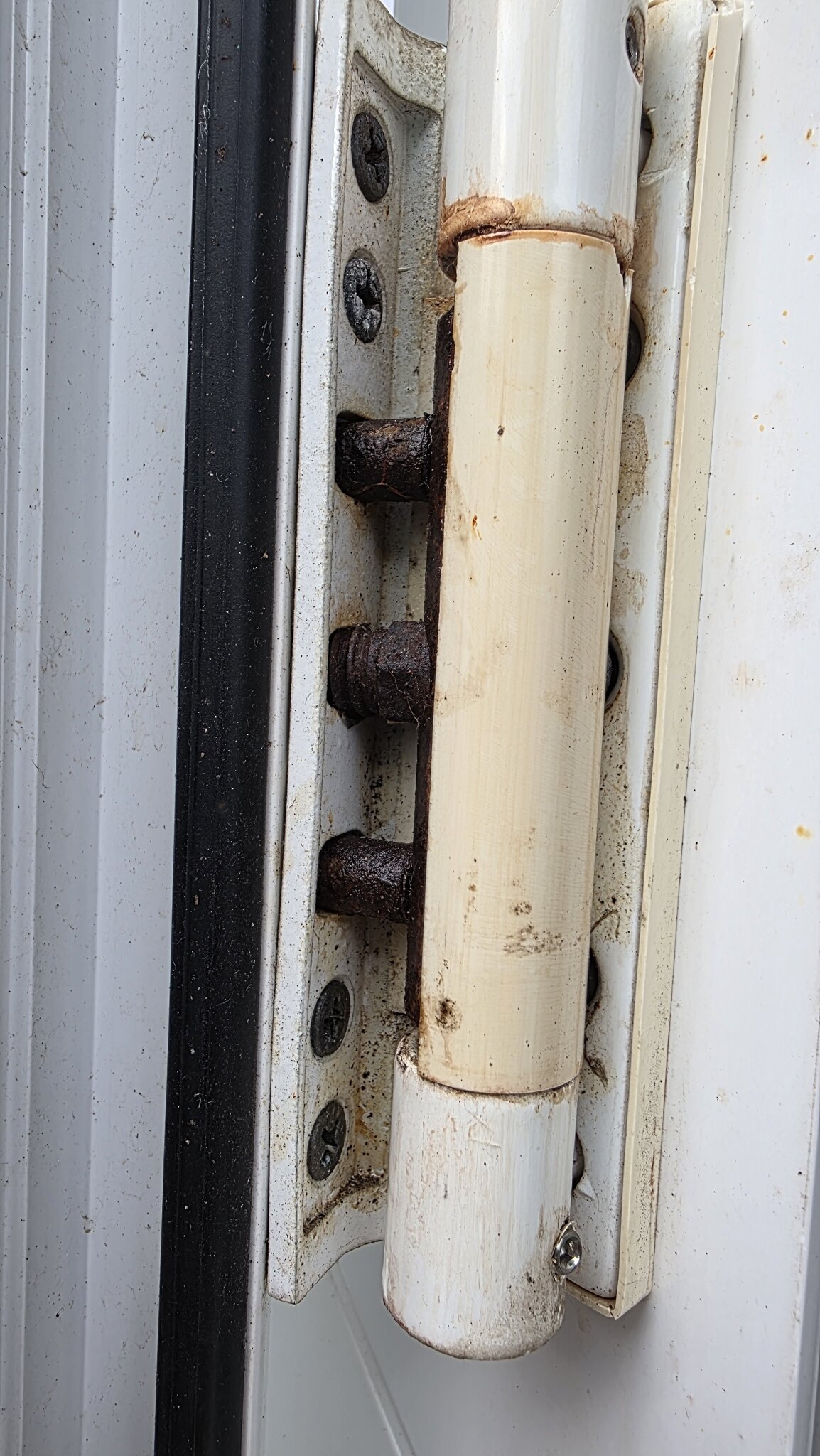

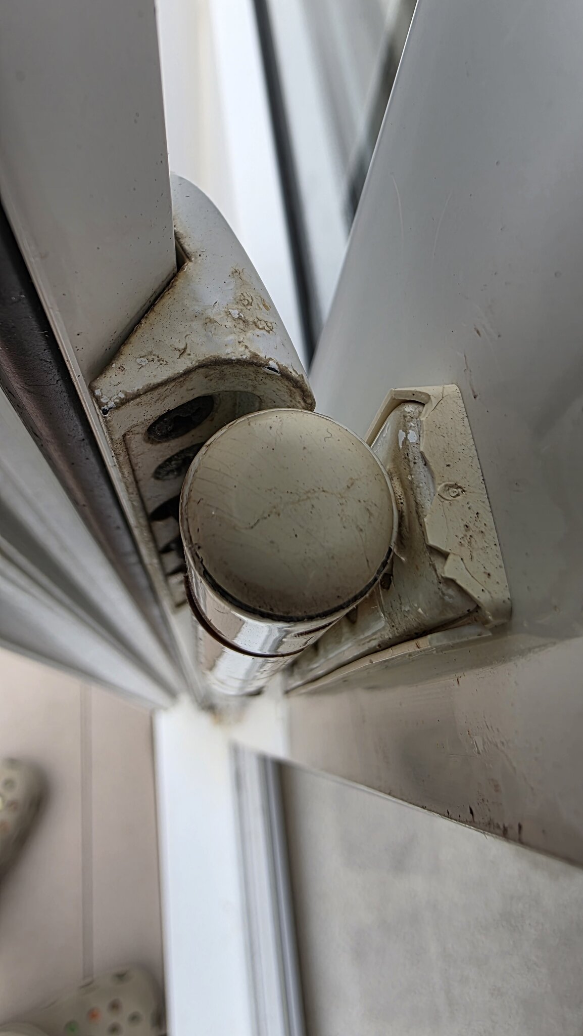

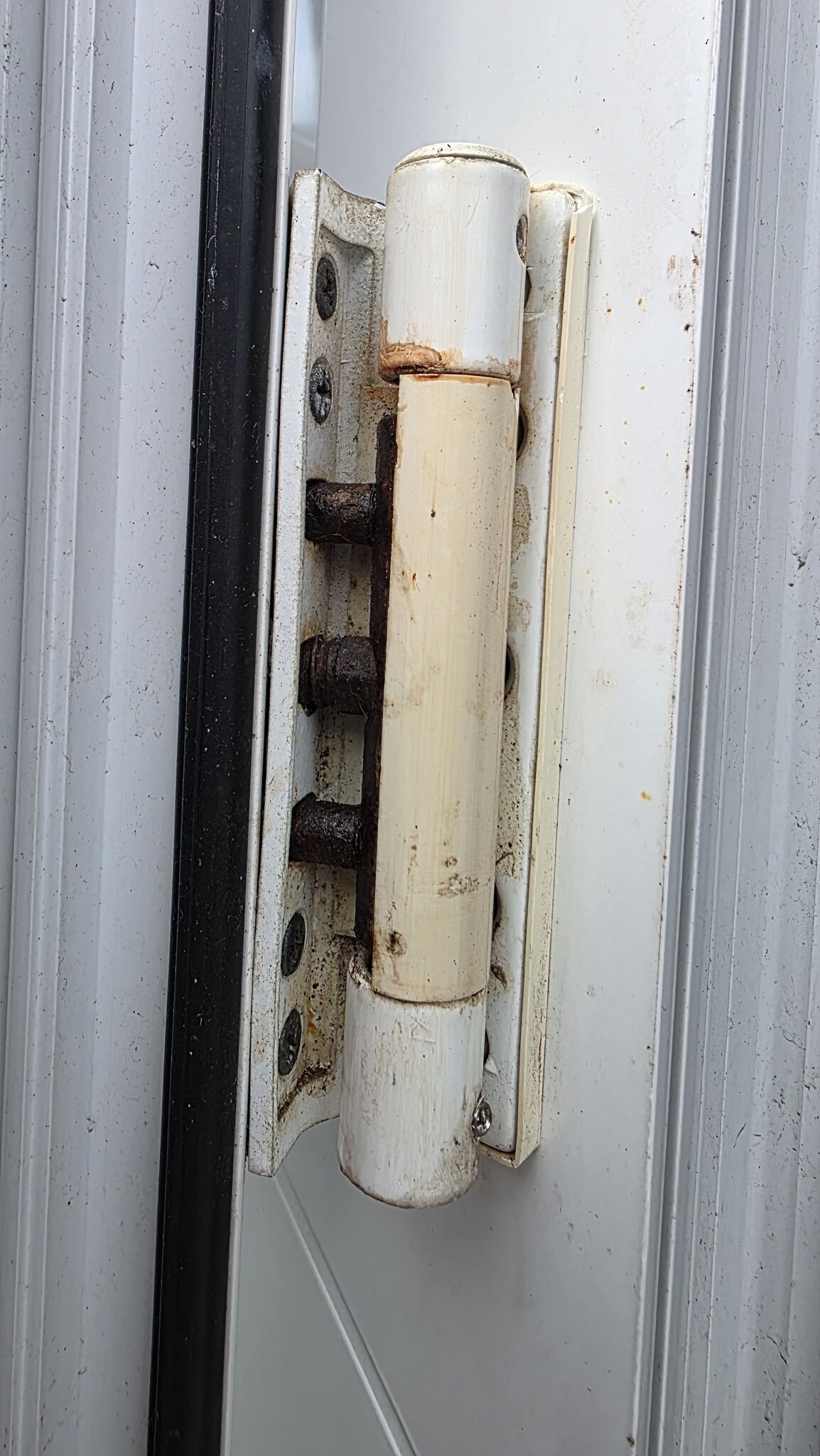

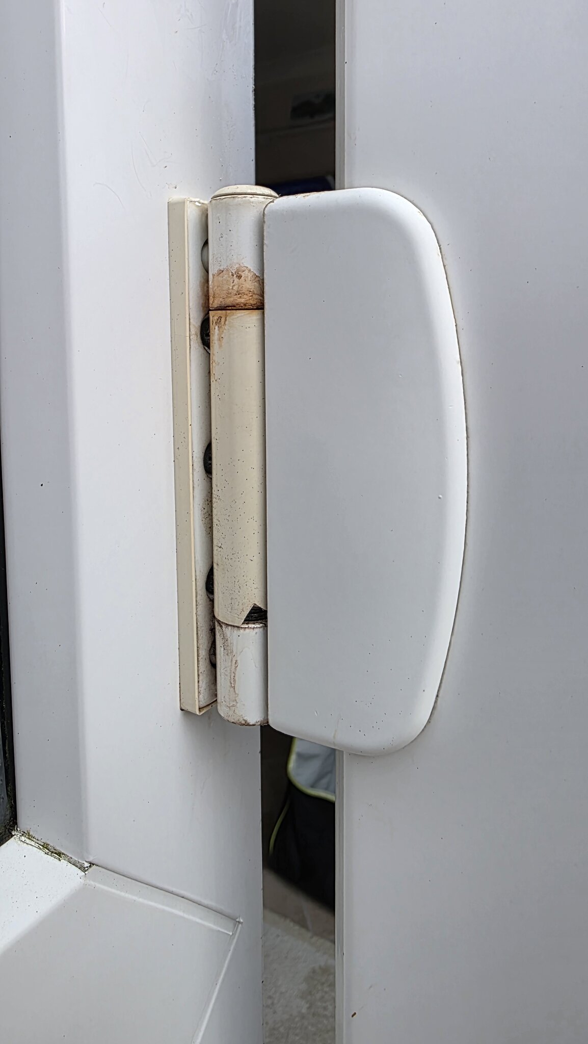

A total of six hinges on two doors. All the hinges are in this rusted condition. The central plastic cover has broken away from several of the hinges revealing oxidisation.
Would you be concerned enough to be looking to replace these hinges? I've not been able to find them online so far.

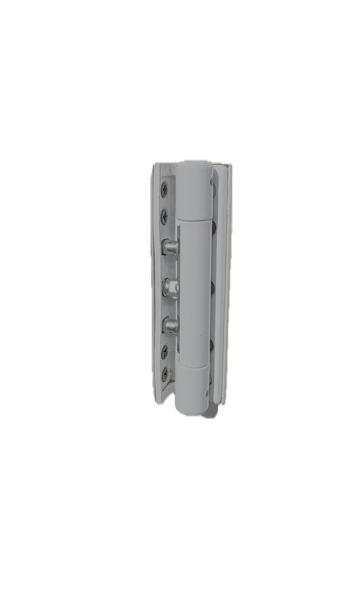

Yes there are, the door part is specific to that pvc system or profile, the frame part is generic
This one still isn't quite right so it my be worth emailing the pictures you have to them, good guys these
SFS Dynamic 2D Upvc Door Hinge Screw In Pin Angled Plate https://share.google/0jEwgJ5op4NGJNjm1
This one looks close
Both of those do look close. Good idea to email them the pictures to confirm either way. Thanks for the suggestion.(y)

I emailed photos to upvcspares4repairs, who were really helpful. They recommended which hinge to order however the hinge came with face plate type 84 whereas my face plate is type 79. (Type 84 is for a right-angled door frame; type 79 has an angle.) Of course, it was no surprise to hear that type 79 was likely obsolete. This wasn't much of a problem as I could clean up the type 79 face plates and re-use. The important thing to change was the hinge.
In addition, the hinges sit in nest packers. Unfortunately, those supplied were 4.5mm and these would push the doors away from the door frame so the doors would not make good contact with the door seal. I needed something like 2mm nest packers. Again, I had to re-use the ones I had, which were extremely brittle.
Overall, I'm happy with the result.
