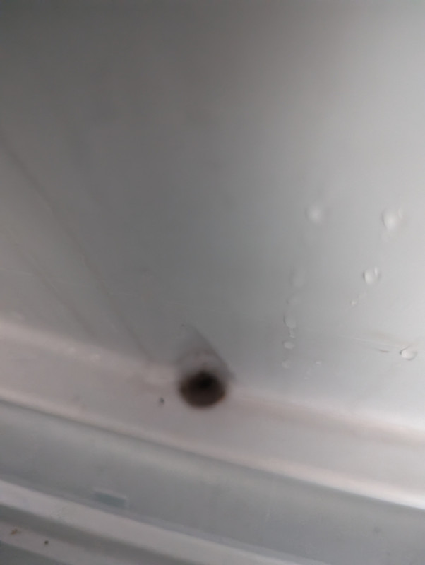

In the bottom of the freezer section, keep finding a puddle of frozen water.
I scrape it out, only to find another puddle there the next day. Been going on for a couple of weeks now.
Any ideas what th issue could be?
Blocked drainage hole?
Where would this be?
Can't see any holes in the freezer section unless it's behind the screwed down rear panel.
There are drainage holes in upper fridge section though. Could that affect things or are these compartments completely separate?
If it's a frost free freezer, there is probably a duct choked with ice. As this is hidden inside the back, it takes a long time to melt out.

Take the back plate off the inside of the freezer, its probably full of ice and its heater cant recover it.

If it is locked in place with ice, don't force it. Leave it turned off with the door open until it stops dripping, inside, and also round the back into the evaporation dish (if visible). Clean out the dish and pipes

Find drip tray near pump. Go look around back of freezer for plastic tray. It's where water drips then evaporates. Push something up drip hole and see where it comes out inside..I have to clear ours every few months.

What sometimes happens is a little bit of food or wet cardboard gets into the hole, then as it rots bacteria and mould take hold and the hole gets blocked (that's why they can be a dark colour), on certain types of fridge there are little plastic strips on the back of the shelves and these can easily fall off and people tend to leave them off but not realising that they're designed to stop any food etc touching the back of the fridge, minimising the chances of stuff ending up in the hole and allowing air to circulate properly.

Quick reply to you all. Managed to clear the drain plug at the back above the tray. Works a treat now for well over a week without any issues. Previously, I was clearing out ice every day. Many thanks!
Actually, spoke too soon. Got the same problem a few weeks later.
Have given the thing a clean out again but this time a massive defrost.
If I start getting issues again I guess it's new fridge freezer time.
