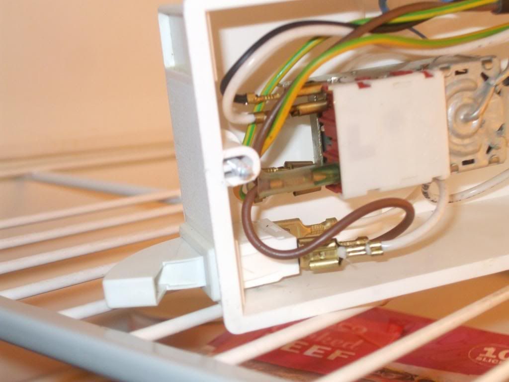

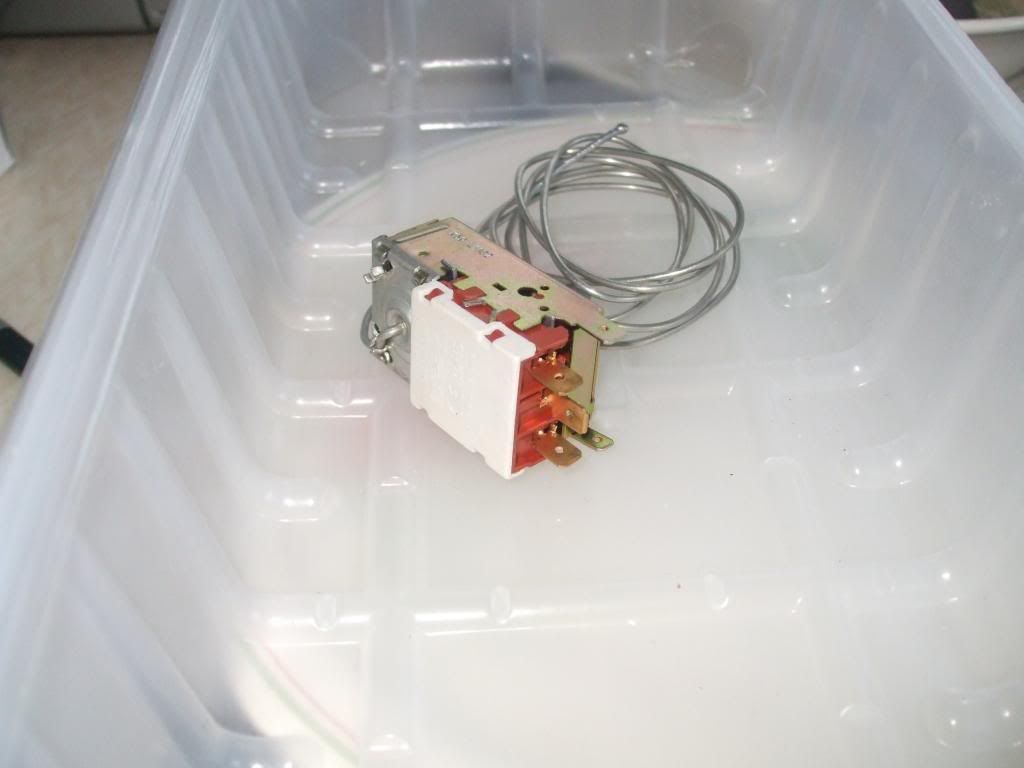

Went to change the thermostat this morning and found that the recieved item is slightly different, i.e. there is a horizontal terminal between the earth points? on the original there is a combined connector on one terminal apart from the obvious switch terminal.
(hello drawing board again)
Original thermostat has earth connect to chassis terminal; white wire and blue wire to duo terminal other upper terminal brown to brown wires.
New thermostat has centre terminal as well.
Any suggestions, or have I actually got the wrong thermostat?
Likely the two thermostats are interchangeable I would measure with meter to be sure of course but the major question has to be what makes to think the thermostat is faulty?

Main reason I went for the thermostat, it's the only bit I can see I can do anything with. Well I wired it in and got the same results, so it may well be what you have suggested.
Now going to get a new appliance as the advice seems to be that it's old and costing more to run than a new one. Now got to figure out where from.
