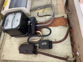

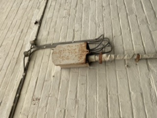

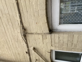

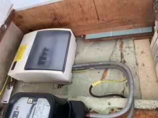

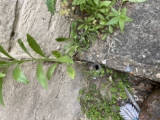

Hi, had a friend ask me for advice regarding a Two Bed House he’s buying and doing up. Took some shots of the Incoming Power. It used to be a Bakery as a building but since been converted into three dwellings. TT with an old shared service head. It’s split at various places. He wants the meter moved under a set of Stairs. Think the DNO should be able to help with this matter before any further work is done. The cable from the Earth rod looks about 10mm. DB installed 2010 two circuits Sockets & Lights both on RCBOs inside a Five Way board (plastic). Lots of surface mounted cable wall papered over :eek: .

The DNO are THE ONLY folk who can move the meter. when you are doing that, request a PME (TNC-S) service. Then you can get rid of the rather shaky looking earth pipe. I guess that’s what the picture with the dishwash brush shows?
If that’s what it is, it needs renewing if you going to stay with TT. You need to check the Ze Of that. 10mm earth cable is ample, it’s only ever going to carry a maximum of 30mA!
It may need to be bigger if it’s unprotected. Check your OSG for details, but -really- try and get TNC-S.
I should have taken my Work Megger and Tested it, I'm hoping he can contact the DNO and get a new Service head put in with PME for sure and an Isolator after the meter too. The Feed is very old & odd how it's split for each property.

The DNO can move that to a new position, it’s an old wall box with either a split phase or three phase cutout inside feeding lead ins to each meter position. It may very well have a good earth connection back to the main so might be able to be used as TNS with an earth clamp on the lead sheath rather than PME. Obviously they’d have to test and decide that.
The DNO will move the cutout but can’t touch the meter- that is down to the supplier and they will have to be arranged to come on the same day and move the meter when the DNO have done their bit
