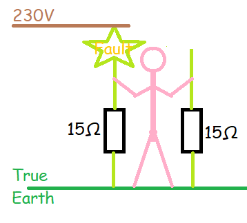

Nearly every other electrical item used in one's garden is class II, it seems crazy why EV's are not class II, It seems all the rules are being rewritten in the push to have electric cars, anything else, caravans, boats etc, TN-C-S supplies are banned with good reason. And an AC supply has to be designed, so one can never get more than 50 volts to true ground. Instead of making them safe, they just change the rules.
