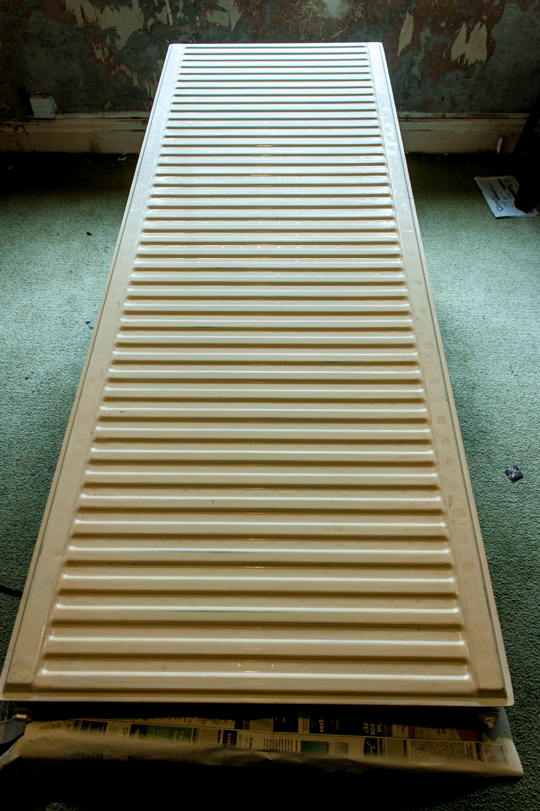

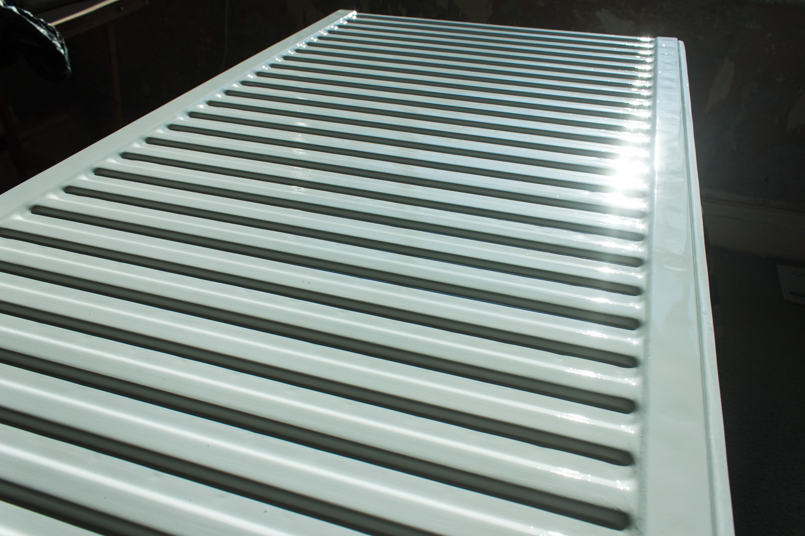

I have however been spraying radiators recently.....while a smelly faff, the finish is far superior to any brush finish my skills could achieve.
I just used spray paint from wilcos. Good stuff.
before, post sand
after (post primer and gloss white spray)
