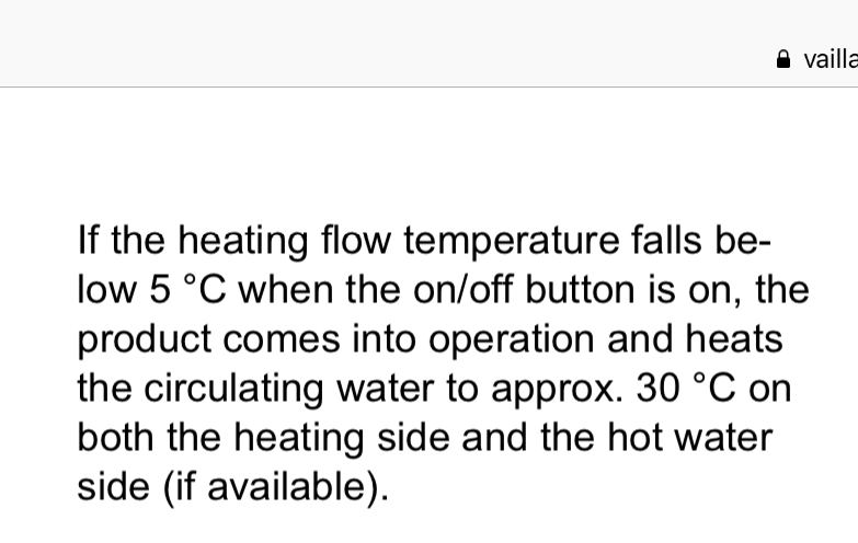

Hi, I had a Valiant ecofit pure conv 418 boiler installed by the gas board in August, since then the pump has been coming on at various time through the night, I got the installer out and was told its the frost thermostat (the boiler is in the garage) and when it comes on it wakes me up as the tank cupboard is next to the bedroom and I can hear it operating the diverter valve and a filter. Valiant website says the frost thermostat kicks in at 12 degrees and operates until it reaches 15 degrees, this can take up to 30 minutes, this seems a bit high to me and I was wondering if it should be set at a lower temp, any help would be appreciated as I need a good nights sleep. Thanks

5.5.3 Frost protection The appliance has a built in frost protection device that protects the boiler from freezing. With the gas and electric supplies ON and irrespective of any room thermostat setting, the frost protection device will operate the pump when the temperature of the boiler water falls below 12 °C. A timer is used so that the temperature can be checked periodically. After 10 minutes the pump will be stopped if the temperature is higher than 10 °C or has already reached 35 °C. The burner will activate if the boiler temperature does not reach 10 °C after 30 minutes or at any time if the temperature drops to 5 °C. The burner will switch off when the temperature reaches 35 °C.

Assuming the linked manual is correct, then it states 5 degrees? Are you sure it’s open vented as they don’t have diverter valves.

Thanks for the reply, the diverter valve is in the cupboard with the hot water tank along with a particle filter we had fitted when we had the old boiler, I think I have narrowed it down to the pump coming on and activating the diverter and filter which I can hear humming as the cupboard is next to the bedroom.
