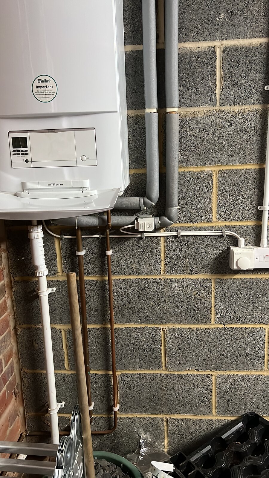

Hi, hoping someone can help me me make sense of this:
We have the Honeywell frost protection kit connected to our boiler in the garage. I noticed that when the frost stat kicked in, the boiler was just staying on. Went out to look, frost stat was set to 5 and the pipe state set to 10, when I adjusted the pipe stat up to 25 it turned the boiler off - which made no sense to me?
But the same thing has happened again now, frost stat has kicked in, boiler has now been on for over an hour. What could be the issue?

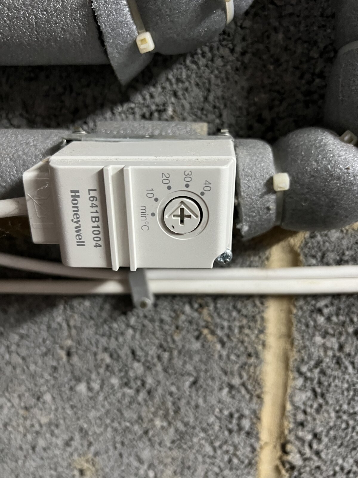

When I went out earlier, I moved that pipestat from 10 to 25, it clicked and boiler went off. Later on noticed boiler was running for ages again, this time moved pipestat from 25 to 30 and again it clicked and turned the boiler off.
Strange one, maybe as CBW suggested, the 24V link may have been left in, kin hich case the boiler would just cut in/out on its own boiler stat but why would the pipestat override this then.
Does the pipestat have a adjustable hysteresis, maybe post the make/model, but still doesnt make much sense to me, maybe wired wrongly?
That’s the model, haven’t got a picture of the wiring at the moment, but back to front wiring could make sense as it’s working in reverse to what it should

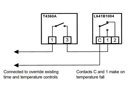

The diagram shown
seems wrong but not what one first thinks. On reading the instructions it seems the pipe stat is not to switch boiler on, but in fact it is to turn boiler off.
The idea is boiler only heats the pipes just enough in cold weather, once pipes are warm they are not going to freeze, so boiler turns off what ever the room temperature is.
If I have miss under stood likely others could also get it wrong, so wall thermostat turns it on, pipe thermostat turns it off.
@ericmark is correct.
The froststat should be located in the area where pipes are judged to be at risk of freezing and set to around 5 degrees C. The froststat turns the heating on when the ambient temperature falls to 5 degrees C in the at risk area.
The pipestat is on the return pipe to the boiler and usually set to around 15 to 20 degrees C. When the return water going back to the boiler reaches this, the boiler is turned off. This prevents the radiators getting too hot as it's designed for frost protection only.
When the heating is in operation, the return pipe will be over 15 to 20C so the pipestat will be switched off allowing the normal heating controls to operate the system.
I suspect from your description of the pipestat operating in reverse that the use of terminals 1 and 2 are transposed.

I take it that the Honeywell wiring diagram is correct??

For a start, just check that wires are connected in to C & 1 above in the pipestat, post #8.

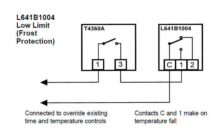

@am_diy The Honeywell diagram looks correct. So, if there is a wire in terminal 2 move it to terminal 1. Only you can determine if you can do it safely.
When the pipestat is above its set temperature, it is in the position shown and the circuit is open
When the pipestat is below its set temperature it moves so that C and 1 are electrically connected and the circuit is complete. [Assuming that the froststat is also 'on']
