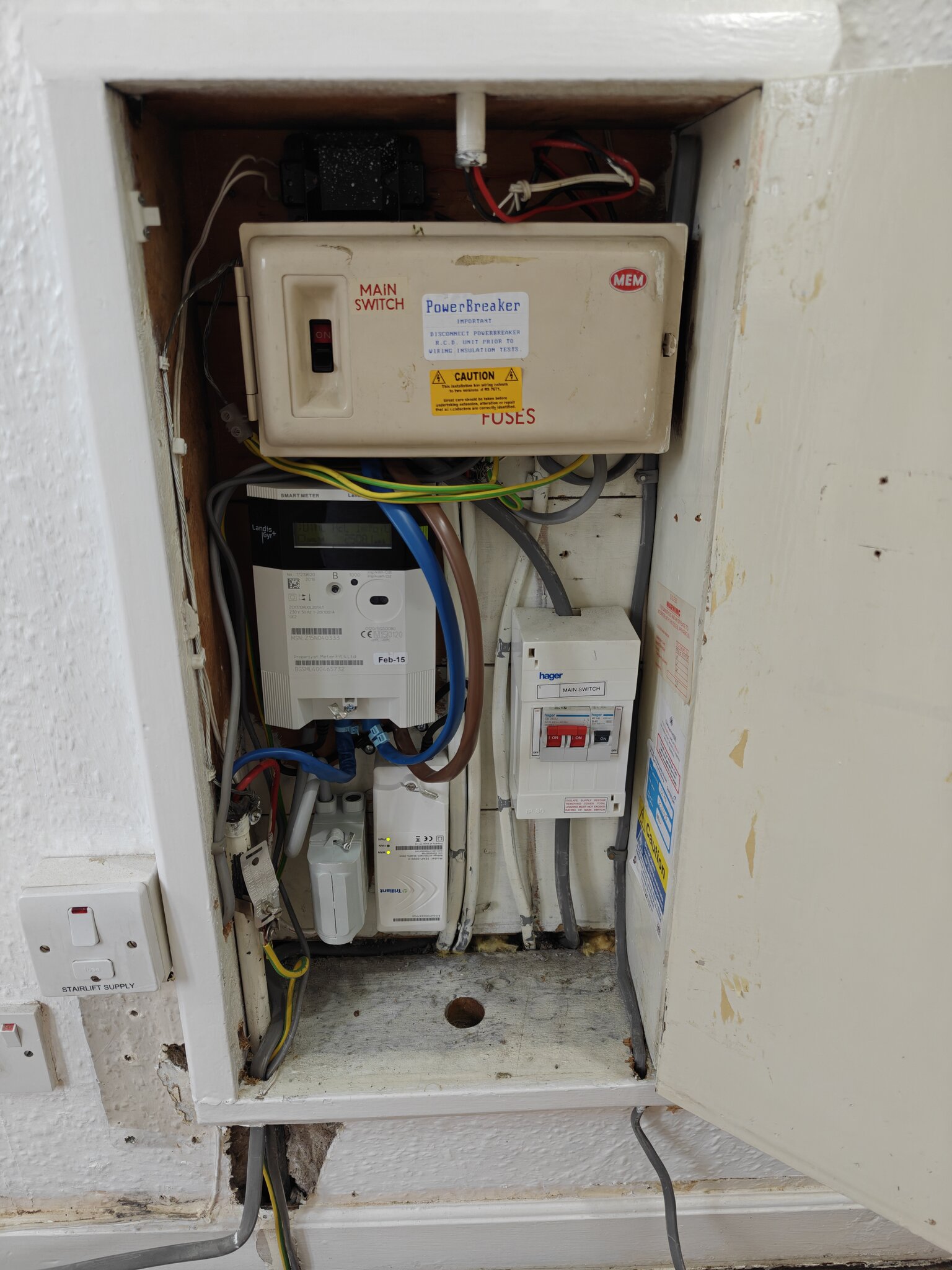

Full Rewire Cost Saving?
No tests have been done.
Not a good sign.
All just looked at it and said rewire.
Not an indicator of a responsible professional.
From what I've read online cables should be replaced every 30 years
Don't believe everything you read online.
The guys running the new supply cable found a loose earth wire today.
Fixed by tightening the terminal, not replacing the cable.
I've just moved into the house a few months ago and I've redecorating the whole place, so if a rewire is due soon then now would be the best time since the place is a building site anyway
Understandable.
Pay an electrician to produce a proper inspection report. Make it clear to him that he will not be invited to carry out any work he recommends. Post scans of his report pages here.
Not in full agreement with you on that one I`m afraid.
A pro would look at it first (A lot of I & T first procedure starts with use of the most importand of tools - the Mark One Eyeball) not always conclusive in itself and some degree of further inspection (slacken or removing things to take a further peep) before even involving test gear.
But often, part way thru the I & T procedure you have enough evidence to conclude "yes it really needs a full rewire" being the most prudent answer.
Is it fair to go right thru the whole EICR/Periodic and charge full cost if it if the outcome is 99.99% certain of a total flop?
also bearing in mind if you intend to keep some half decent parts of the installtion then costs of doing so properly can approach or exceed the "rip it out and start from scratch approach" of course one also has to beware of the rogue traders that are in every trade and they can certainly spin either way!
If the op plans to stay put in the property, a professional rewire is an asset.
Also looking at those accessories it would be a good time to add more sockets, create more circuits etc
If you are living there while it’s done DO NOT underestimate the mess and aggrivation and upheaval the rewire will make
Plus of course all the making good

In better news, the new supply is in so getting somewhere
