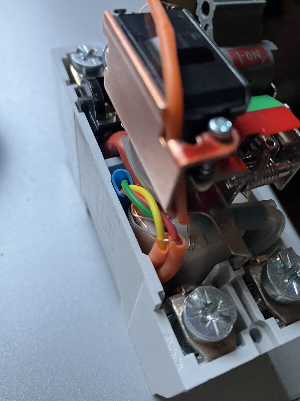

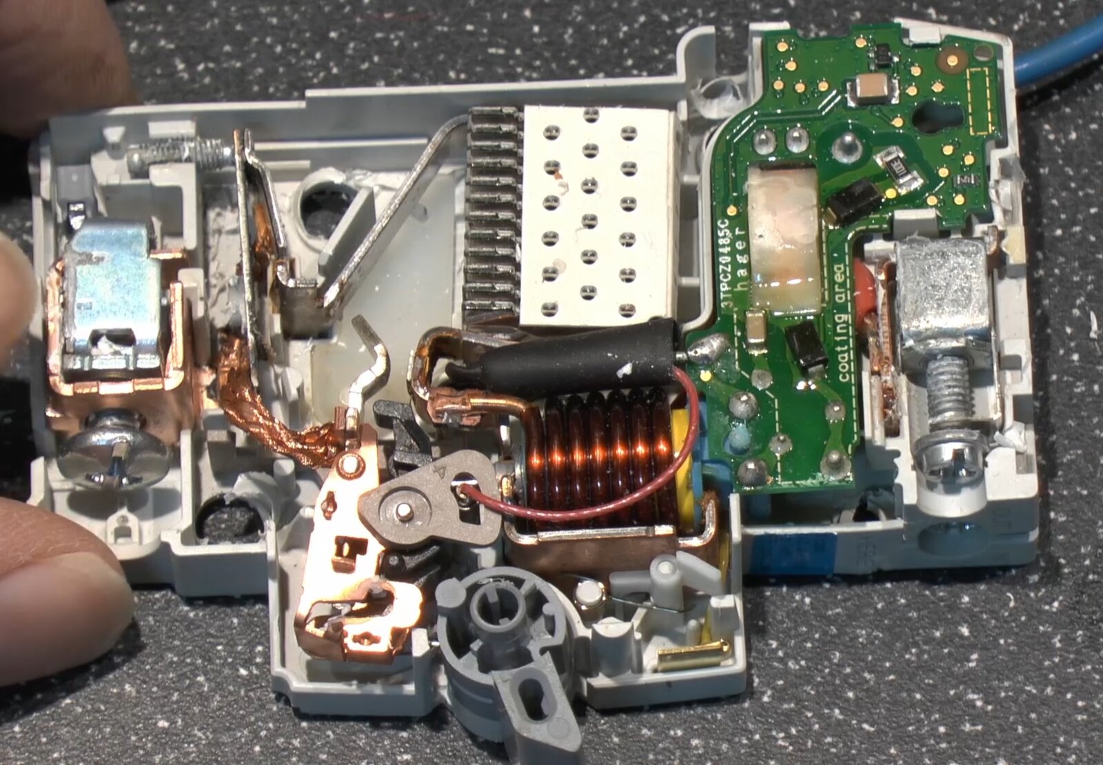

I’ve just opened a wylex RCD 80A? Type A
Just seams to have a toroid and test resistor from what I can see

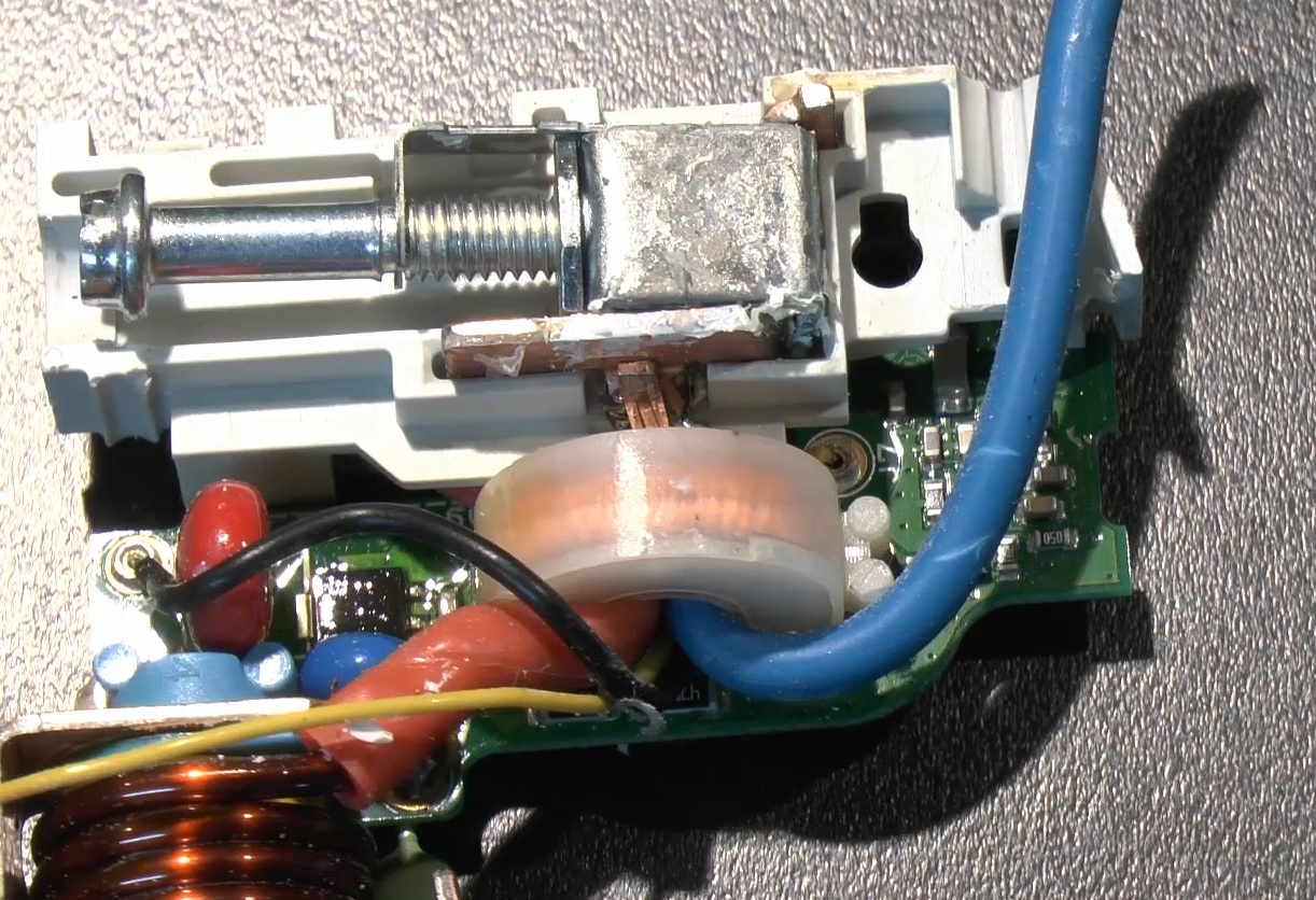

I’ve just opened a wylex RCD 80A? Type A .... Just seams to have a toroid and test resistor from what I can see
This is the contents of one which 'blew up' due to an L-N short (hence all the soot). It's a Type AC installed around 2001/2,and the PCB with the electronics can be just about seen through the soot! ...
Humm.
terminals look different.
Live power wire seams to be red on mine
Maybe I’ll dig a little deeper sometime

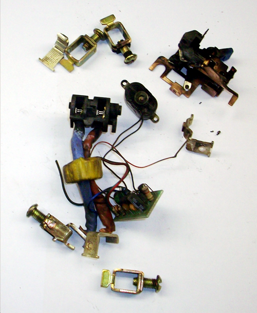

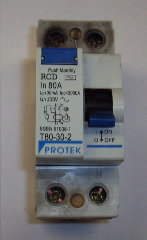

Humm. terminals look different. Live power wire seams to be red on mine ... Maybe I’ll dig a little deeper sometime
I presume that those 'wires' count as 'flex', so should have been brown/blue (as in mine) long befoore 2000. This is what it was (not the world's most reputable brand!) ...
