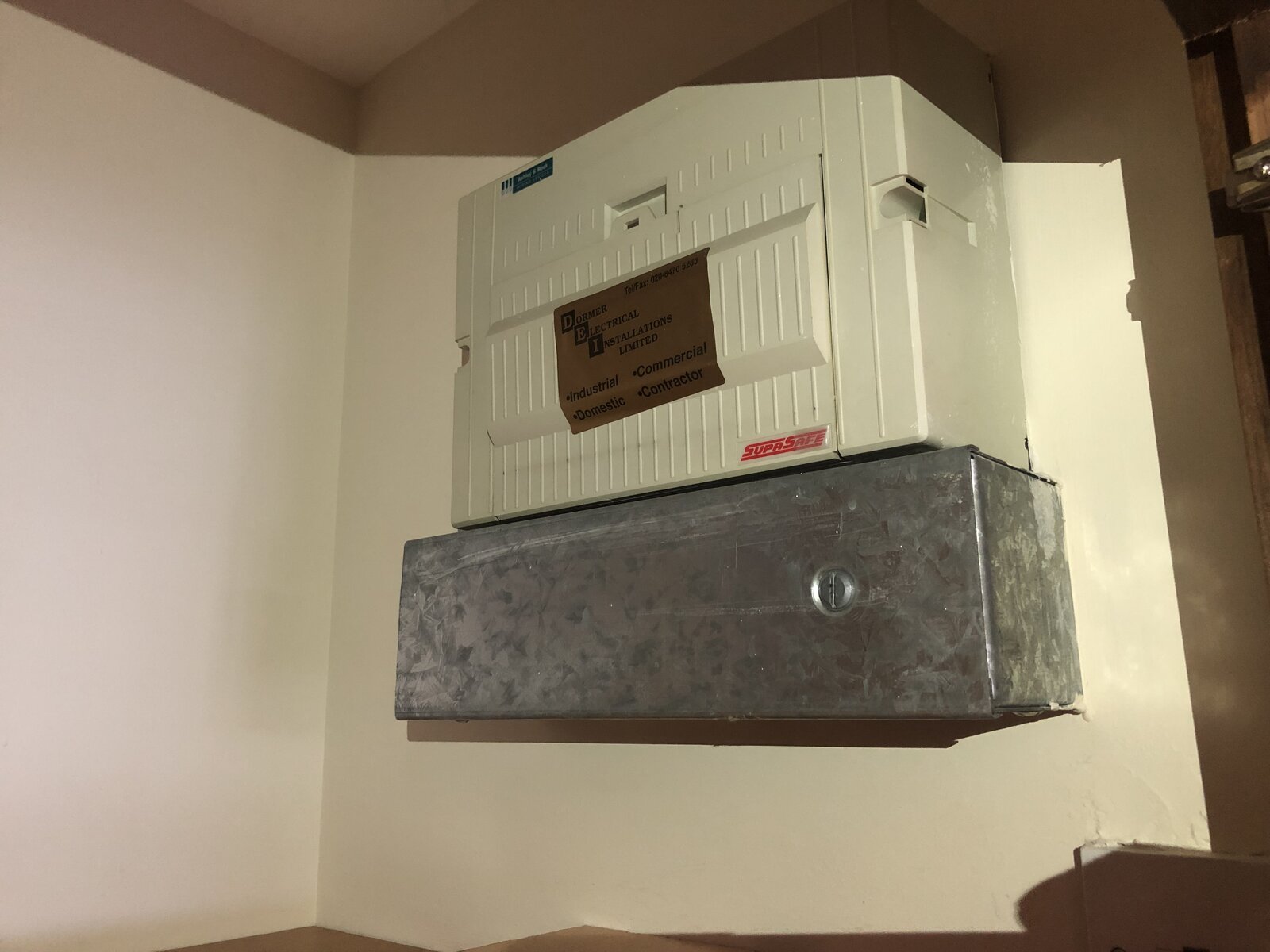

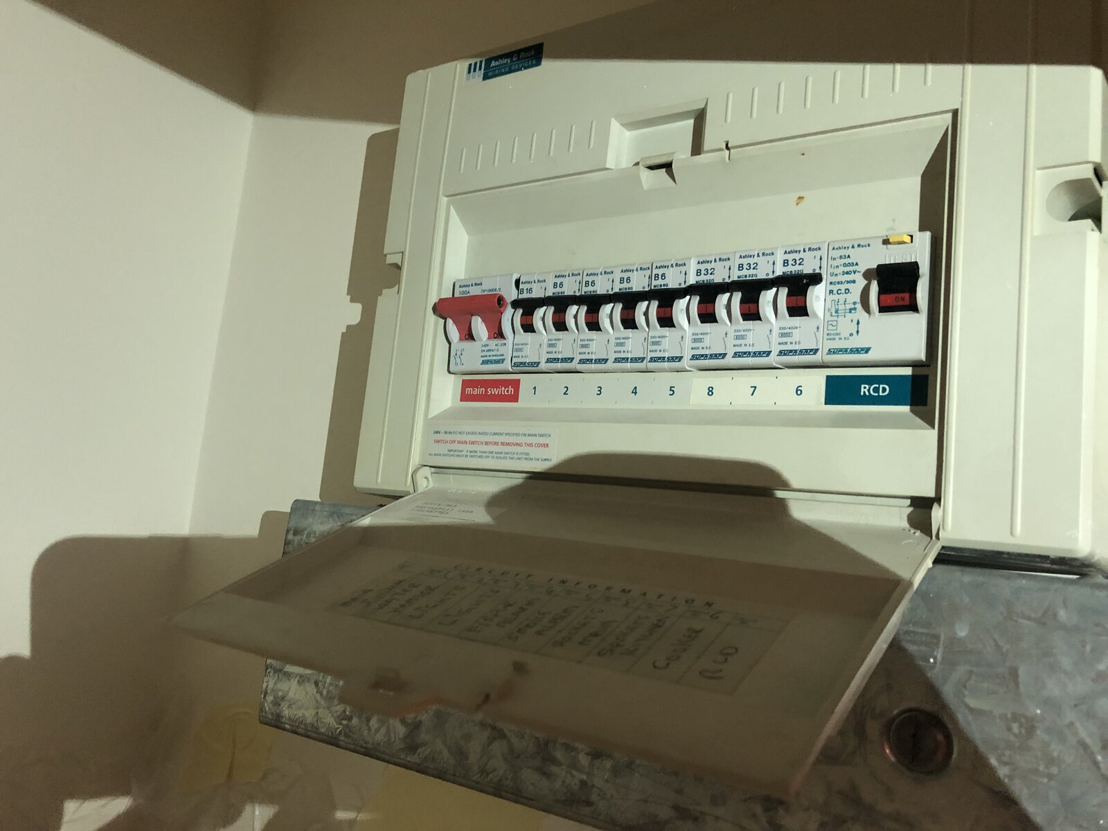

Hi All,
I attached pictures of the fuse board from our 2 bedroom flat.
How would an EICR assess this? What category would be assigned to it?
The fuse board is working well, we have not had any issues with it.
Thanks!

The EICR will test the wiring too.
Whether the fuseboard will pass the EICR or not, the entire installation, including wires and accessories will be tested, some may show a bad result and some may be okay.
Not testing the wiring before changing the consumer unit can end up in problems.
No one can be sure without testing it physically but as above, have a look at the link Pete has sent.
It's not ideal to have every circuit protected by One RCD if this is the case here, the board looks plastic but when it was installed probably completely compliant. Looks like the installers have taken good care from the labelling etc...
According to the "best practice guide 4"
Plastic cased CU -C3 if it's under a wooden staircase or on an exit route. no code otherwise
Circuits without RCD protection - C2 or C3 Depending on what exactly the circuits are for. The lack of labelling makes this hard to judge, but I think you have most if not all your sockets on the RCD and so will probablly come down on the C3 side.
Absense of circuit identification labelling - C3
This of course only covers what can be seen in the picture. Also there is nothing compelling electricans to follow said best practice guide.
The labelling is on the open flap
Apart from that a sensible summary in the absence of more information

.... the code 4 was does not comply with current addition as a new installation, and it was said that was unhelpful, as nearly every edition says from what date designs must follow that edition, so if designed before that date, then it complies. The current edition says so.
Not really. It says that things which were compliant with earlier editions (but not the current one) are "not necessarily unsafe" - but that's very different from 'compliant' (with anything).
In any event, in the context of this thread, as I understand it EICRs are conducted on the basis of the edition of BS7671 current at the time of the inspection - so things which were compliant with earlier editions, but not the current one, might (or might not, at the discretion of the inspector) be 'coded'.
But code C2 does not mean does not comply, so as you say, up to the whim of the inspector.
True - but my point was that (seemingly contrary to what you were saying/implying) if something in non-compliant with the edition which is current at the time of the inspection, the inspector may (athis/her discretion) code it as C2 (or any other code) if he/she feels it warrants that code, even if it were fully compliant with some earlier edition of BS7671.
