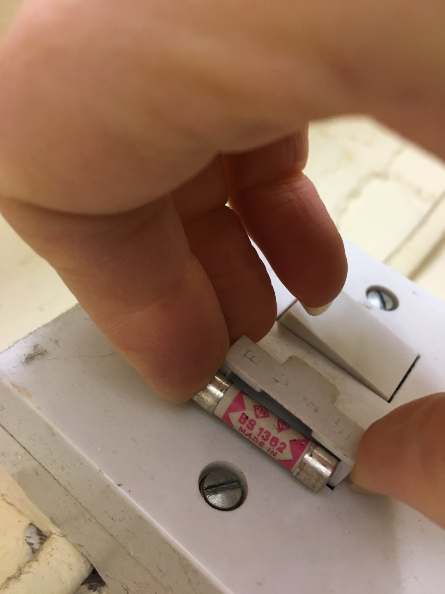

hi fuse had blown in spur feeding boiler. Removed it and went to fit new one - won't fit in! Is there a technique to this? It's exactly the same size as the fuse I removed which just pinged out! There's a small lip at top and bottom which means it won't just pop in. Middle bit isn't wide enough to put it down n and then slide up. Am I missing something - doh!
And if you do finally get it in the slot, did you try from the right side.
Switch it off before pushing back in
Depends on make of unit, Pull the holder out to its limit, then slide in the fuse through the gap on the edge rather than the front. put the switch to off first.
Any idea why? You may struggle to fit fit a new one to find it blows again.
Of course it may be that a 3 amp fuse should not have been fitted in the first place, so fitting another would be silly. I'm sure the cable feeding the boiler (which is all the fuse is supposed to protect) is not so thin a 3 amp fuse is required. The boiler, of course, will have its own internal protection.
EFLI is spot on. Those FCUs have a fuse drawer where you need to pull it out further in order to fit the fuse - the first bit you see when you pull it out is not where the fuse sits.
As for the size of the fuse, isn't it stipulated in the gas regs that all gas appliances must be supplied via a fuse no bigger than 3A?
