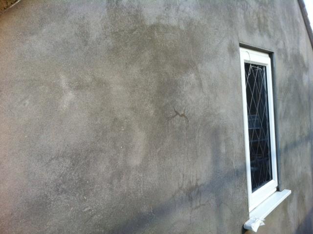

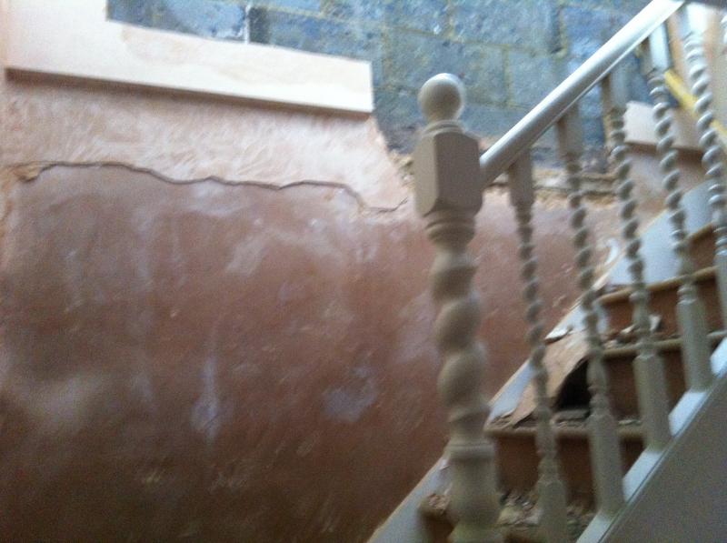

Hi all,
I had my gable end rendered a couple of years ago but we got cracks and it hollowed out and we had water penetration.
I hacked it off and had it rendered again just before Christmas and it was mild.
Within a couple of weeks we had water penetration again.
I have tapped all round the render and no hollows.

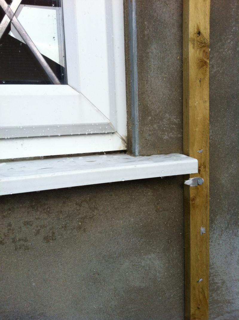

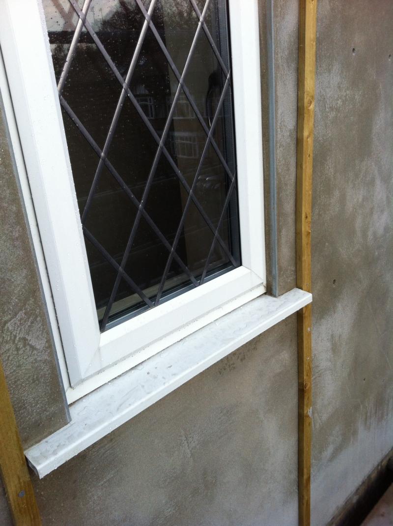

I believe now that it could have been the window causing the problem by not being masticked?
The water comes in where the 210mm celcon blockwork meets original brickwork.
I have attached photos, any advice would be much appreciated.

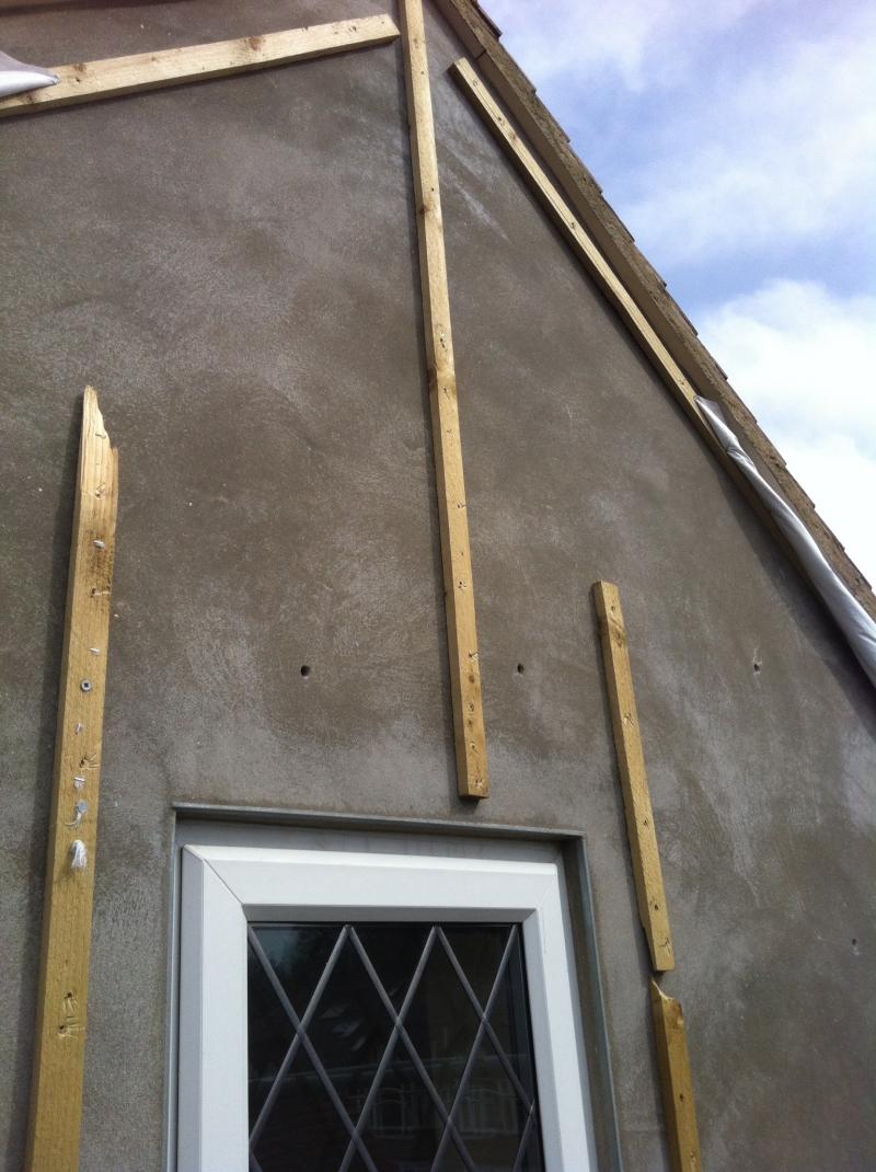

It is difficult to see much from your photos.
You need the photos the correct way up.
Is the celcon block wall single skin?Where are the blocks in relation
to the window on the gable-end ?

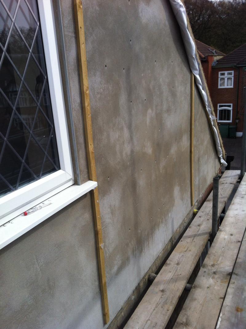

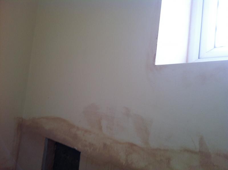

I had the gable re-rendered in December as it was mild because water had been coming through previous cracked render. first coat was put on and second coat the following day. 2 days later it rained an we had all that bad weather and before long water was appearing on the inside in the same places as before at the point where block meets existing brick, below but to the left and right of the gable window.
There are 2 or 3 very small places where the render appears hollow but it seems hollow all along the bottom where it has gone light grey. The rest of the render is patchy and darker.
There has been one suggestion to me that water could be backing up and in behind beading although I am still of the belief that it is window or failed render?
The gable window sits to the front of the block work. On the original cracked render I had some damp appear on the cheeks inside the window.
I had the inside of the blocks done in sand and cement but as you can see, I have taken it off on the inside where I have taken off insulation to allow blocks to breathe and dry out.

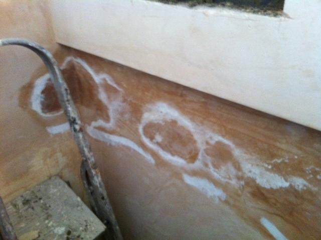

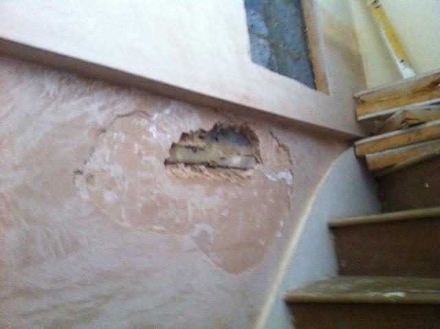

Hi, I have just cut out more insulation and taken off the render inside.
Then I decided to take off some skim layers below the block work/beading level and uncovered all this damp in picture.
Could it be beading or just water penetrating existing brickwork or just trapped damp that had come down from block work?
Looks like your outside needs sorting out properly, back to basics. From top down where can the water be getting in?
It looks like inside needs all coming off with proper waterproof render to keep salts back, and outside needs loose removing before assessing again.

Just had builder come and look and they seem to think its the beading as it is only 1/2 course below the blocks, has no drip and should be bell cast beading. They have suggested take off the bottom 15-18 inches of render and put a damp proof strip along the line where block meets existing and take the render down another course to finish off with bell cast beading?
Does this make sense?
