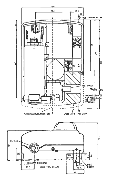

You need to disconnect the mains water pipe from the shower.
where the water pipe joins the white plastic tube of the solenoid coil.
isolate mains water, remove pipe connection and you'll see the gauze filter
inside the tube.
I can't seem to find the filter - can you tell me where it will be?
It's located in the end of the inlet sigot. Bottom R H corner.
you need to isolate the water supply and remove the supply pipe to gain access.
