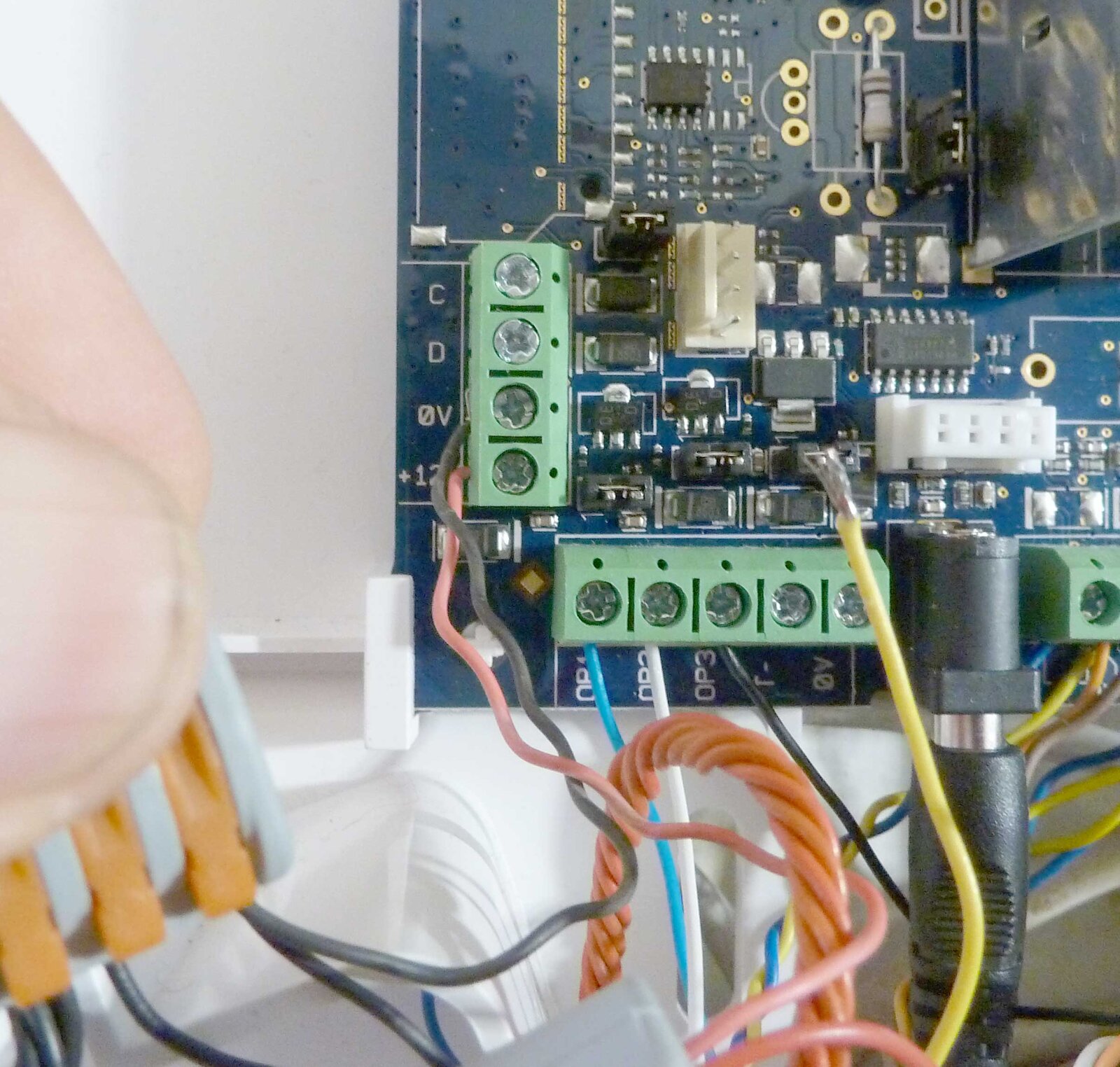

With all wires disconnected from the output connections on the panel, Voltage between the Tamper and 0v on the output side of the panel is reading 13v .
Voltage between the Tamper and all of the +12v terminals is zero.

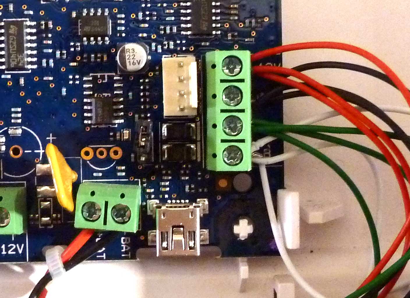

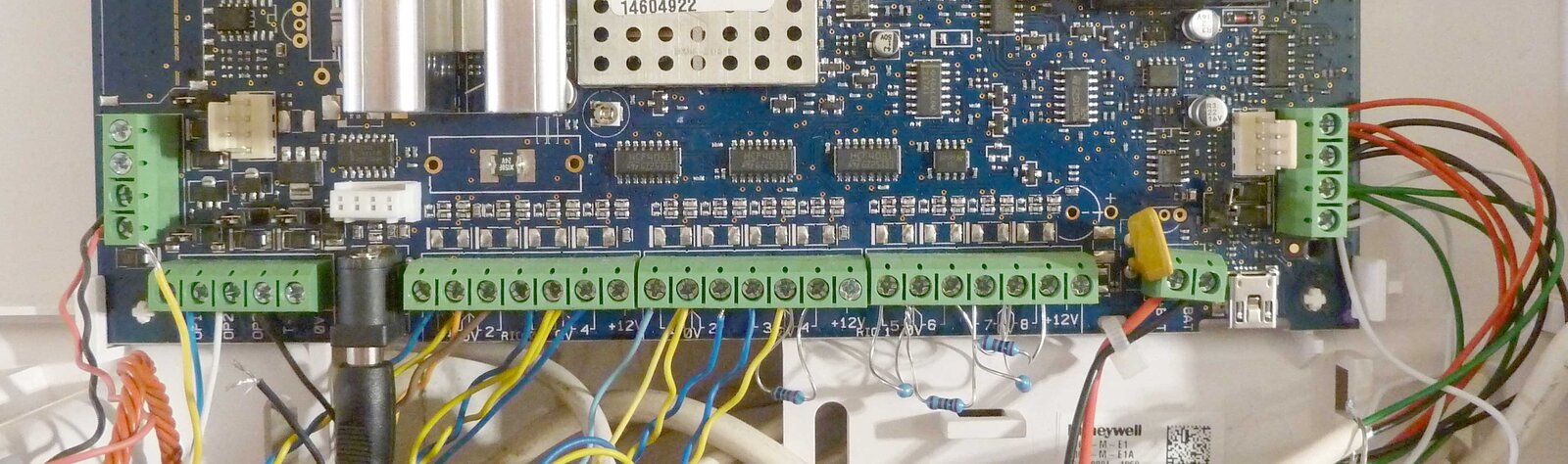

Pics of the wiring are shown. I've connected +12v cables and 0v cables in terminator blocks, to save fiddling with the screw terminals.
The output side temper and 0v connections were removed when I took the photos so I could test the voltage.

Just rechecking the voltage- what I reported a few minutes ago is correct. there is 13V vetween the Tamper and 0v on the output block, with no wires connected to these terminals on the panel.
Also, just to add that I picked up the 12V power (joined via the connector blocks) for all peripherals from the +12v and 0v terminals on the left side block (intellibus).

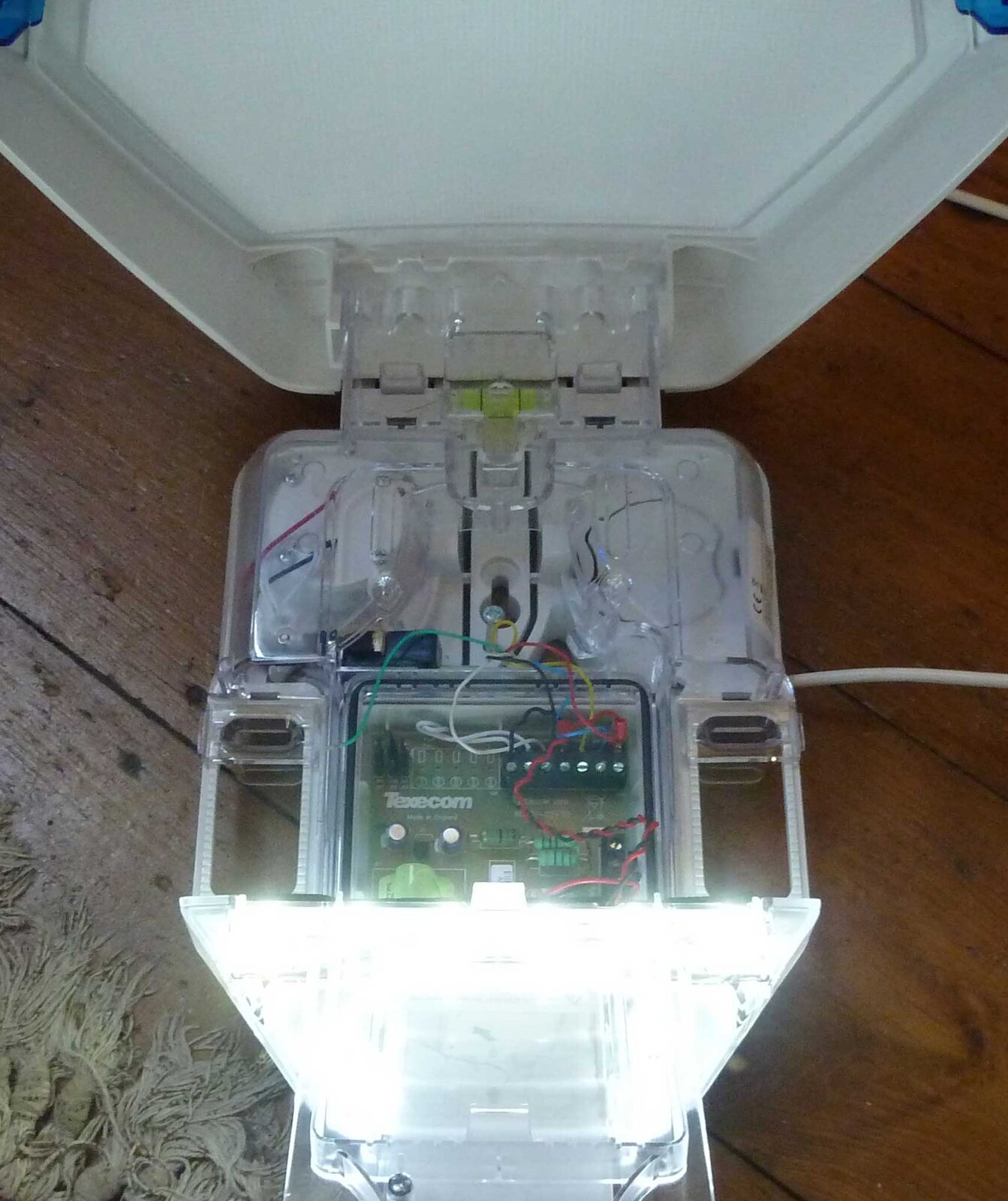

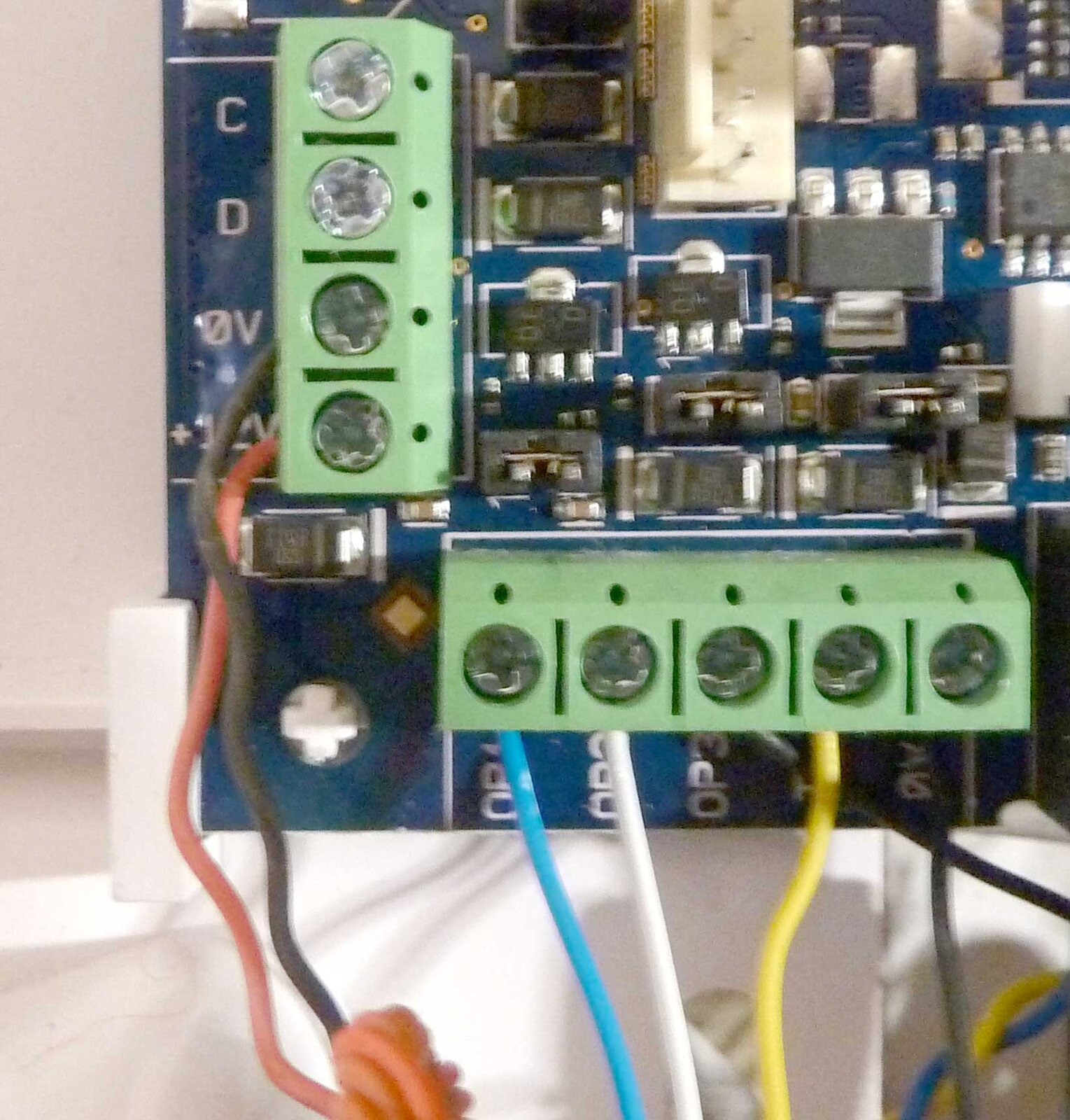

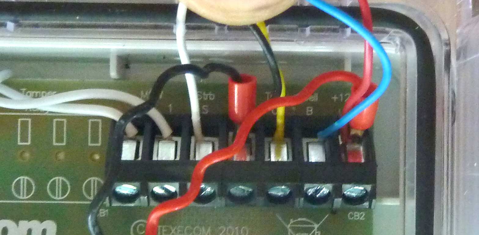

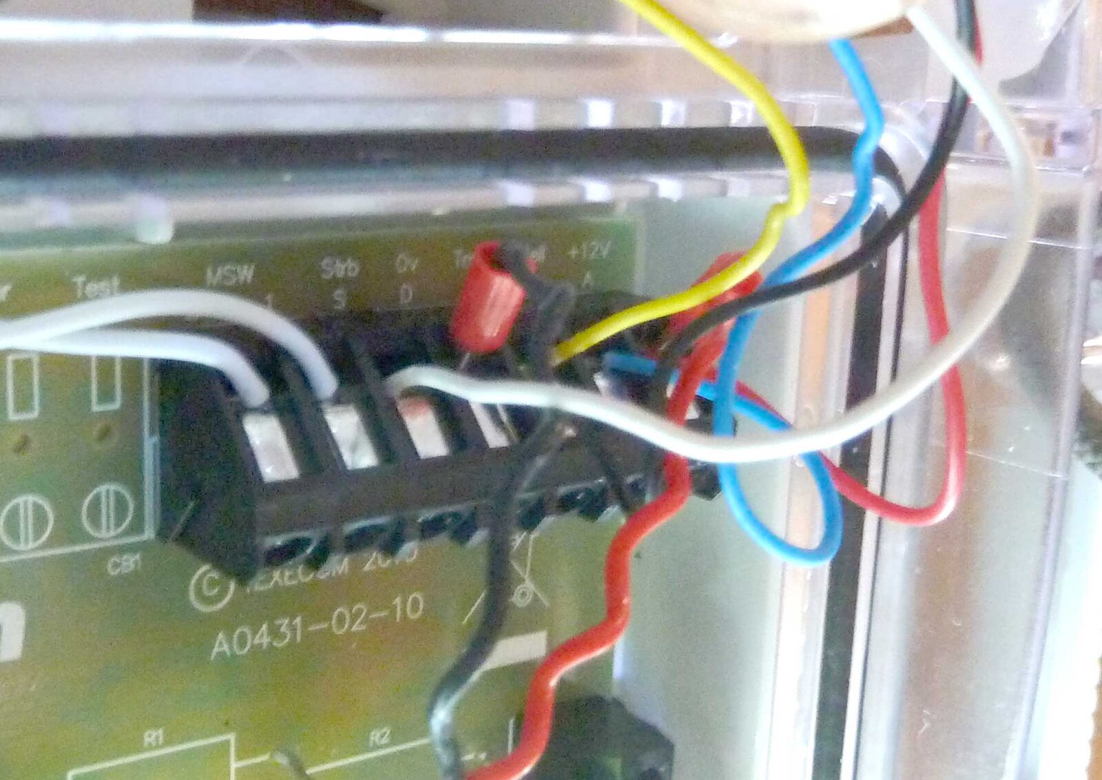

Thanks. Before I add a wire link, checking the wiring between panel and bellbox sounds like a good idea (if it was wrong, it would also explain why the output test is not activating siren or strobe). The connections seemed straightforward- but that doesn't necessarily mean I've got it right..
I've wired Bell (on the bellbox side) to Output 1 (panel)- in blue on the attached photos
Strobe (bellbox side) to Output 2 (in white)
Tamper to T (yellow)
12V to 12v (red)
0v to 0v (black)
I have not looked at any other connections on the bellbox, nor the jumpers etc.
I left in place the red and black curled wires with red end covers which were connected to the bellbox connection block at the factory.
Output 3 on the panel is connected to the 0V (black) horn wire.
It's worth adding that I first encountered the AUX TAMPER error message yesterday when I connected the old bellbox up. Before resetting the panel this am, I connected up the new bellbox (Texecomm Odessey) instead of the old.

The wiring looks fine. If you are testing on the floor, you will need to insert some material under the tamper switch to close it. You will hear it click when closed. Normally, it would need to be fitted on the wall with the lid screwed closed to close the switch.
Many thanks Galaxy Guy- your note on the tamper switch helped me to sort out the problem.
