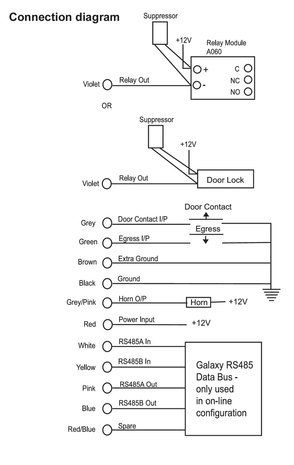

Hi,
Does anyone know how to wire on a second max reader so I have read in read out?
So I currently have a max 4 reader (nc) wired on the data line and my mag/pte connected onto the keypad. But the customer is now asking for a read out to replace the PTE. How can I add a 2nd reader so both release the door?
Diagram attached if anyone could guide me please
